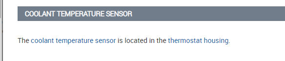

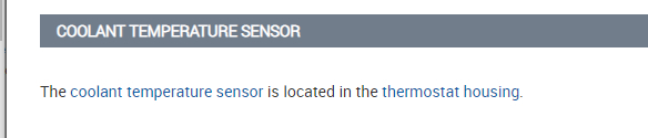

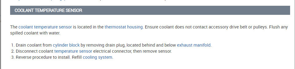

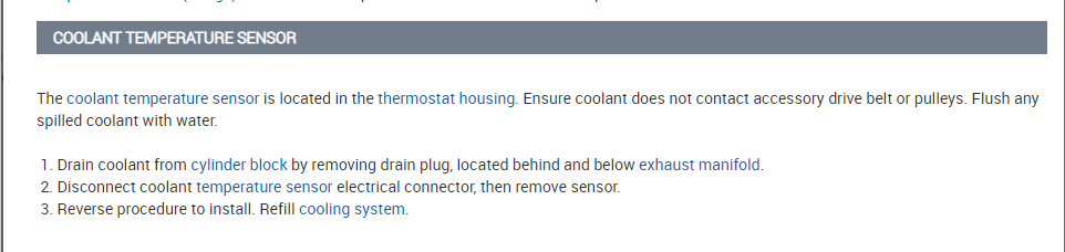

I attached the info below as I suspect this is a sensor issue. Please let us know if you have other questions and what you find. Thanks
