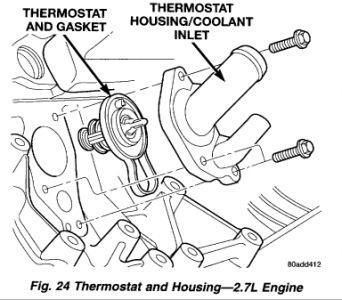

JOEYB5639
thermostat location 2000 intrepid 2.7L
Jan 5, 2020 at 1:26 PM (Merged)
  • CAR REPAIR CONTRIBUTOR
  • 75,992 POSTS
There you go its located on the left side of the engine-see below
https://images.2carpros.com/forum/automotive_pictures/12900_thermostat_27_1.jpg

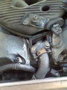

THEJERM
I have had a slight leak in my cooling system coming from whatever this picture is of. I thought it was the thermostat housing, I bought a new thermostat, went to unbolt this and tried loosening the bleed valve. Well, when applying torque to this bleed valve, the cover popped off. There is no fasteners, so, do I just "JB Weld" it back in place or do I need to buy a replacement (and if so... what is "it" called?) And, since this doesn't house the thermostat... where do I find it?
https://images.2carpros.com/forum/automotive_pictures/392196_0804092007_1.jpg
  • 75,992 POSTS
The thermostat is located on the lower drivers side of the block below the alternator. Its a pain to get at

THEJERM
rasmataz,
Thank you for directing me to the thermostat. Any chance you could tell me what it was that I broke (in the picture) or, if I can just use JB Weld (or some other form of epoxy) to stick that cover back on?
Thank you

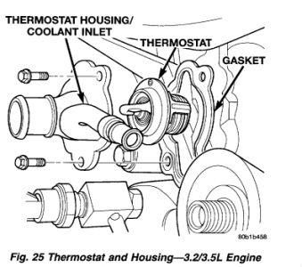

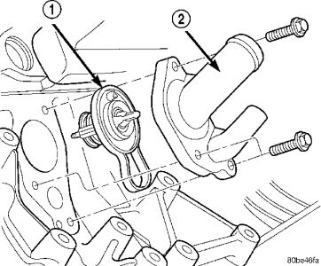

  • 75,992 POSTS
Here's a thermostat location for a 2.7L and 3.2L engine:
https://images.2carpros.com/forum/automotive_pictures/12900_27t_1.jpg
https://images.2carpros.com/forum/automotive_pictures/12900_32t_1.jpg

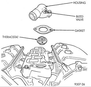

I have a 1998 dodge intrepid ES 3.2 and I need to know where the thermostat is located. Could u help me out with a diagram or something...thanks
  • 75,992 POSTS
https://images.2carpros.com/forum/automotive_pictures/12900_t_4.jpg
The engine thermostat is located in a water box, formed in the front of the lower intake manifold. This thermostat has an air bleed located in the thermostat flange. https://www.2carpros.com/kpages/auto_repair_manuals_alldata.htm
