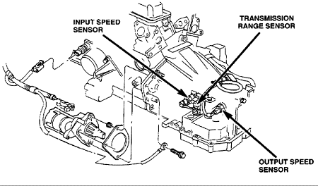

Thank you for the previous answer. It poses a couple new questions from me though. I still don't know where the Tansmission Relay AKA Transmission Spark Relay (Auto Zone part # M-76) is located. 1. Do I replace the connectors @ TCM and Solenoid Input, or is it something I bend into shape to look like 0? 2. How do I test the harness w/ OHM meter & what reading am I looking for? I have never used an OHM meter. I think I have one but I have no instructions & no idea how to test OHMs with it. I am not even sure if it works. 3.
https://images.2carpros.com/forum/automotive_pictures/270360_130914238scew_1.gif
I was 90% certain the Solenoid was inside the trans Case on the left/driver side below the Range Sensor & Output Sensor. Am I wrong?

Solenoid is on the right side (passenger side )
open the hood and try to located by looking under the firewall passenger side
you need to use an ohm meter to check if you have a short in one of the wiring
(( I just went through the whole thing about two weeks on the same car ))
did u get the TCM codes ?
let me try and find the wiring diagram and will send it
