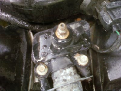

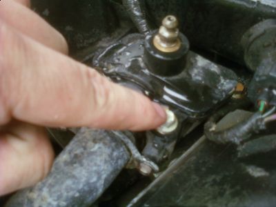

I just had a similar issue with my intrepid, the problem was that the glue that seals the 'upper coolant housing' came loose and was spraying coolant all over the place, which would cause the smoke and the burning smell, also would explain any stalls you might have been having because there's a sensor that wont allow your vehicle to start without coolant in the system. The part is roughly $100 and is a bit of a pain to replace. I'm including a photo of the part, start your vehicle and check this part to see if you see any leakage, even if its just the slightest amount its probably your issue.
