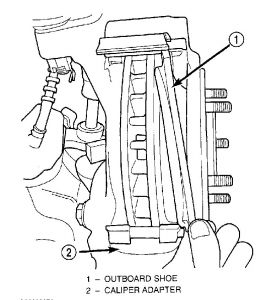

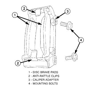

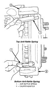

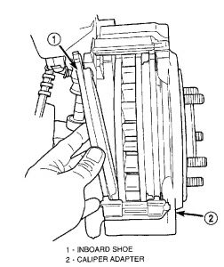

I got the rotors off, now I am having trouble figuring out how to remove the old pads, and then install the new pads. Please help.
Jul 5, 2008 at 11:40 AM
SERVICE WRITER
  • 9,123 POSTS
You may need to tap them out of the bracket with a hammer.

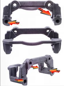

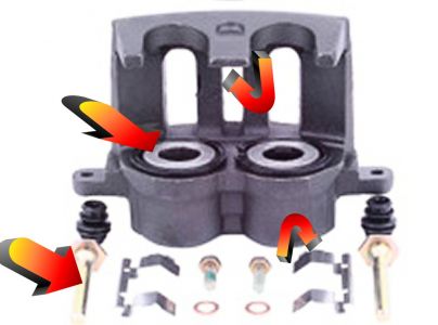

I aso suggest to look at this: https://www.2carpros.com/how_to/how_to_replace_brakes.htm And meticulously clean all contact points on both side of the clips and the brackets. Lube them well at these points. This is a different style caliper, but you get the idea.
