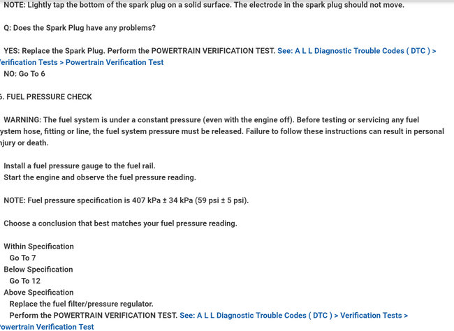

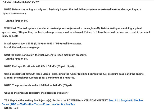

take to a garage that can freeze frame and read the sensors, seems like where you took it they did not know what they were doing. also check fuel pressure with a gauge auto parts rent it. then look for a vacuum leak. this can be anything from a basic ignition problem to some thing more serious which seems to have been eliminated. also do a compression check the engine should have never come out to begin with especially since you still have the problem. check plug wire and coil for resistance as well. from what you have written it almost sounds like a home garage where the person wasn't really qualified on what to do.

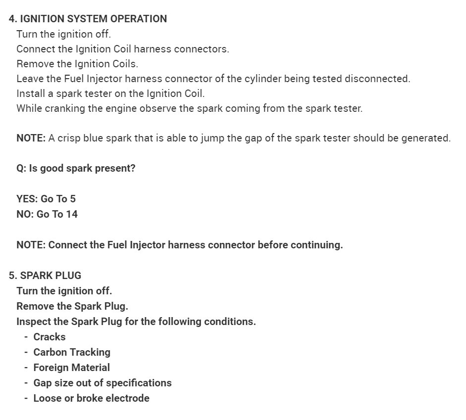

SCGRANTURISMO
  • 4,897 POSTS

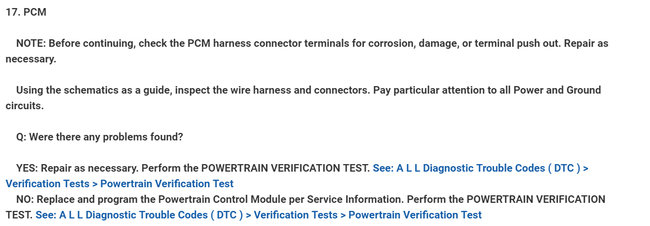

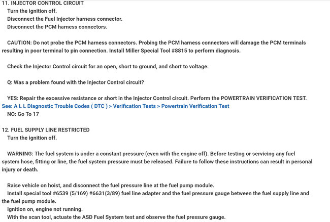

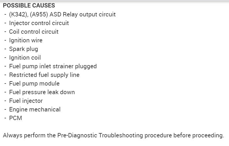

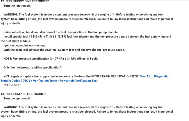

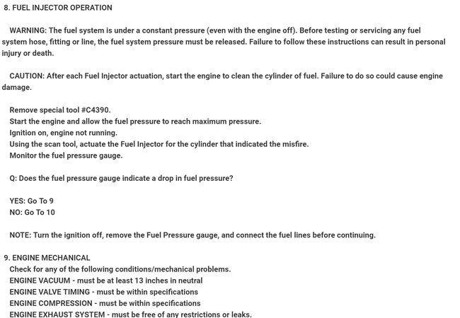

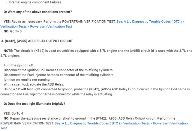

It very well could have been water getting down into your spark plugs and causing your vehicle misfires. I have included in the diagrams below a troubleshooting flowchart for P0300, which is a generic DTC for random misfires, But it will apply to each cylinder individually as well. Please go through it and let us know what you find out.

Remove the injector and rail and check for dirt
very common

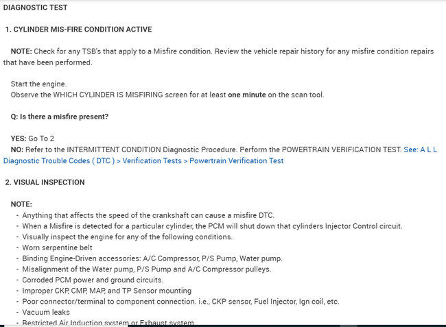

1 3 5 7 cylinder are mis firing. my check engine light came on and this is what message it was. now i have done a full tune up new plugs, wires, and cap. when i took out the plugs in the right side they where all black and every once inawhile i will get a cloud of black smoke to come out. what else can i do. could it be a egr vlv.
Oct 7, 2020 at 11:18 AM (Merged)
  • 75,992 POSTS
Misfires can be caused by worn or fouled spark plugs, a weak spark (weak coil, bad spark plug wire), loss of compression, vacuum leaks, anything that causes an unusually lean fuel mixture (lean misfire), an EGR valve that is stuck open, dirty fuel injectors, low fuel pressure, or even bad fuel.

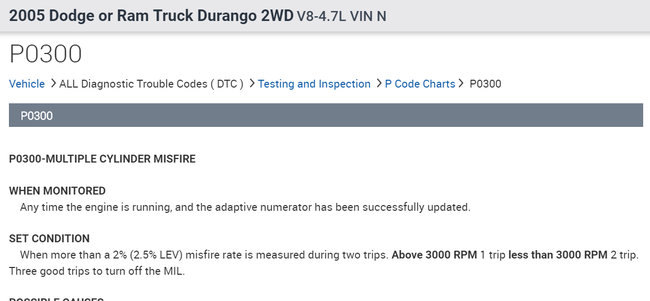

My truck was acting as if I was running out of gas. I have had no engine lights on, but at a light, I would have to put it in neutral and give it gas because I was afraid it would die. My friend took a look at it and around 4000rpms, you could hear a hard rattle. He changed all the spark plugs (Champion) today and after he started it back up, immediately, the check engine light started to flash and my friend said it was still missing and to kill it. He thought maybe a wire was crossed. He crossed them and it backfired and he put them back. Codes P0300, P0306, P308 came on and won't clear. Please help, I'm a single Mom with limited funds. The only reason my friend offered to help is the local mechanic said it would be $100 to change the spark plugs and then we could go from there. Thanks so much.
Oct 7, 2020 at 11:19 AM (Merged)
  • 75,992 POSTS
Hi ChristiNate, Welcome to 2carpros and Ty for the donation
P0300 random misfires normally caused by vacuum leaks and contaminated fuel
P0306/P0308 -check these cylinders sparkplugs/compression and injector

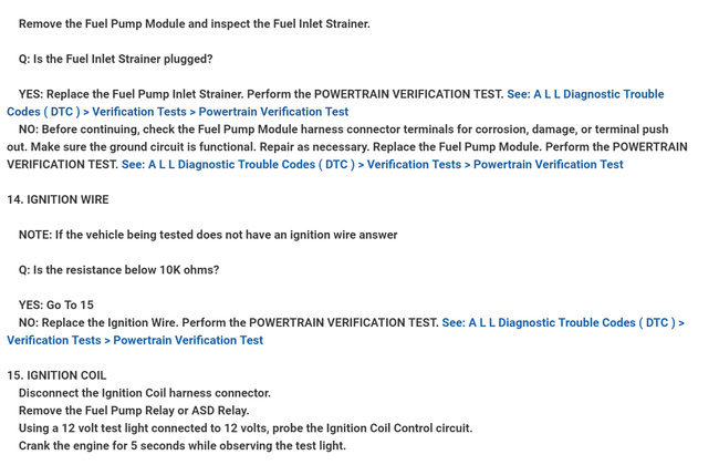

WILL NOT IDLE. EXAUST SMELLS LIKE GAS. Cylinders 1-2-3-4 are not firing. Cylinders 5-6-7-8 work. I switched the coil packs front to back, same thing. No check engine light but it runs like crap.
Oct 7, 2020 at 11:20 AM (Merged)
JCNINJA636
  • 26 POSTS
Did you check and/or switch the spark plugs? and plug wires?
CHRISBACC84
  • 6 POSTS
Head Gaskets are 1 month old as well as the spark plugs. There are no wires, the coil packs connect directly to the spark plugs. When I checked the spark plugs, cylinders 1-4 are wet and smell like gas. Cylinders 5-8 are soot covered.
JCNINJA636
  • 26 POSTS
Perform spark check on coil packs/stick coils and replace all spark plugs.
Possible faulty coils/stick coils on cyl 1-4.
After check post findings for more diag.

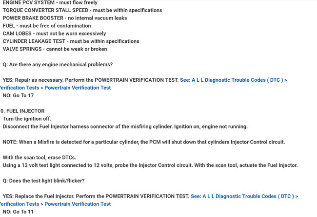

stick coils check out good on all eight cylinders. Is it possible that the PCM is bad? Or maybe injectors 1-4 are stuck open? Also I had a timing chain set installed after the problem started, but there in no change in the way the truck runs.
RIYAD614
  • 21 POSTS
I have a 2002 durango 4.7 with the same exact problem and I did a timming chains on it and new plugs and still missing really bad. did you get yours fixed
JCNINJA636

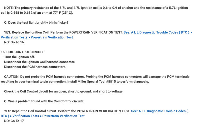

  • 26 POSTS
The pcm does control spark, but it is odd that you'd lose that number of cylinders.
Have you tried putting a scanner on it? I have seen before that a check engine light is not on but there were still codes (either pcm signal to dash is damaged, or engine light is burnt/faulty).
It's been a while since I worked on a hemi, are cyl 1-4 on the driver side?
Also test power to coils with engine cranking.
Unplug all coils and attached battey charger/tender.
Test power to one of each coil connector... attach positive lead of volt meter to coil and negative lead of meter to chassis ground (I can't remember the color of the wire for the power to the coil, so you'll have to test for power to both wires)...test known good coil connector (from cyl that fire 5-8 to know the correct power wire) and then test bad connector (from cyl that do not fire 1-4). You should see a 12-14v power to them.
If power is good then suspect faulty coil/stick coil.
If no power, check fuses throughly (visual and ohm check). If no bad fuses then possible faulty pcm/ecu.
After tests report findings back. (include wire colors tested)
