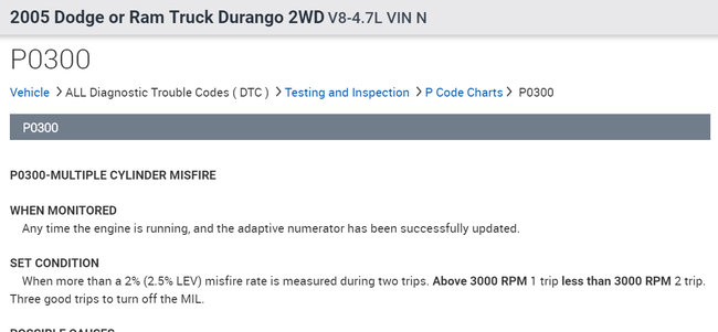

Started with a lost of power and engine rattling shaking. Had the computer read and it stated that it was a Misfire on cylinder seven I took it to the garage and the mechanic said it was some pipe that looked burnt out. I had it replaced but it did not help the problem. next had the engine removed and new seals were put it. all new spark plugs.the pistons and cylinder were inspected and looked fine. fuel injectors were cleaned and all.the engine was put in and the same problem as before. it was running no better.read the computer again and it showed a faulty o2 sensor so replaced all of them, that did not help either .read the computer again and now it reads code P1072. checked the MAF and it seems fine. we are at a lost here any help on where to go next would be great.
Oct 7, 2020 at 4:18 AM (Merged)
HMAC300
  • 48,601 POSTS

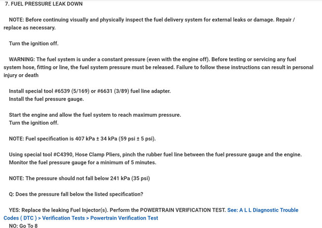

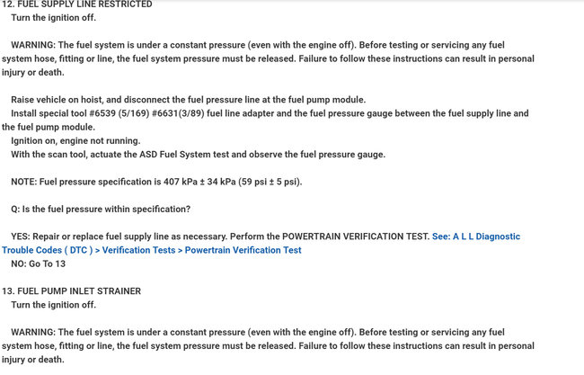

take to a garage that can freeze frame and read the sensors, seems like where you took it they did not know what they were doing. also check fuel pressure with a gauge auto parts rent it. then look for a vacuum leak. this can be anything from a basic ignition problem to some thing more serious which seems to have been eliminated. also do a compression check the engine should have never come out to begin with especially since you still have the problem. check plug wire and coil for resistance as well. from what you have written it almost sounds like a home garage where the person wasn't really qualified on what to do.
this guide can help as well

have them spray choke cleaner around vacuum lines for the leak.

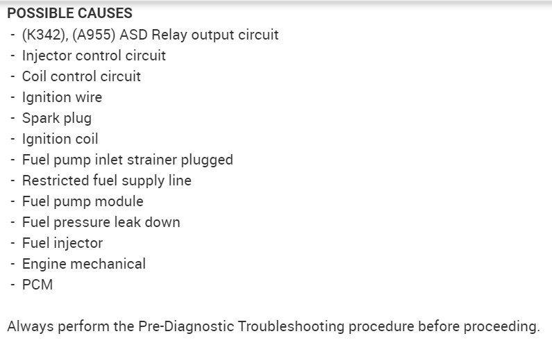

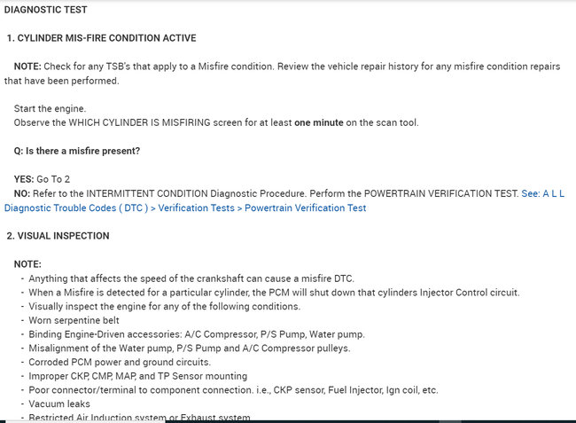

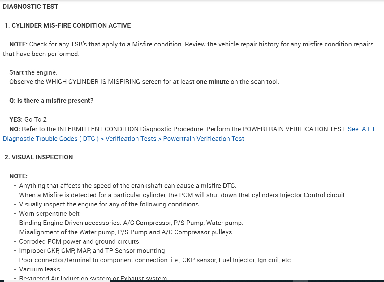

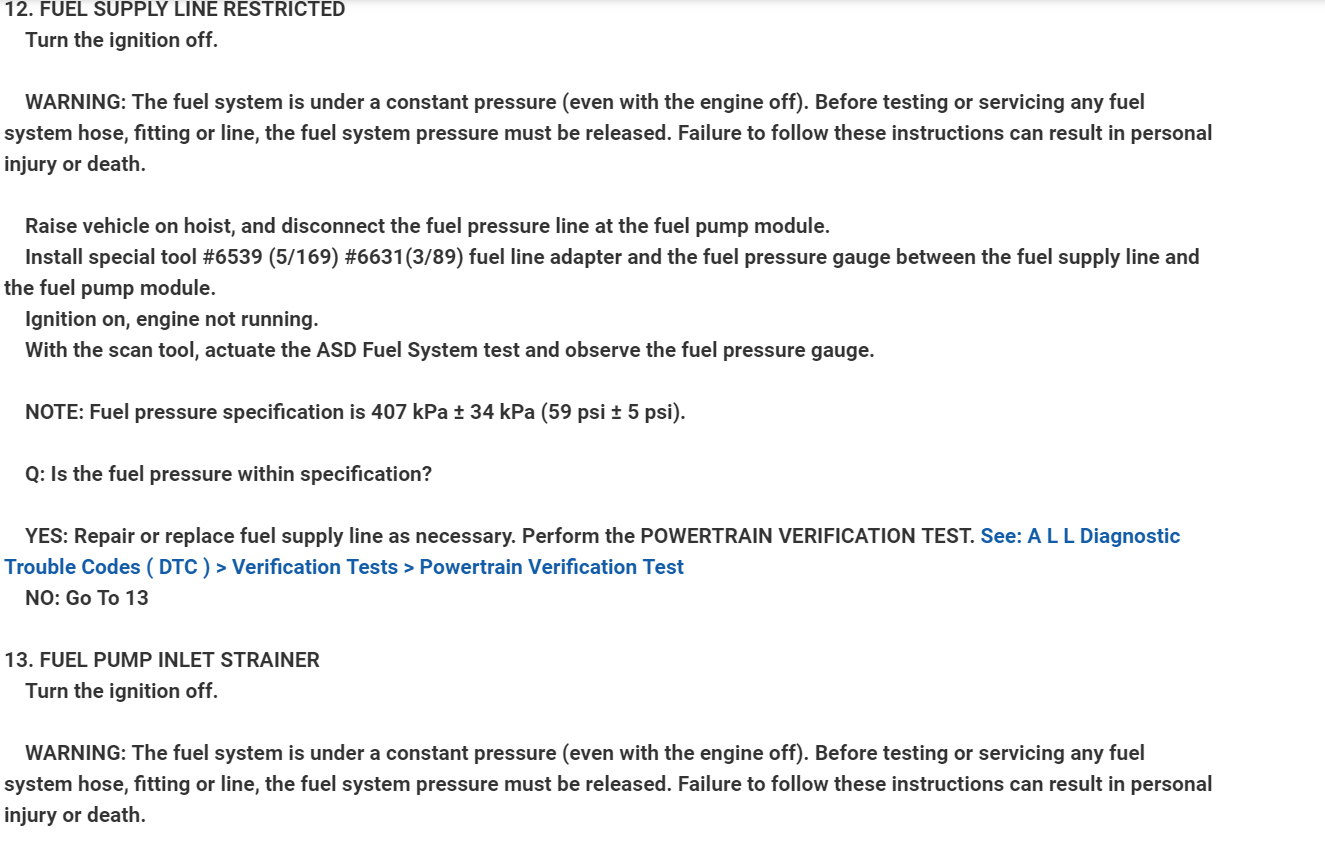

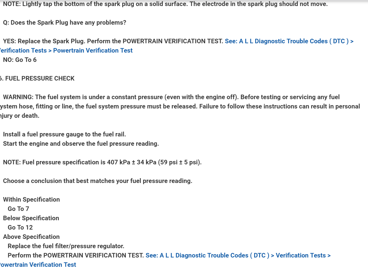

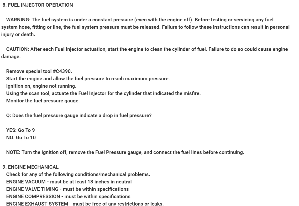

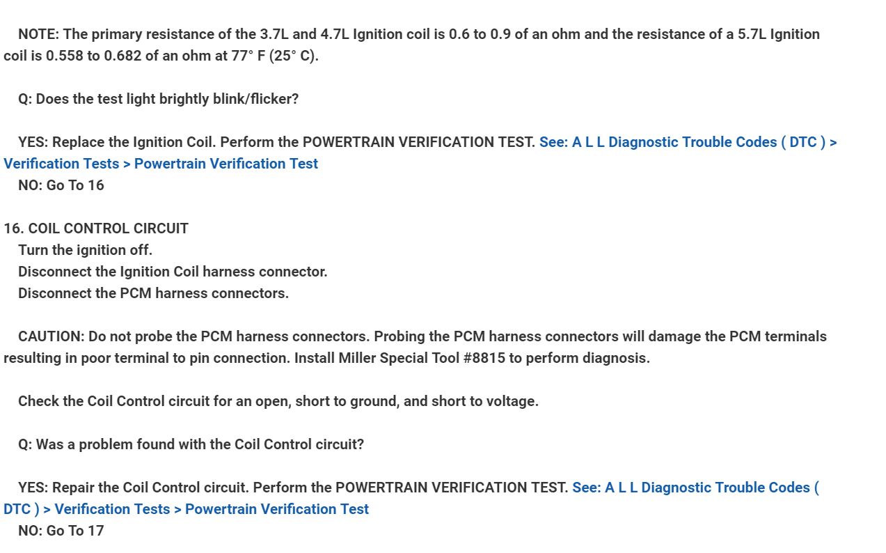

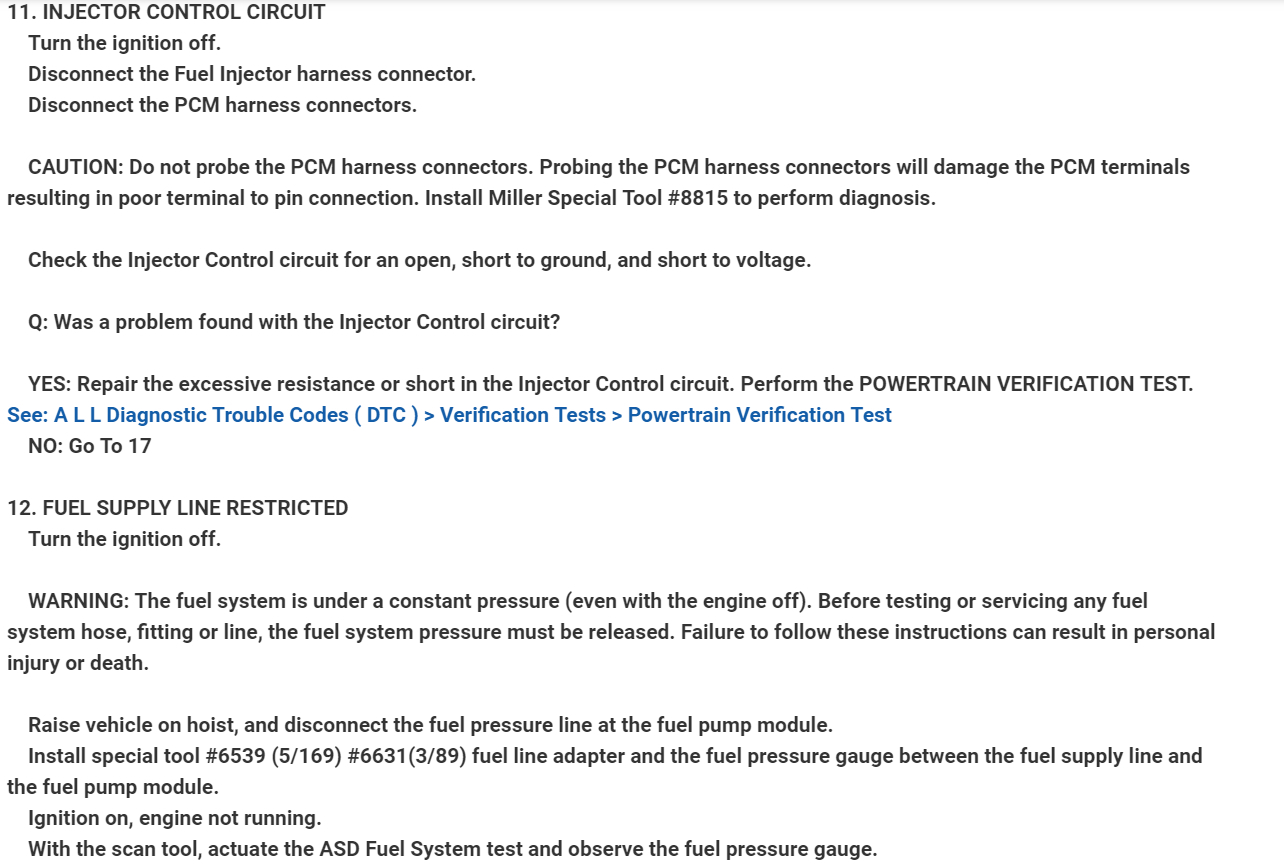

It very well could have been water getting down into your spark plugs and causing your vehicle misfires. I have included in the diagrams below a troubleshooting flowchart for P0300, which is a generic DTC for random misfires, But it will apply to each cylinder individually as well. Please go through it and let us know what you find out.

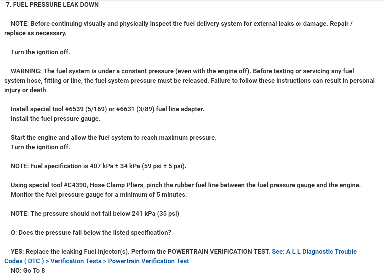

When you replaced the ignition components, did you also replace the coils? And did you have a check engine light on? If so, did you have the computer scanned?
If you've eliminated the ignition system as a possible cause, then the fuel system is the next target for diagnosis. Begin with the fuel filter. A clogged filter will allow the engine to run at idle but when you accelerate it'll bog the engine down because it can't flow enough fuel to supply the load. But if you're sure that only the right bank is misfiring, then it'll have to be something on that bank causing the problems. I'd believe it would be the injectors are clogged or the wiring for that side is faulty.

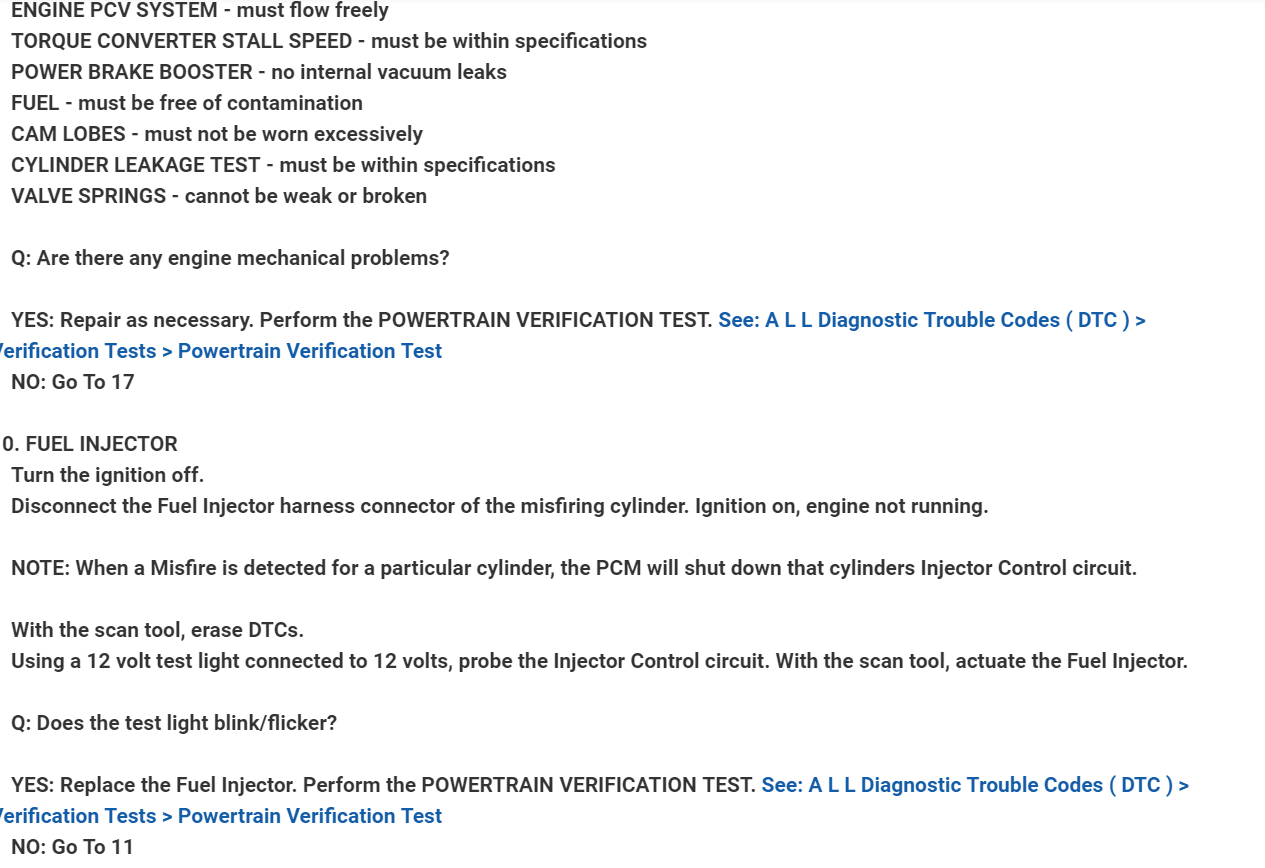

Misfires can be caused by worn or fouled spark plugs, a weak spark (weak coil, bad spark plug wire), loss of compression, vacuum leaks, anything that causes an unusually lean fuel mixture (lean misfire), an EGR valve that is stuck open, dirty fuel injectors, low fuel pressure, or even bad fuel.

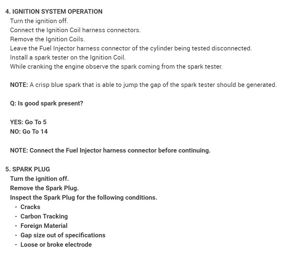

Perform spark check on coil packs/stick coils and replace all spark plugs.
Possible faulty coils/stick coils on cyl 1-4.
After check post findings for more diag.

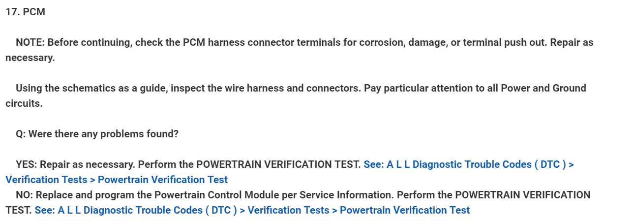

stick coils check out good on all eight cylinders. Is it possible that the PCM is bad? Or maybe injectors 1-4 are stuck open? Also I had a timing chain set installed after the problem started, but there in no change in the way the truck runs.

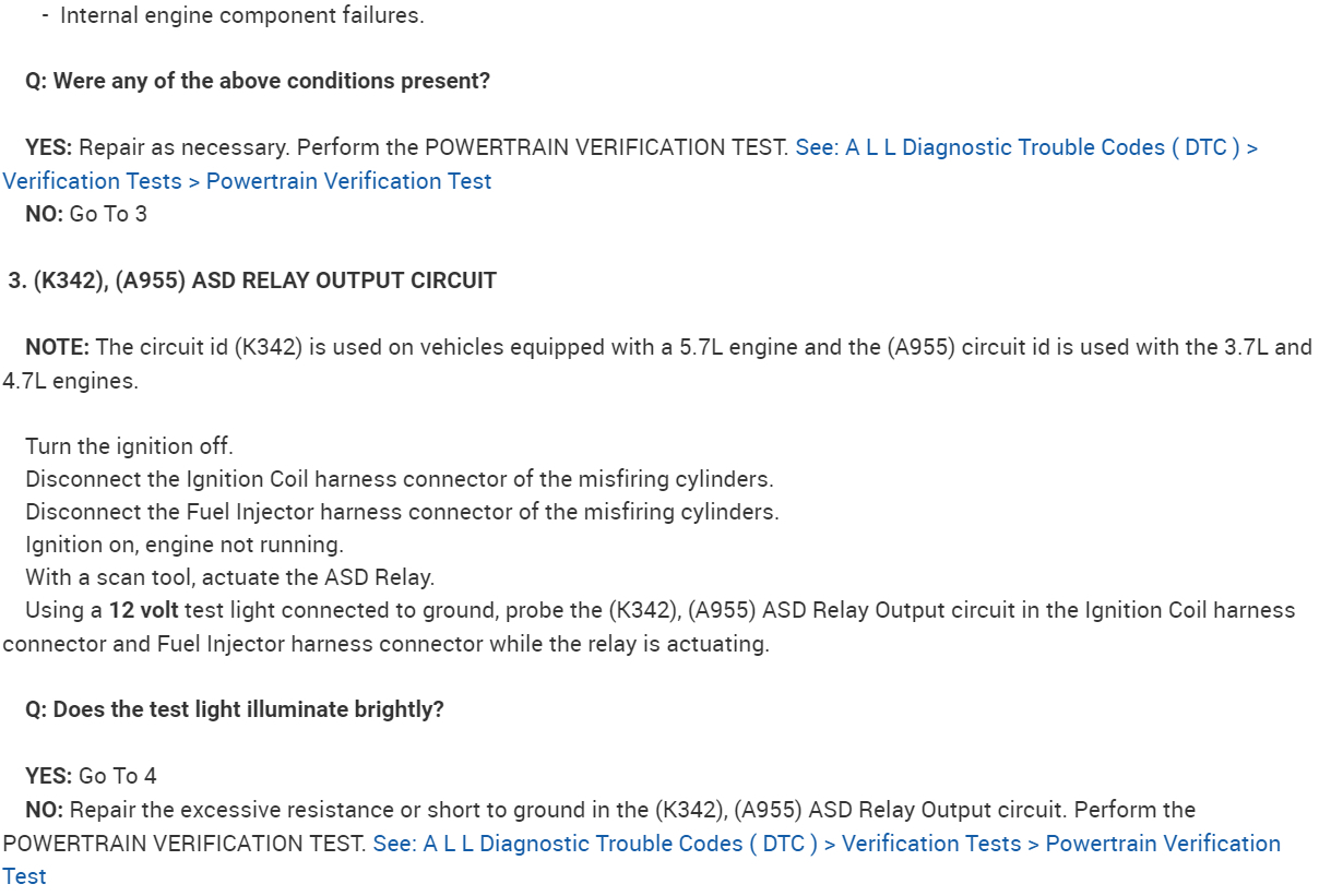

The pcm does control spark, but it is odd that you'd lose that number of cylinders.
Have you tried putting a scanner on it? I have seen before that a check engine light is not on but there were still codes (either pcm signal to dash is damaged, or engine light is burnt/faulty).
It's been a while since I worked on a hemi, are cyl 1-4 on the driver side?

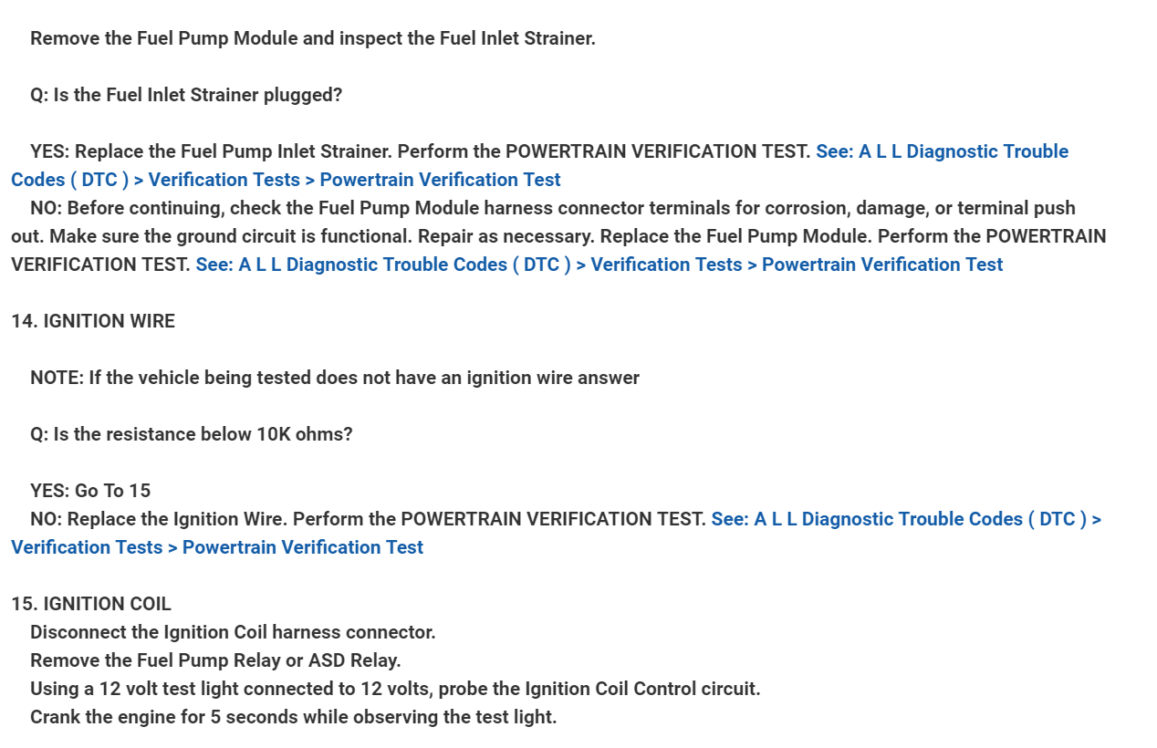

Also test power to coils with engine cranking.
Unplug all coils and attached battey charger/tender.
Test power to one of each coil connector... attach positive lead of volt meter to coil and negative lead of meter to chassis ground (I can't remember the color of the wire for the power to the coil, so you'll have to test for power to both wires)...test known good coil connector (from cyl that fire 5-8 to know the correct power wire) and then test bad connector (from cyl that do not fire 1-4). You should see a 12-14v power to them.
If power is good then suspect faulty coil/stick coil.
If no power, check fuses throughly (visual and ohm check). If no bad fuses then possible faulty pcm/ecu.
After tests report findings back. (include wire colors tested)
