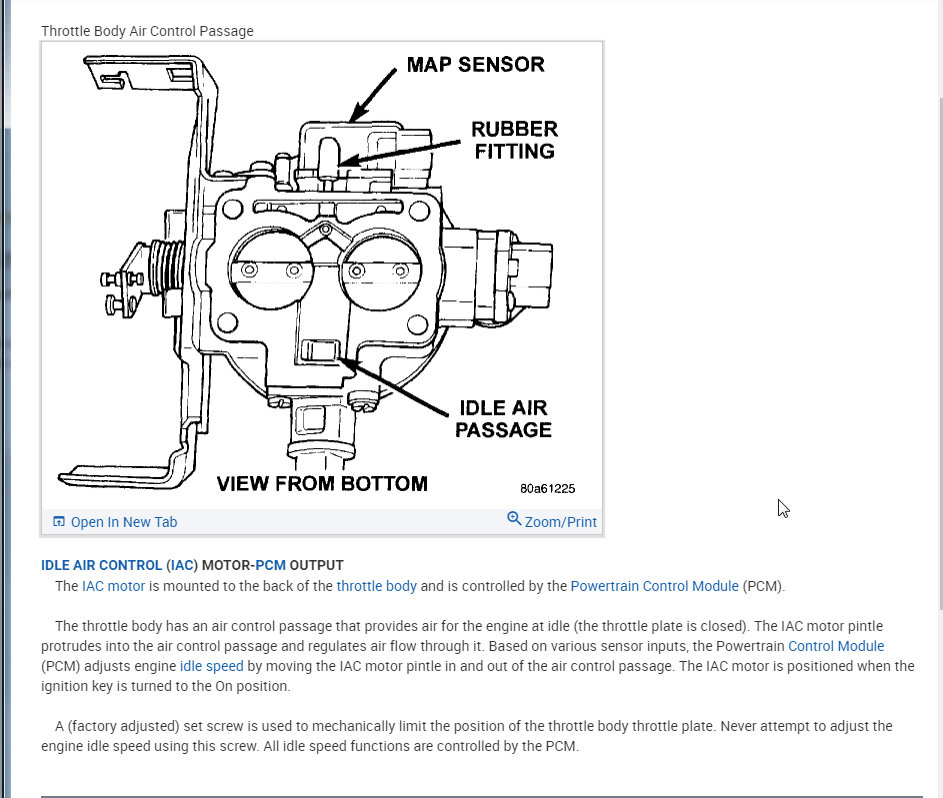

Sounds like the idle control passage is clogged and not allowing the engine to idle. Can you start the vehicle and then keep it alive by raising the RPM?
If so, we need to remove the throttle body and try to clean this passage and retest. Here is a guide that helps with this:
https://www.2carpros.com/articles/mass-air-flow-service
Let us know what you find. Thanks

FARRLYN ARNOLD
I had already tried that and it didn't work.
Oct 16, 2020 at 4:44 AM (Merged)
Just to clarify did you already try cleaning that passage and it didn't work or trying to keep it alive with more RPM and that didn't work?
If we haven't removed the throttle body and cleaned it, I would do that next even if you can't keep it running. Let me know. Thanks
