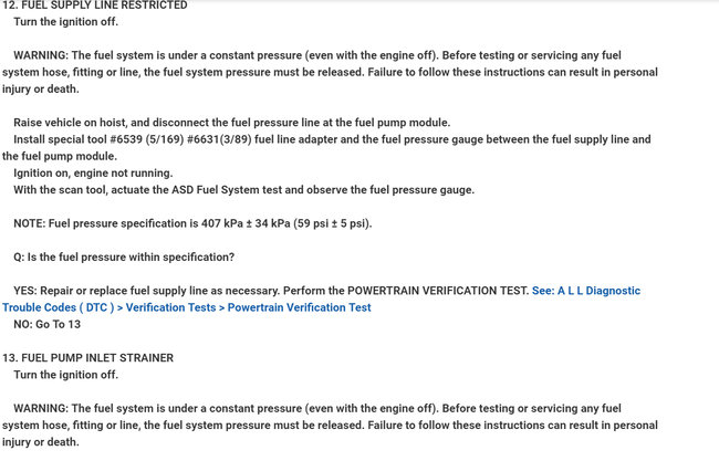

take to a garage that can freeze frame and read the sensors, seems like where you took it they did not know what they were doing. also check fuel pressure with a gauge auto parts rent it. then look for a vacuum leak. this can be anything from a basic ignition problem to some thing more serious which seems to have been eliminated. also do a compression check the engine should have never come out to begin with especially since you still have the problem. check plug wire and coil for resistance as well. from what you have written it almost sounds like a home garage where the person wasn't really qualified on what to do.

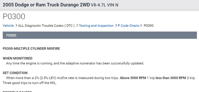

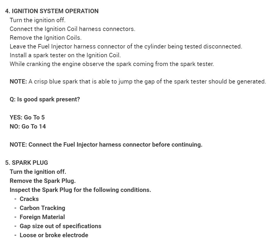

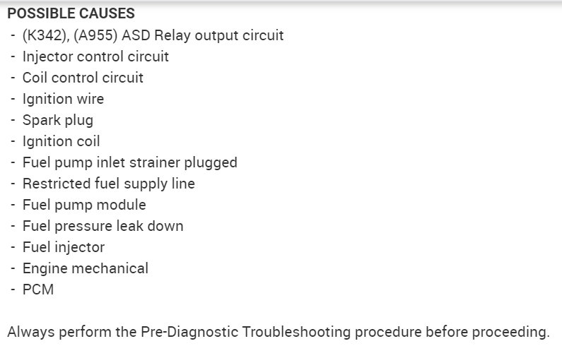

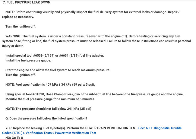

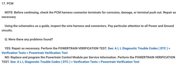

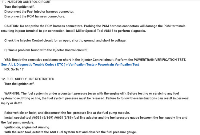

I recently purchased a 2005 Durango after my 2004 Durango limited hemi was totaled. This new one is in excellent shape. Was driving no problems, no codes, no engine trouble. Took it to dealership to recall passenger airbag. I got home filled all fluids, and I had to spray engine down will some coolant that leaked when filling radiator up. We went out to dinner and on way home the truck suddenly started to misfire. This came out of no where. We did a sudden increase in speed to pass a car. I put the scanner on it and it came back with cylinder one misfire. I got into the component check and found not only did cylinder one misfire 42 times, cylinder 6 misfired 2 times and cylinder 8 misfired once. There has been absolutely no problems until I hosed off the engine compartment. Could the harness have gotten wet and just needs to dry out or could something else have happened out of nowhere? Nothing like this has happened until it was at the dealership and they replaced airbag and checked fluids. I did purchase new spark plugs for it and just haven't put them in yet as there was no problems till now. Do I just need to see if it was the harness that got wet or do I need to look further into this?
Misty
Oct 7, 2020 at 4:18 AM (Merged)

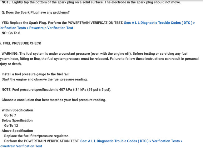

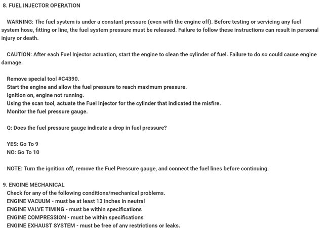

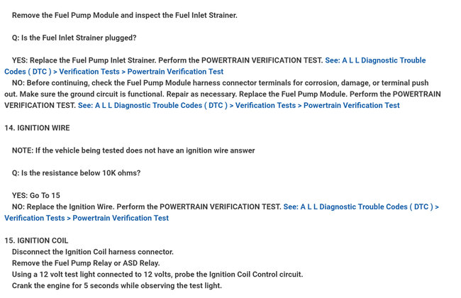

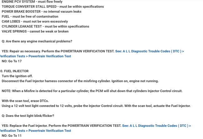

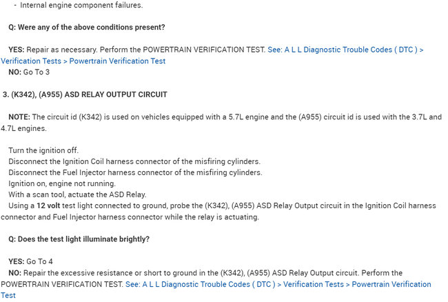

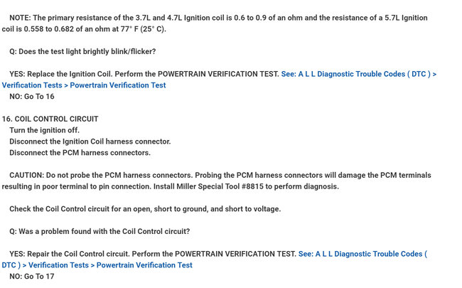

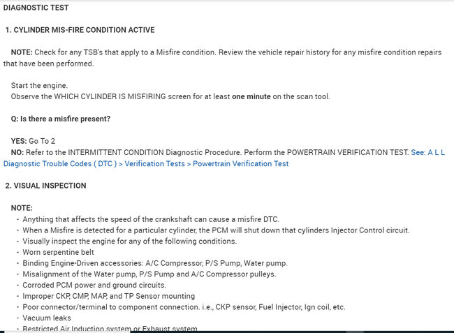

SCGRANTURISMO
  • 4,897 POSTS
It very well could have been water getting down into your spark plugs and causing your vehicle misfires. I have included in the diagrams below a troubleshooting flowchart for P0300, which is a generic DTC for random misfires, But it will apply to each cylinder individually as well. Please go through it and let us know what you find out.
