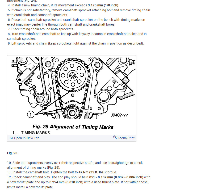

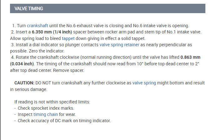

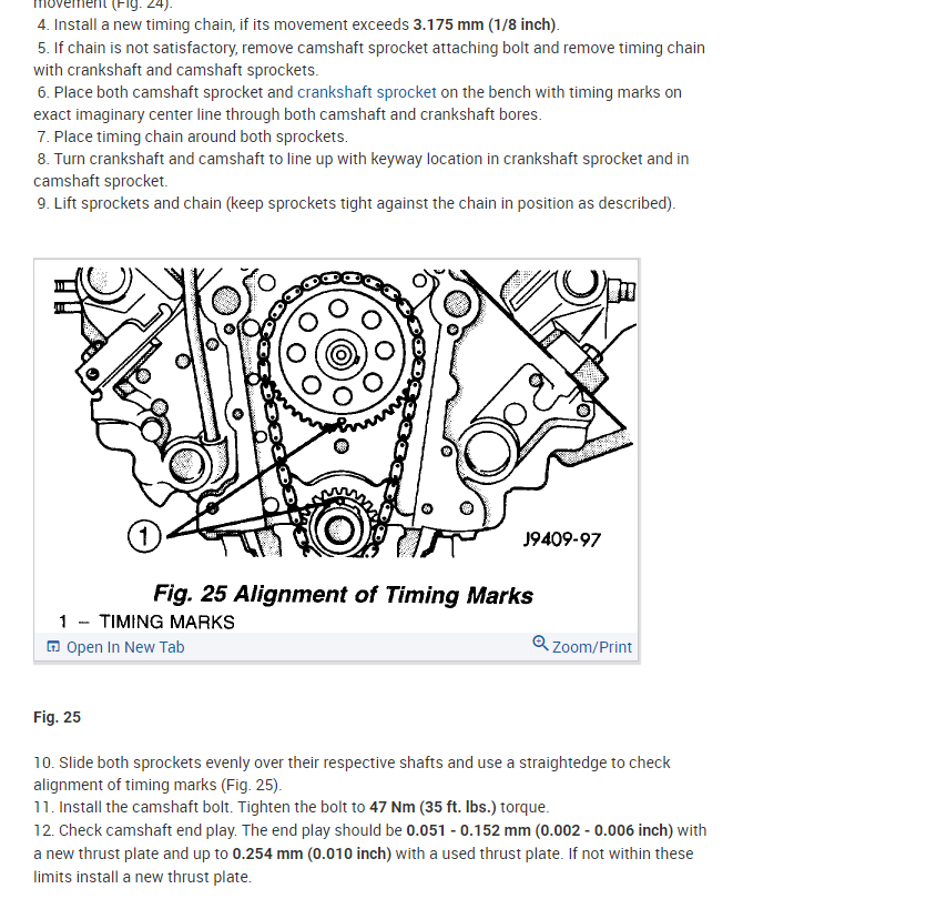

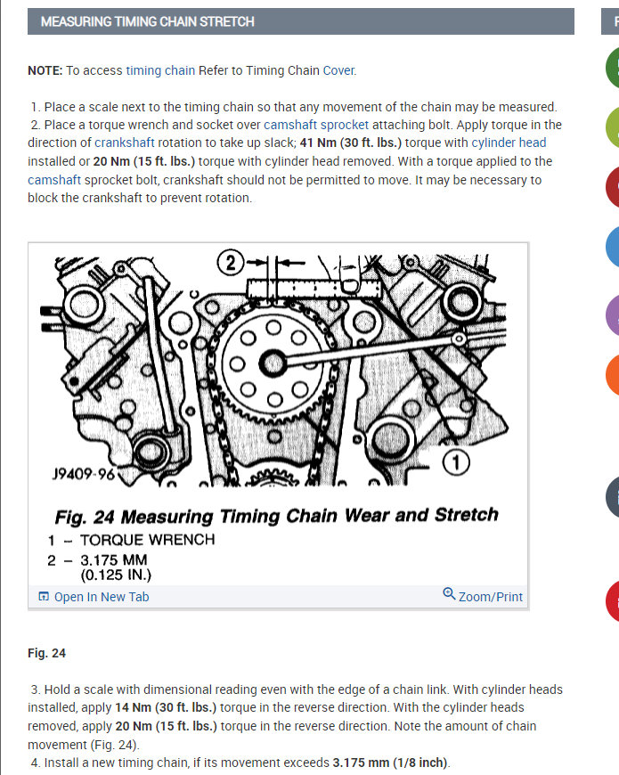

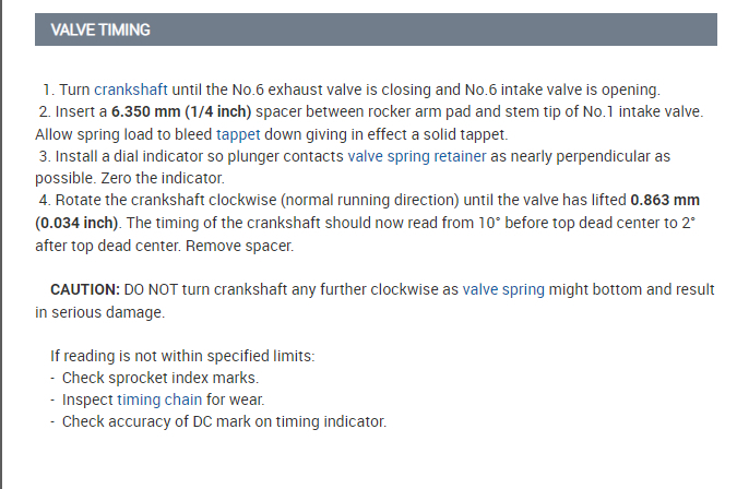

Once we know that we have good compression we can take the next steps. However, I am wondering if we have a head issue that we are loosing compression or even a timing chain issues. When you replaced all this, did you install new chains?
We need to not only take the front cover off but inspect for stretch in the chain. Please see the process below on how to do that.
Let us know what you find and what questions you have.
