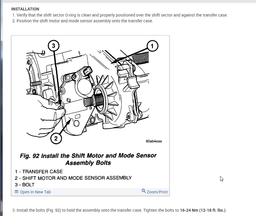

This is hard to know for sure but we need to start with listening to see if the actuator is trying to engage. If it is not then we need to check for power at the actuator and if there is power then the actuator needs to be replaced.
The most common cause of this is the actuator so I attached the process below on how to replace this. Please let us know if you have questions on this. Thanks

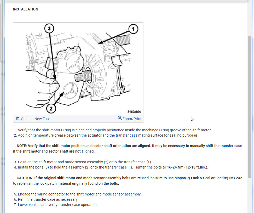

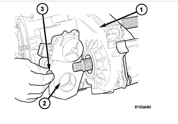

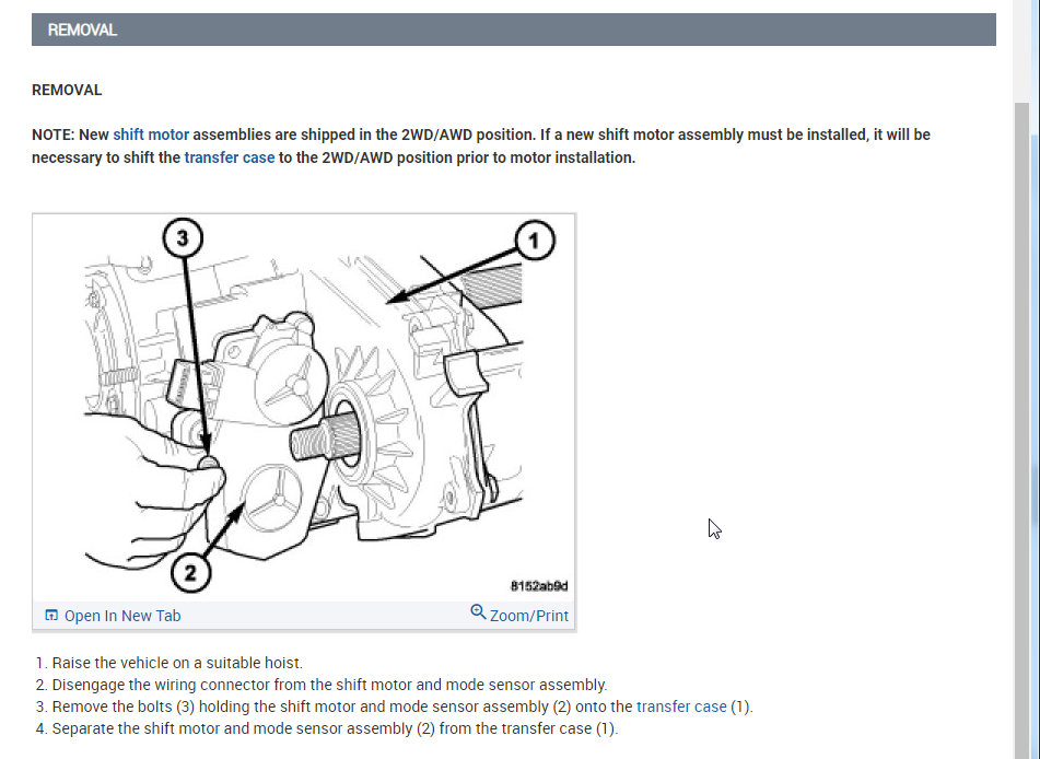

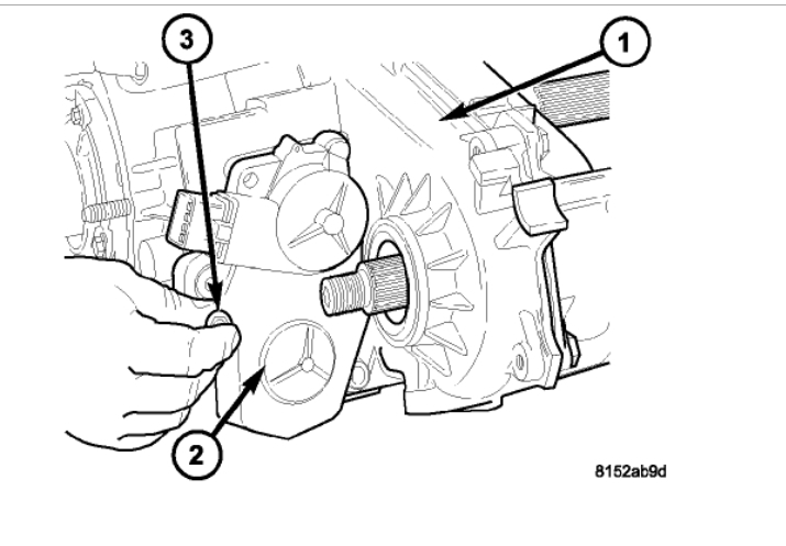

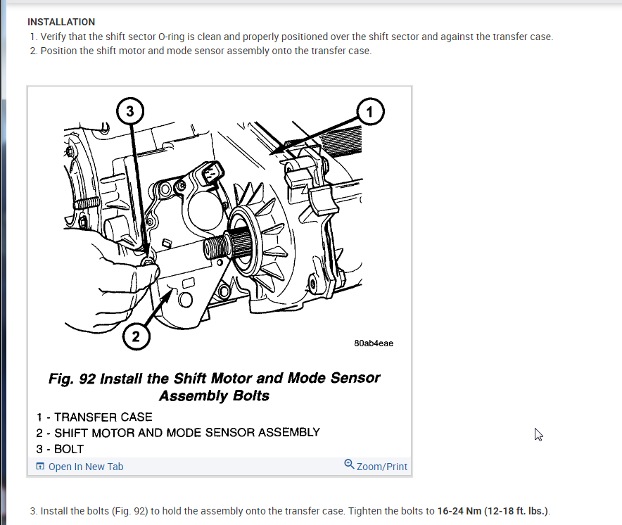

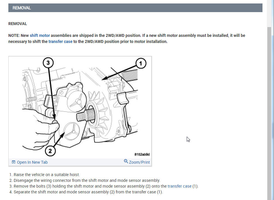

This happens when the transfer case shift actuator/sensor needs to be replaced. Here is how you fix the problem:
Note: New shift motor assemblies are shipped in the 2WD/AWD position. If a new shift motor assembly must be installed, it will be necessary to shift the transfer case to the 2WD/AWD position prior to motor installation.
Raise the vehicle on a suitable hoist.
Disengage the wiring connector from the shift motor and mode sensor assembly.
Remove the bolts (3) holding the shift motor and mode sensor assembly (2) onto the transfer case (1).
Separate the shift motor and mode sensor assembly (2) from the transfer case (1).

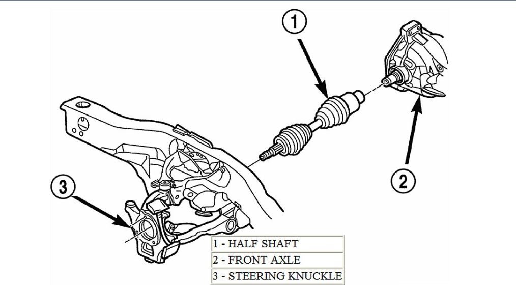

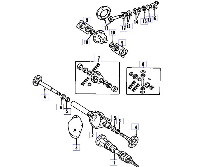

Four wheel drive engages on driver side but not passenger side.
Apr 14, 2021 at 11:14 AM (Merged)
Good evening,
It sounds like one of the axles are not locking in.
Is there any damage to the axle? Is it turning?

No damage that I see it doesn't turn when engaged.
Okay, if it does not turn, then you have a defect inside the front differential.
It will have to be opened up to inspect for the failure.

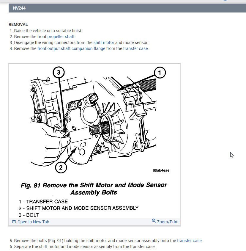

four wheel drive will not engage, makes a grinding noise when driving.
Apr 14, 2021 at 11:16 AM (Merged)
More then likely this is due to the shift motor has failed. I attached the process below that will help replace this.
The fact that is it grinding shows that the motor is trying to shift which proves out all wiring and the switch which leaves the motor or the transfer case itself. Which is more likely to be the motor and not the case.
Below you will find the process on how to replace this shift motor.
Let me know if you have questions on this and we can go from there.

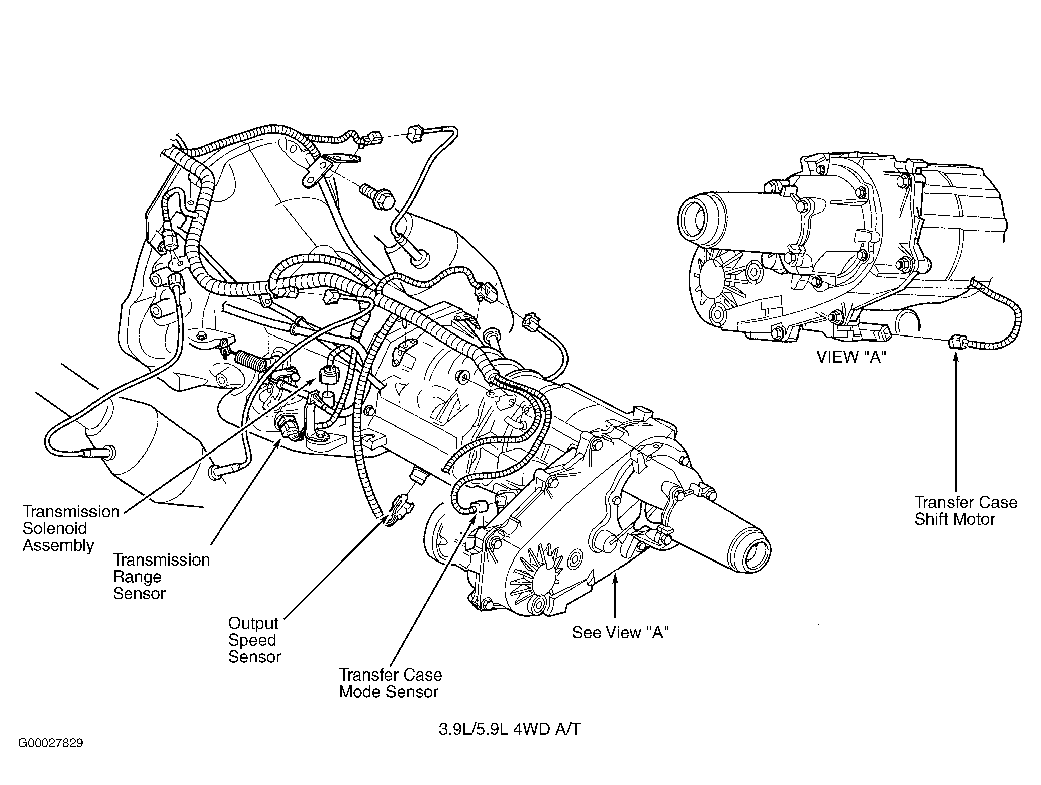

the light in the insterment cluster for 4 wheel lock dosen't come on when the the shifter on the floor is put into 4lo or 4hi. Could this be the transfer case position sensor . If that is possible where is it located and hopw do you test it?
Apr 14, 2021 at 11:17 AM (Merged)
  • 110,240 POSTS
I think you are correct. THere is a switch on the top (of all places) of the transfer case that turns the light in. They go bad. The part just unbolts, but it is a tight space.
  • 110,240 POSTS
Here is what I was able to find. I believe you need to locate the mode sensor. Confirm that with the parts store. NOTE: This picture is for a 6 cylinder auto trans.

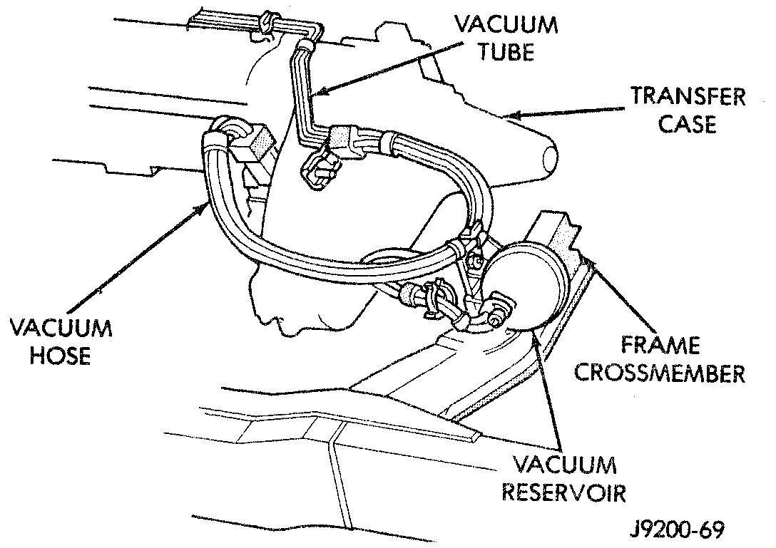

When I engage it into 4 wheel drive it feels like it goes in but it is not.
Apr 14, 2021 at 11:21 AM (Merged)
  • 110,240 POSTS
The system is actuated via engine vacuum. Do me a favor. Crawl under the vehicle and look up at the transfer case. Check for broken, disconnected, or dry rotted vacuum hoses.
Next, it has been some time, but I believe there is a vacuum reservoir under it as well. It will be black plastic and round. Check that as well.
Finally, the vacuum hoses run to the front axle. Check there as well.
I attached the only pic I could find related to the vacuum/4wd. It will help you locate the vacuum switch on the top of the transfer case. Keep in mind you have to make sure there is vacuum getting to the switch from the engine.
Take care and God Bless,
DAVE CAIN
It was a vacuum hose that had cracks in it and I want to thank you for your information.
