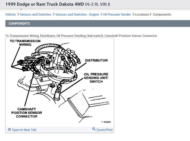

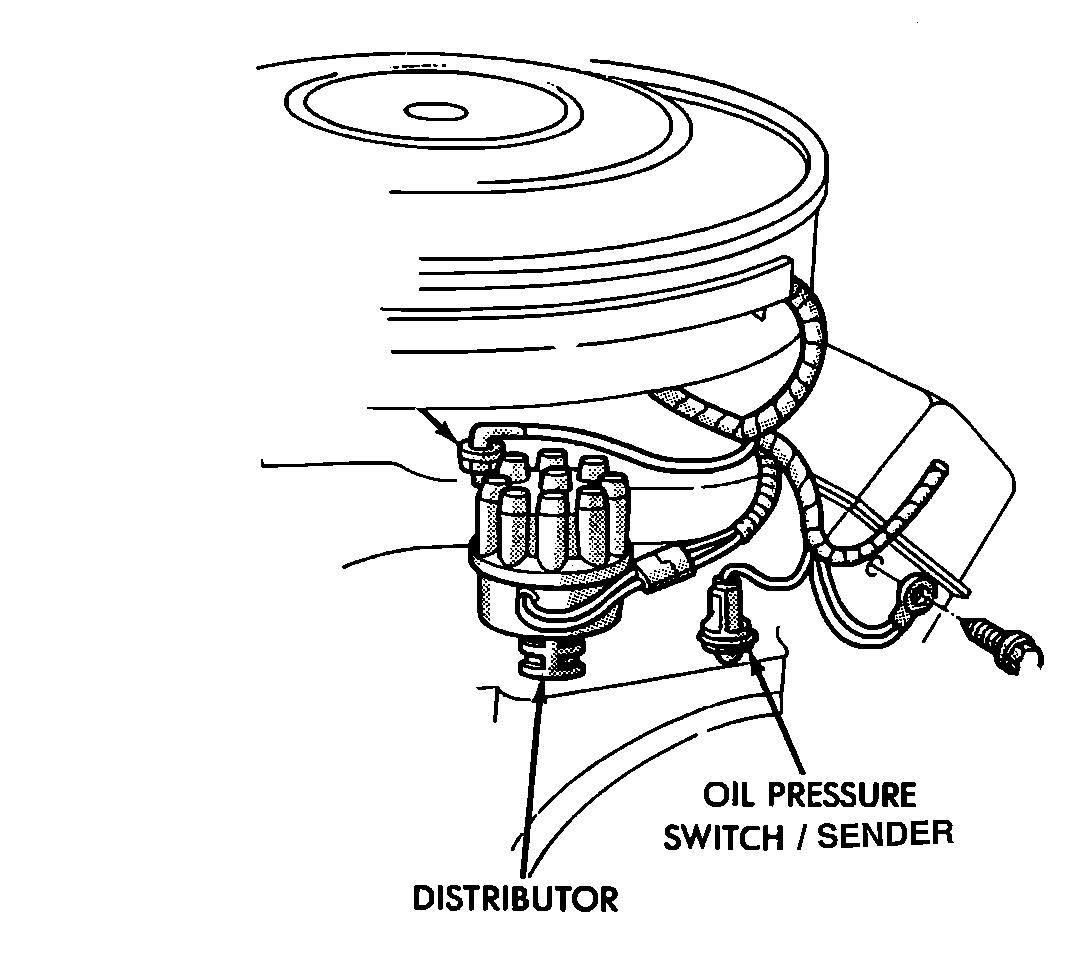

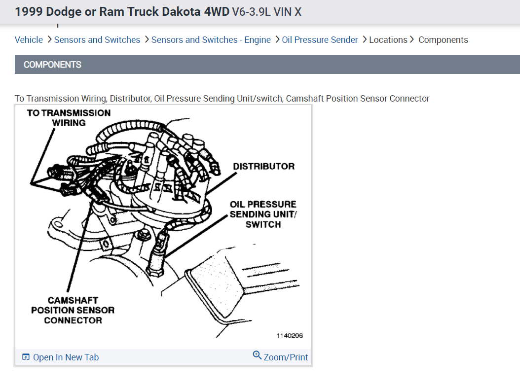

EDD67
Where is the oil sending unit located on this engine. Do you have a diagram you can forward ? My owner's manual shows location of every engine component EXCEPT this one!
Oct 19, 2020 at 6:43 AM (Merged)
MERLIN2021
  • 17,250 POSTS
The oil pressure sender is at the top rear of engine near distributor. Check out the diagrams (Below). Please let us know if you need anything else to get the problem fixed.
