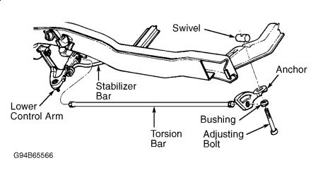

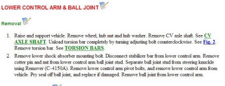

HI there,
Thank you for the donation,
See text for ball joint removal, if you need more information re post for more assistance.
