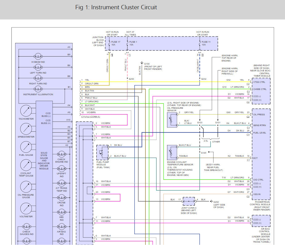

The Speedometer doesn't work at all . We change a front and a rear sensor want else can it be.
Mar 2, 2010 at 10:09 AM
  • 110,194 POSTS

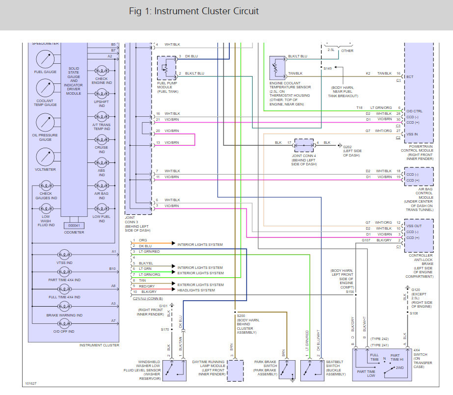

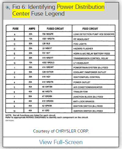

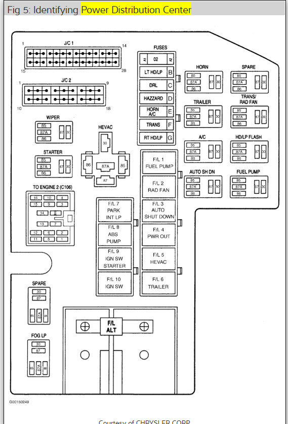

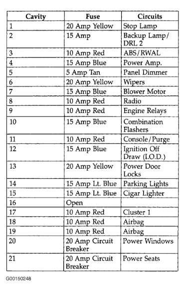

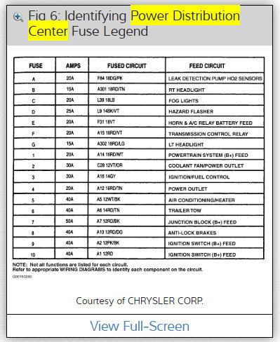

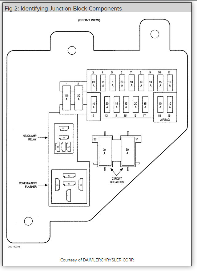

Lets check for power at fuses 11, 1, and 17 here is a guide and the wiring diagrams for the cluster so you can see how the system works and the fuse locations.
Mar 5, 2010 at 10:43 PM
TURBOJAY
Thanks for this post I had a bad connection at the cluster all i did was unplug the cluster and plug it back in, all fixed!
