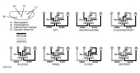

JOSH_BROWNING32
  • 12 POSTS
Iv had that out b4 and it has bout 8 diff color coded vacuum lines in it to the back on the switch but how do I get vacuum to them
Sunday, June 13th, 2010 AT 8:56 PM
BLACKOP555
  • 10,371 POSTS
https://www.2carpros.com/forum/automotive_pictures/66751_3_1.jpg
black line is 8inch of vaccum on those ports.
and the white is vented. each position is labled underneith
+1
Sunday, June 13th, 2010 AT 9:13 PM
JOSH_BROWNING32
  • 12 POSTS
I just checked them and they have no vacuum
Sunday, June 13th, 2010 AT 9:23 PM
BLACKOP555
  • 10,371 POSTS
Do you have vaccum coming to the switch?
Sunday, June 13th, 2010 AT 9:25 PM
JOSH_BROWNING32
  • 12 POSTS
No none at all
Sunday, June 13th, 2010 AT 9:27 PM
BLACKOP555
  • 10,371 POSTS
Now were getting somewhere.
There should be a black vaccum line under the hood that runs from brake booster check valve or intake manifold fromt here it runs through the firewall by the heater core hoses. Check for vaccum coming to the line there. Before the checkvalve and after. If you have vaccm there the restriction or a leak in that line.
Sunday, June 13th, 2010 AT 9:33 PM
JOSH_BROWNING32
  • 12 POSTS
Ok I have vacuum at the break booster check valve b4 and after and the lines have vacuum but I still dont have it at the switch
Sunday, June 13th, 2010 AT 9:50 PM
BLACKOP555
  • 10,371 POSTS
So the vaccum line that goes throug the firewall. The black one. Has vaccum up to the firewall. But where it connects at the switch has 0? Must be restricted
Sunday, June 13th, 2010 AT 9:51 PM
JOSH_BROWNING32
  • 12 POSTS
Yeah should I jus follow the lines and go from there see what I find?
Sunday, June 13th, 2010 AT 9:58 PM
BLACKOP555
  • 10,371 POSTS
Yes or run a line from the brake booster to back of switch and everything shoudl work then youcan drill a hole in the firewal to put in new line if you want or you can pull the old one out and thread in new one. But there has to be something wrong with that line if you have vaccum up to firewal but none to switch
Sunday, June 13th, 2010 AT 10:23 PM
JOSH_BROWNING32
  • 12 POSTS
Thanks just ran the new line and it worked perfect what can u tell me about it not geting cool tho
