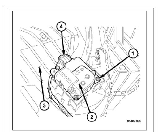

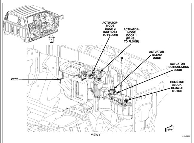

I am getting cold air, but it is only blowing through the defrost vents and not through any other vents either on the dashboard or the floors. What do I need to do?
Saturday, August 22nd, 2009 AT 7:30 PM
SAFARI1988
  • 8 POSTS

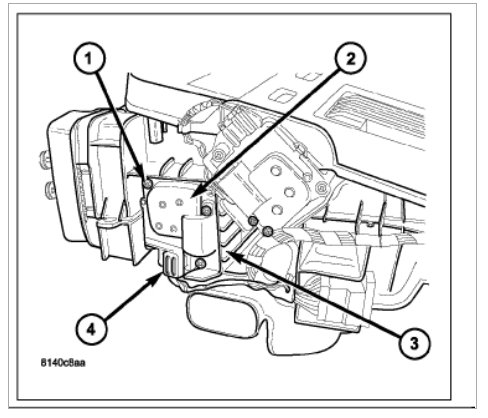

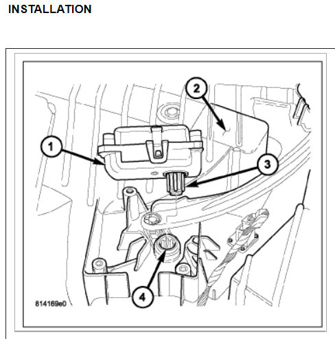

It sounds like you need to replace the mode actuator motor here is a guide to show you what you are in for when doing he job and diagrams below to show you the location for your car.
