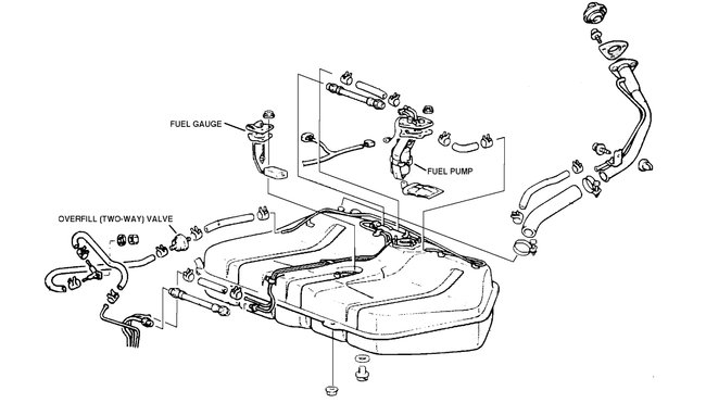

Where is the fuel pump located at?

You may need to drop the tank if its doesnt have a trap door above the tank here is a guide to help you see what you are in for and diagrams below to show you on your car.

look on the floor under the back seat for a circular plate of metal - remove it.

Where is the fuel pump and how do I get it out.

The fuel pump is in the gas tank if there is no access panel through the back seat/trunk you have to drop the tank.

The fuel pump is inside the gas tank. Check under the rear seat or trunk floor for a circular metal access plate and remove it to reach the pump. If no access panel is present, the fuel tank must be dropped to remove the pump.
