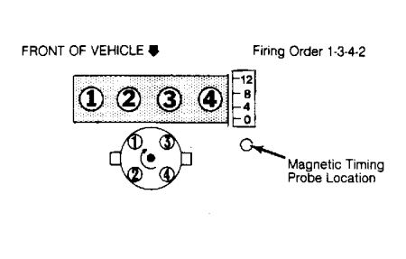

After I changed my spark plugs , wires and distributer cap, it start but ran bad and has no pawer. Im sure i pluged the wires back in corectly but maybe not. In aney case i need help. would some on know the proper sequence that they shoud go? or somting els i may have done wrong...

Hi: Here is a picture of the order the plugs should be in.
https://images.2carpros.com/forum/automotive_pictures/249084_firing_1.jpg
Let me know if this helps, or if you have other questions. Joe
