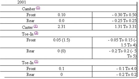

I was wondering if someone can read these wheel alignment readings for me and tell me how they look. I've noticed there was one number marked with black background square, so I guess that's the number they adjusted. They also wrote another (new) number with a pen right next to the one that's marked.
I'm just wondering if there is someone who can tell me could this really be what caused y car pulling to the left... I repeat, it wasn't that obvious, but I've noticed it when driving. I also noticed that when I used to hit some small bumps on the road, my steering wheel used to tilt to the left side... always to the left and never to the right... it also looked to me like turning my steering wheel to the right side was a little harder than when I'm turning it to the left side. Now it looks a lot more even.
Here is how this sheet of paper with readings look like. I marked that number exactly the same way they did it on the original paper and I also added that new reading for Rear Left Camber and marked it in blue (they added it using a pen).

The caster reading is how the wheel sets in a front to rear position, the more negative the further back it sets, the higher the number the more it sets towards the front. The camber was moved forward 3 degrees on your left rear. Hopefully it was just the positioning of the alignment that made the pull. I have seen new tires that have had a pull, by swapping them side to side, you can see if the pull changes.
Camber is how the wheel is tipped into the body or tipped out.

[quote:0238ac1c40="Service Writer"]The camber reading is how the wheel sets in a front to rear position, the more negative the further back it sets, the higher the number the more it sets towards the front. The camber was moved forward 3 degrees on your left rear.[/quote:0238ac1c40]
Hello and thanks for your prompt respond.
Is it really 3 degrees or just 0.03 degrees ? If it's this second number I posted, isn't that such a small difference ?
So, could this really be the culprit of my problems ? They told me this shouldn't solve anything trying to tell me that what they did first time was also OK.
Thanks again !
EDIT: Oh sorry... I just noticed that number on the ight side (for rear right wheel) is positive and for the rear left wheel, it is corrected but still negative number... why is that ?

Sorry, my brain fell out when I posted this earlier. You are right : .03.
I had caster on the brain, when posting.
Were the alignment heads put back on the vehicle?, did you see what they were doing?
Were the tire moved at all?
Not a grand caravan, correct?

They took off all wheels, that's what I saw. Also they put all those spider looking tools (LOL, sorry not sure how they call them) on wheels and they did some checking on that computer unit.
No, it's not Grand Caravan, it's just Caravan 2004 (December 2004 actually, new line with huge headlights)
Also, I am not sure why they had to adjust that number just from -0.28 to -0.25 and they did nothing regarding that huge gap between those first two numbers at the top for the Front wheels... I don't understand a thing they did...

They may not have adjusted it, you can have a variation like that when the it is set up a second time. I pulled up the specs to look at what they should be.
https://images.2carpros.com/forum/automotive_pictures/30961_spec_1.jpg
The reason the -.28 is highlighted is because it is out of spec. -.25 is as far as it can go. A pull would be expected toward the wheel that has a higher positive camber, which would be the right front. However the rear camber is at extreme opposites not to mention just barley in spec. Looking at the numbers, I f you let go of the wheel I would think it would want to go right. For the heck of it check your tire pressures. I can help but also wonder if there is a bad tire present that was rotated. I agree the camber should have been brought closer to zero or at least closer to offsetting. The rear camber doesn't have adjustment but a kit can probably be installed to adjust it.

The strange thing is that I just came back from work, and on highway, I've noticed that car still pulls slightly to the left, not to the right as you mentioned. Reading those numbers I believe it tells you that it should pull to the right, but it's pulling slightly to the left.
They've checked pressure in all 4 tires and it was as specified for this vehicle.

When he was done, he told me that it wasn't done properly first time, and whoever was working on my van, wasn't doing it properly. He had to adjust Camber on both front wheels, as well as some toe adjustment.
I am happy to say that my van runs perfectly straight again...
