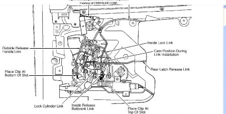

I was wanting to know if anyone can tell me how the rear door latch rod hooks in so you can open and close the door. It is a 1999 dodge caravan v-6 engine 3.3 liter. It has 122,000 miles the rod came loose we got the door open but can not find where the rod hooks so it will open once it is closed

Hope this can help
https://www.2carpros.com/forum/automotive_pictures/99387_ply_2.jpg
