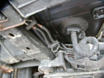

I have a 96 dodge caravan i bought it has a 3.3 loaded,my problem is the person i bought it from tried to repair the brakelines hiself,in doing so he removed all the lines going to abs unit,i need a diagram of some sort to replace the lines in the correct order to abs unit,have no idea were they go and they right way to connect them to abs,Any help would be greatly appreciated,Thanks

Thanks after looking at it today i did find pieces of the old brake line it was flex line i found them in the back on the floor but they are ruined,the kid took all the lines off the vehicle,front and back,the only good thing is he got the old lines off at each point without destorying anything else,on the abs unit it has four locations for four lines do the front lines go to the first two on the left of the abs unit and the back two,the last two on the right or vic versa,thanks

I'll try to find out, I had one similiar in the shop, but the phone stated ringing and I rushed the pic :roll: . But I'll see what I can find, there is another on in the lot :cry: I can crawl under.
https://images.2carpros.com/forum/automotive_pictures/30961_P8210007_1.jpg

Thank You,the image is a big help,I surely appreciate all your help maybe i can get this vehicle done now that i see how i am suppose to connect the lines,I only paid 150.00 for the van and it runs and looks great,so its worth fixing,has double sliding doors and its loaded.I was afraid i was going to wind up putting 1000 bucks in it.I thank you again very much.You"ve been a great help,John
