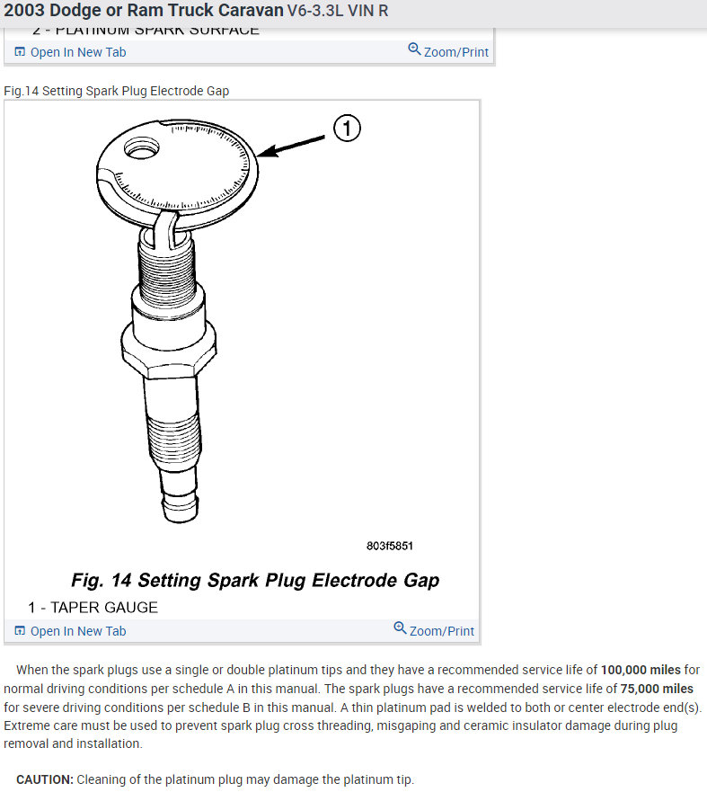

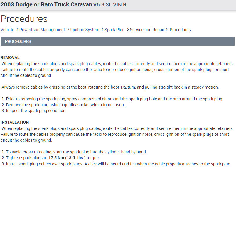

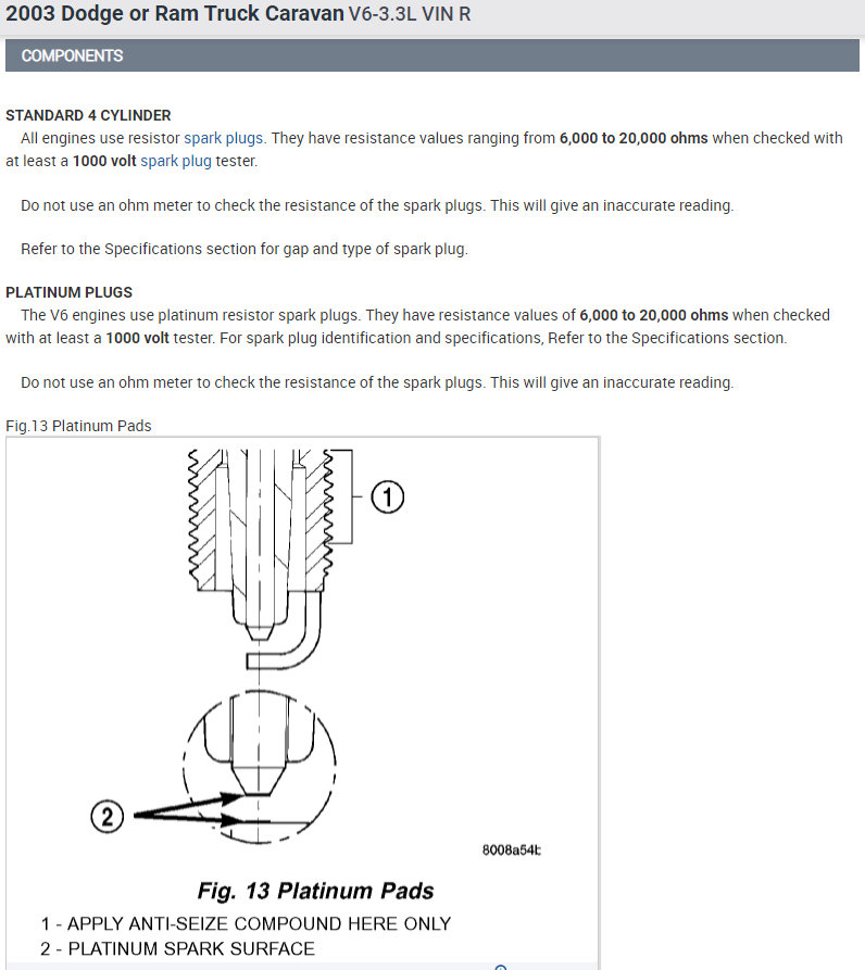

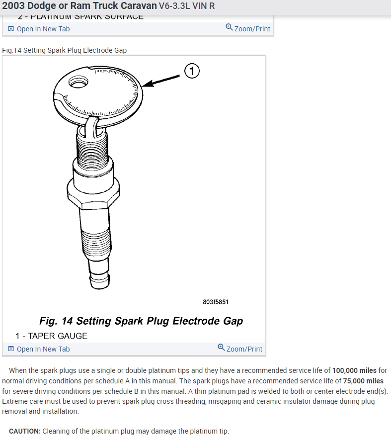

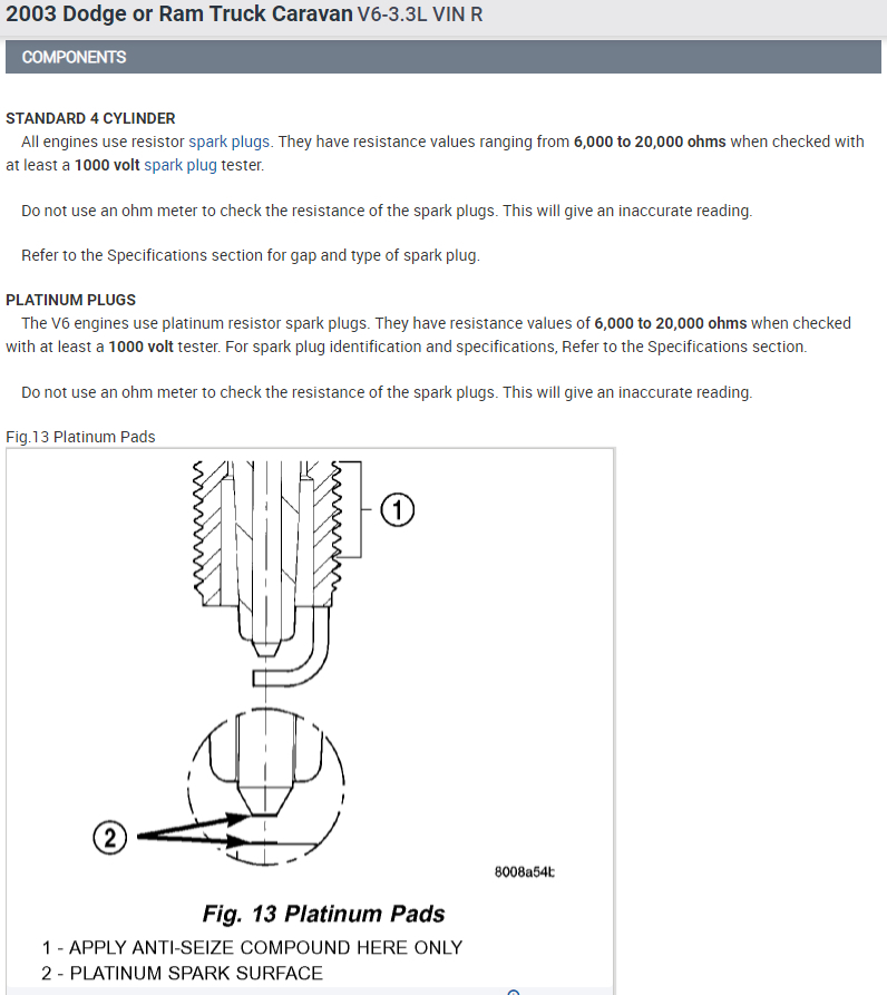

Check the spark plugs for wear and make sure the gap is set correctly.
The factory recommended gap is 0.048 - 0.053 in.
If there is excess carbon build up on the plugs it is likely the reason for the misfire.
The spark plugs can be replaced using basic hand tools.
