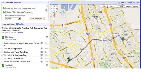

The coolant temperature sensor and the themostat is new. This case is not low fuel consumption, but Incorrect fuel consumption.(Caused by ?????) Next step: Replace the O2 before CAT with the genuin O2 from dealer part. This route I drive every day for 10+ year, unless the Google map is wrong, the Yahoo map is wrong, the Bing map is wrong, the satellite system is wrong.

I am sure that CH12063 didn’t mean to indicate that you are wrong but The method that we are used to use to determine mileage per gallon is that fill the tank mark down the mileage and drive the vehicle until need gas ,fill tank
check how many mile did you drive and divide it by how many gallons did it take
that would be the average mile per gallon the you are doing
the method that you explained not a very accurate method
