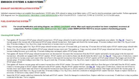

OBD codes P0442, P0455 & P0456...leaks leaks and more leaks! My mechanic says it's the "vacuum pump" but I'm not sure whether he meant the cannister or the leak detection pump...or something else? I like to work on my own car when I can (girl power) and would like to give this a whack, provided I do the research and determine it's not above my abilities.

We had an 01 in the shop a short time ago.
We had to use the smoker to get it, but I'll pass this along:
First one was a vacuum valve off of the
vapor canistor. If you take off the vacumn line , it should have be dry. ours was wet.
Secondly we put the there was
a very small leak at the canister; the hose was cracked in two places.
Alos check under the air filter for a rubber line that tends to crack.
May just want to replace all the rubber lines for the evap. Might be just a matter of time before you have to go back into again anyway.
He may be refrring the the Leak Detection pump, If it runs too long, the computer assumes a leak.

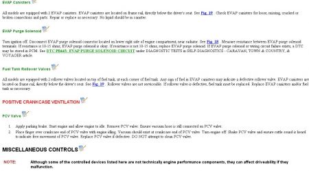

How hard can it be?.....You would be amazed. Check your email.
https://images.2carpros.com/forum/automotive_pictures/30961_em1_1.jpg
https://images.2carpros.com/forum/automotive_pictures/30961_em2_1.jpg
Gas cap wouldn't typically set a small, med and large leak set of codes, one maybe two of them, Ihaven't come across that anyways although it's possible.
