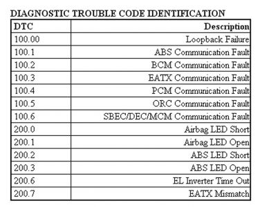

The cluster in those are a problem, I'll update this in a minute. Take a look at these posts. https://www.2carpros.com/forum/electrical-problem-vt44083.html?highlight= https://www.2carpros.com/forum/1997-dodge-grande-caravan-sport-84500-miles-vt43638.html?highlight= 400.1 huh....Hmmm.
https://images.2carpros.com/forum/automotive_pictures/30961_caravancode_1.jpg
My thoughts are a bad cluster.

Thanks - I'll go take it for a drive and give the dash a smack. FYI - I googled the error code 400.1 and found someone who had that code after replacing the battery. Apparently it means improper power down or something related to electrical systems not being powered down properly?

Try this:
Well..thanks to the people on this forum, i was able to fix my car. Here is what i did: took off the auto shut down relay ( in the box next to the battery) and after a while, i put it back...the noise disapeared, but the car still didn't start..then, someone here( service writer) send me a picture to show me where to look for that BCM, so..i went to the car and inside, on the left side of brake pedal, i saw...sort of box with ..fuses and relay i guessJunction box? I don't know, if someone knows, please tell me the name of that)...i took all of them out, (one by one), wait few seconds and put it back. After all was done, i turn the ignition on..dind't start at first but looked like wanted to start, so, turned off and on again and..the car started! Again, thank you very very much...if it wasn't for you, i wouldn't be able to do it! You are the best guys!
This came off of this post:
This code comes up when the battery gets changed, I thought code looked familiar, but didn't see it on mitchell one. A while ago I ran into this and did find it on Alldata. Good Greif. :roll:
I still think the cluster is on it's way out based on the other symptoms.
