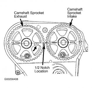

i just replaced the timing belt on a 2.4l dodge caravan. the belt snapped and now after installing the belt it idles a little bit but when you press the accelerator it sounds like a misfire.
i checked the timing several times and its good. all the marks line up perfectly.
i also checked for compression and its 170-180lbs on all pistons.
i also checked the coil pack and even went as far as replacing it with a good one. replaced the plugs and wires.
i have checked the gas flow and have good pressure up to the rail.
now i am stumped on what to look for next.

suspect cam off recheck it ,done it many times
https://images.2carpros.com/forum/automotive_pictures/99387_1_32.jpg

after the timing belt tensioner is released should the marks look like the picture? or is that before the tensioner is released.
Oct 17, 2010 at 9:29 PM
BMRFIXIT
  • 19,053 POSTS
after
notice 1/2 notch
turn engine by hand full turn and recheck
