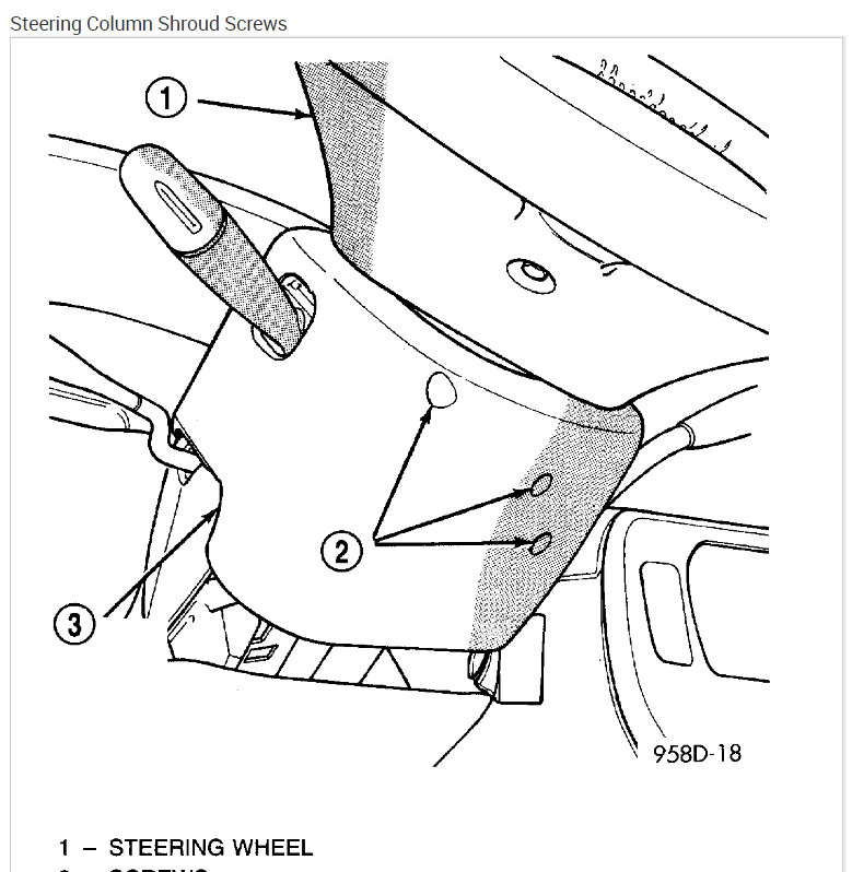

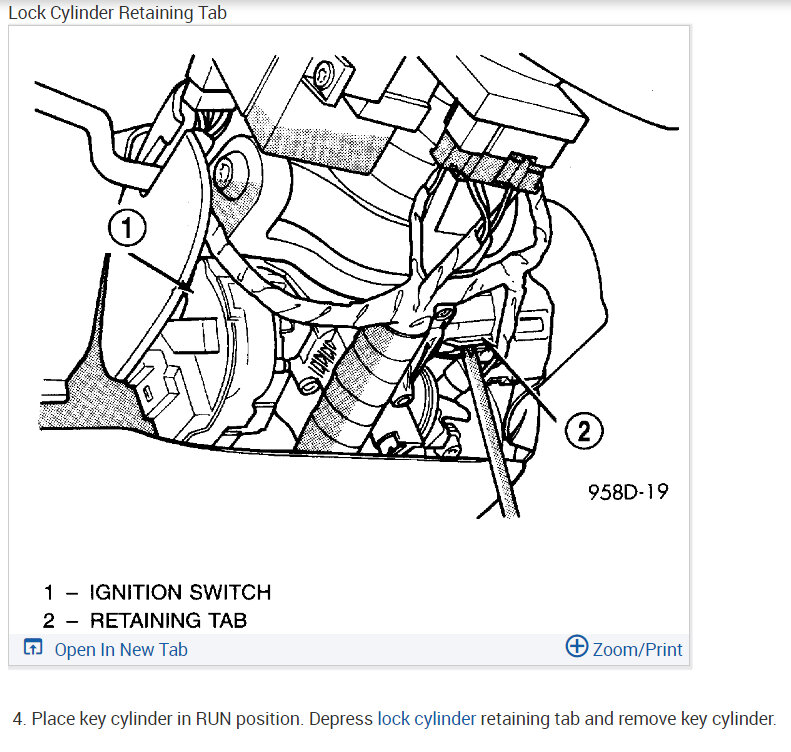

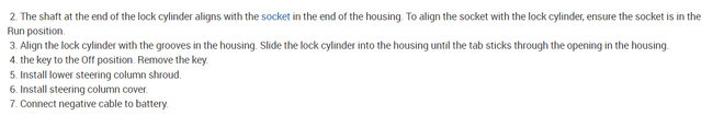

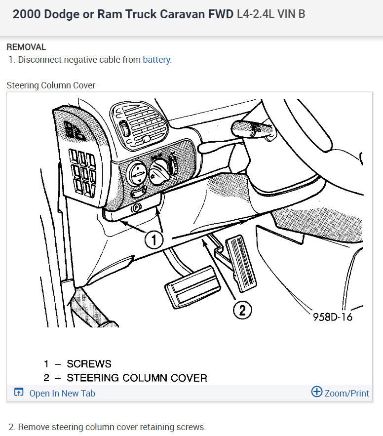

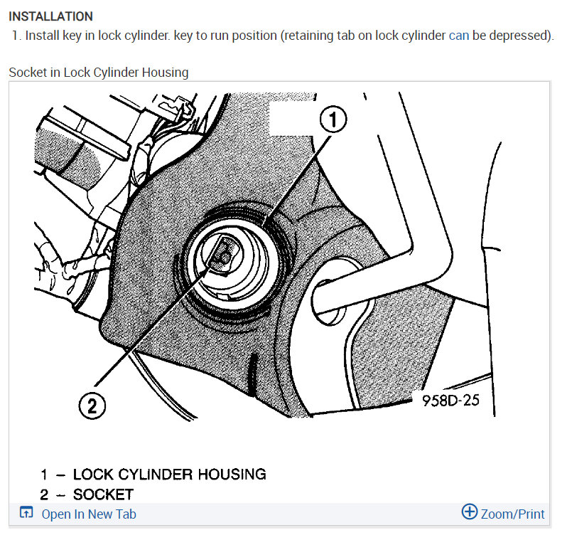

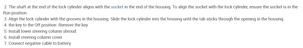

Yep, here is a guide that can show you how to fix it with a hammer. Sounds strange but it works.
https://www.2carpros.com/articles/ignition-switch-wont-turn-stuck
If not you will need to replace the ignition switch which I have included in the images below. Check out the images (below). Let us know what you find.
