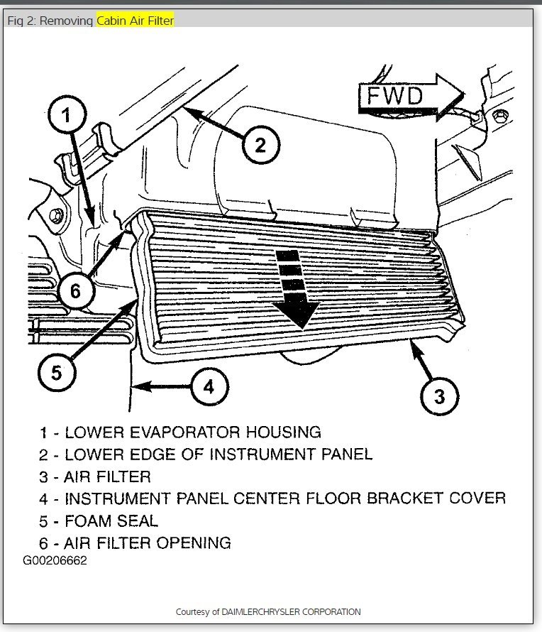

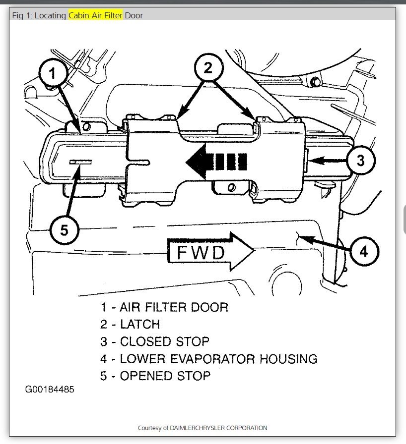

I'm having a hard time finding the location of the air cabin filter in my 2000 dodge grand caravan. Do you guys have any ideas where it is?
I bought the filter and it says its in the passenger side under the glove compartment. There is something I need to pull out. There is nothing for me to pull out. I only see hex screws. Please help. Thanks.

Not all cars and models comes equipped with cabin filter but if it does this what it would look like (below)
Here is a guide that will give you an idea how how to do the job.
https://www.2carpros.com/articles/how-to-change-an-air-cabin-filter
Open/remove glove box and take a pic and send it what you sent suggest that you do not have one. Locate the air filter door on the bottom of the lower evaporator housing just outboard of the passenger side of the instrument panel center stack. Slide the air filter door latch toward the rear of the vehicle until it engages the opened stop on the door. Pull the air filter door latch straight downward to disengage it from the air filter opening of the lower evaporator housing. Use your fingers to reach through the air filter opening of the lower evaporator housing far enough to grasp the air filter. Pull the air filter straight down and out of the evaporator housing.
