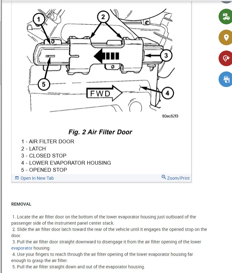

Where is the cabin air filter located?
2003 DODGE CARAVAN
60,657 MILES • 6 CYL • 2WD • AUTOMATIC
JOAQUINPECH

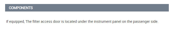

Cabin air filter is location needed.
Mar 25, 2010 at 12:19 PM

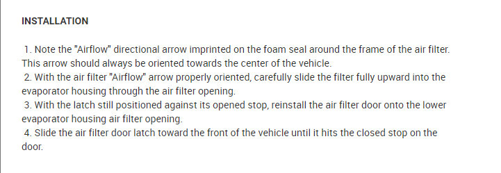

Take a look at this info attached. However, here is a guide that will help with this as well since these manuals are not incredibility detailed so this will help:
https://www.2carpros.com/articles/how-to-change-an-air-cabin-filter
Below you will find the process from the manual that will provide the specific detail that you need to replace this. This includes the location information as well.
