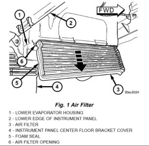

Hi, I have been trying to locate the cabin filter but to no avail. Had seen the diagram posted on 2CarPros, however, I still cannot figure where is the filter.
Can anyone there help me? Possible to provide a photo on the location. Thanks
Sep 20, 2009 at 7:21 PM
  • 54,837 POSTS

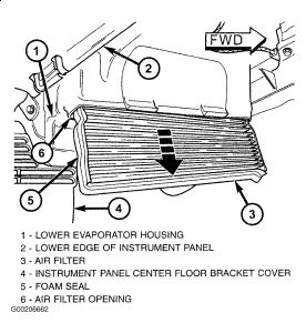

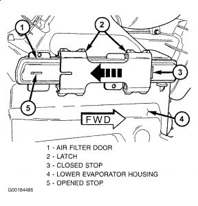

Hello, Not all of these cars came equipped with cabin air filter, FYI. 1. Locate the air filter door on the bottom of the lower evaporator housing just outboard of the passenger side of the instrument panel center stack. 2. Slide the air filter door latch toward the rear of the vehicle until it engages the opened stop on the door. 3. Pull the air filter door latch straight downward to disengage it from the air filter opening of the lower evaporator housing. 4. Use your fingers to reach through the air filter opening of the lower evaporator housing far enough to grasp the air filter. 5. Pull the air filter straight down and out of the evaporator housing.
https://images.2carpros.com/forum/automotive_pictures/99387_Graphic1_511.jpg
https://images.2carpros.com/forum/automotive_pictures/99387_Graphic2_251.jpg
Here is a guide to show you what you are in for when changing the cabin air filter: https://www.2carpros.com/articles/how-to-change-an-air-cabin-filter Here are some diagrams (below). Please let us know if you need anything else to get the problem fixed. Cheers, Ken

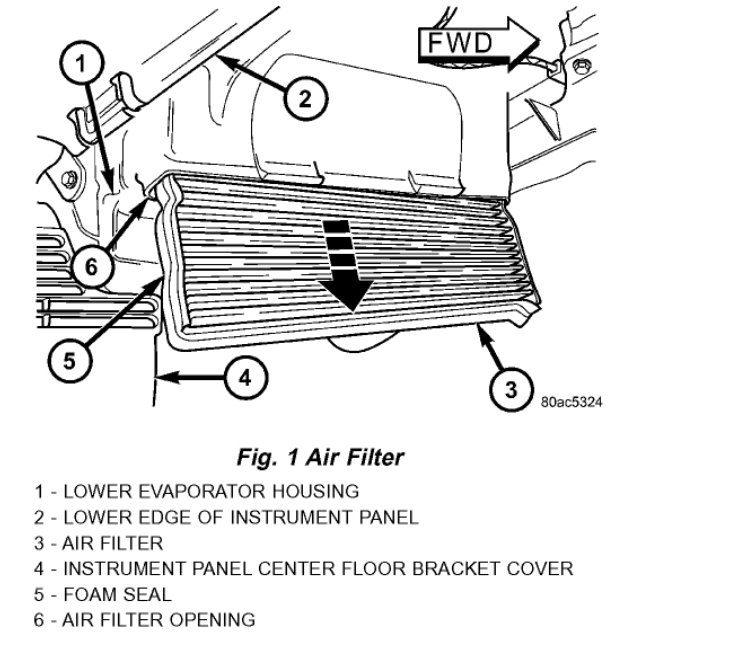

  • 75,992 POSTS
Fig.1 air filter
https://images.2carpros.com/forum/automotive_pictures/12900_caf_2.jpg
The cabin air filter access door is located under the instrument panel on the passenger side. https://www.2carpros.com/kpages/auto_repair_manuals_alldata.htm

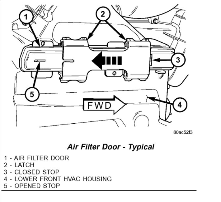

where do i find and how do i access the cabin air filter for this vehicle
Jul 20, 2018 at 7:16 PM (Merged)
Locate the air filter door on the bottom of the lower front HVAC housing just outboard of the passenger side of the instrument panel center stack.
Pull the air filter door straight downward to disengage it from the air filter opening of the HVAC housing.
Use your fingers to reach through the air filter opening of the HVAC housing far enough to grasp the air filter.
Pull the air filter straight down and out of the HVAC housing.
Installation:
Note: The particulate air filter is labeled with "Airflow" and an arrow to indicate air flow direction through the filter. This arrow should always be oriented towards the center of the vehicle. Make sure to properly install the particulate air filter. Failure to properly install the filter will result in the need to replace the filter sooner than required by design.
Install the filter fully upward into the HVAC housing through the air filter opening with the "Airflow" arrow oriented towards the center of the vehicle.
With the latch still positioned against its opened stop, install the air filter door onto the lower HVAC housing air filter opening.
Slide the air filter door latch toward the front of the vehicle until it contacts the closed stop on the door.
