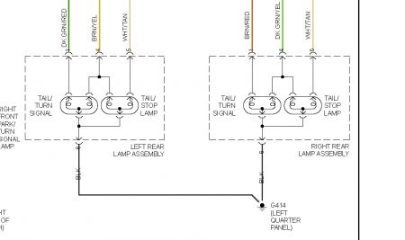

2000 Dodge Caravan 4 cyl Four Wheel Drive Automatic
Car has 29,500 miles. Senior citizen:
Left turn signal did not work No clicking no bulbs lighted -up. Right signal functioning well.
I immediately drove to the dealer and when he tried the signal lights; they both functioned well. Driving home the left signal failed and then worked for the next ten left turns. Four years ago this same incident occurred
and has been working well until yesterday.
NOTE Current incident was Nov, 3,2010
Lights are working well and both signal lights are fine and functioning

Check for voltage and ground at the wiring colors, when problem is ongoing. Where applicable, maybe the bulb doesn't fit well in the socket. Problem with socket itself. Dark green wire with red tracer is voltage for left turn, black wire is ground. Sounds like a bad connection, somewhere.
https://www.2carpros.com/forum/automotive_pictures/170934_caravan_turn_signal_1.jpg
