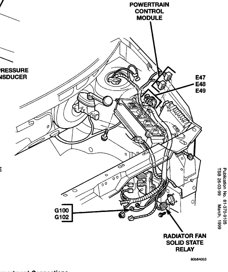

I have determined that the radiator fans are inoperative due to failure of the radiator fans relay. I cannot locate the radiator fans relay under the hood. The radiator fans 40A fuse is located in the fuse/relay box above and to the right of the battery. Where is the radiator fans relay located?
Jun 10, 2010 at 5:14 AM
DOCFIXIT
  • 18,828 POSTS
There is not a relay this system uses a controller which is up by the fans on the drivers side. Here is the location in the diagrams below. Check out the diagrams (below). Please let us know if you need anything else to get the problem fixed.

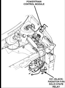

Cooling fan keeps running after vehicle turned off. Needs new relay plug but unable to find location on frame for ground so it can be replaced. Where is it? Thanks for the help.
Jul 15, 2018 at 7:12 AM (Merged)
  • 75,992 POSTS
The radiator fan relay its at front left frame rail. See below.

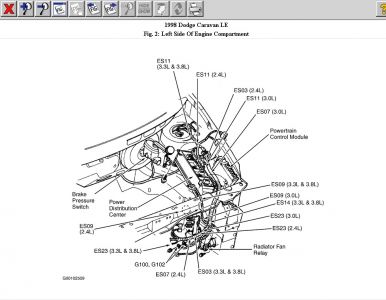

CARADIODOC
  • 34,367 POSTS
It's an unnecessarily complicated module on the core support, next to the left side of the radiator, half way down. It must be bolted on to dissipate heat. It will get hot enough to burn your hand, and it will self destruct if allowed to overheat.
This module is used to vary the fan speed for various conditions. It is slowed down to prevent complaints of excessive fan noise. A lot of expense and unreliability to quiet a little noise.

VJHILL

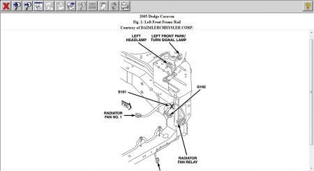

Where is the cooling (radiator) fan relay on a 1998 Dodge Grand Caravan?
Nov 26, 2018 at 3:24 AM (Merged)

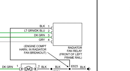

  • 75,992 POSTS
Cooling Fan Relay Location Radiator Fan Relay Mounted On Left Front Frame Rail

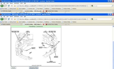

Could you please tell me where the radiator cooling fan relay is located?
  • 75,992 POSTS
Check fuse no.4 40amp also see below for relay location

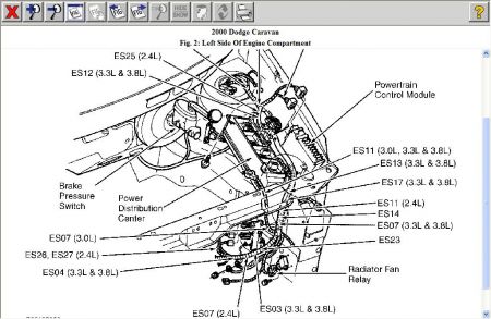

yah i got same problem suddenly 2000! i LIKE that last CLOSEUP PIC!! but my question is can it be BYPASSED or where do you buy it!?
Jul 13, 2019 at 1:24 PM
FIXITMR
  • 9,990 POSTS
OUCH my 2000 grandvan sport relay NOT where indicated!!

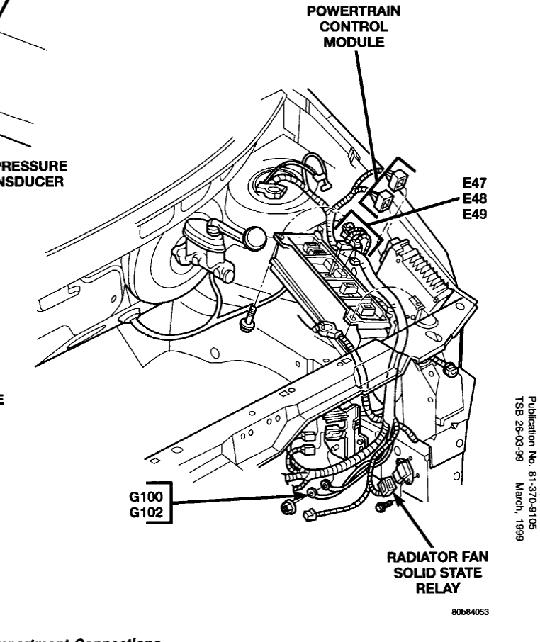

where is the cooling fan relay located
Jul 14, 2019 at 5:17 AM (Merged)
SATURNTECH9
  • 30,869 POSTS
https://images.2carpros.com/forum/automotive_pictures/416332_2006_dodge_caravan_cooling_fan_relay_part2_1.jpg
There you go.

  • 75,992 POSTS
Its at top left front frame rail
