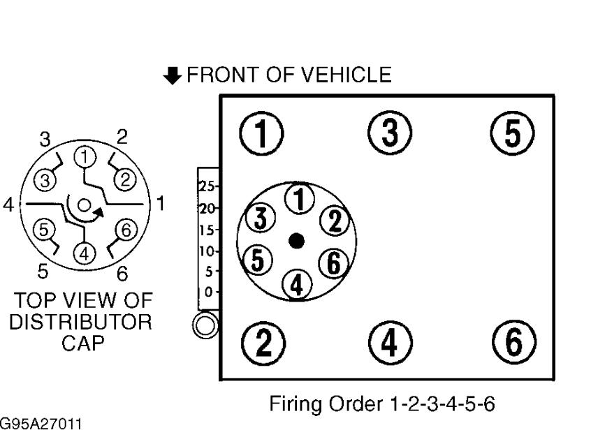

My van come up with a code for misfire at #4 cylinder. I just replaced the spark plugs about 1000 miles ago. Could it be a bad plug or probaly the wires? Which hole is the #4 cylinder?
Thanks,
MIke
Apr 26, 2020 at 5:49 AM (Merged)
MHPAUTOS
  • 31,937 POSTS
Hi there, see pic for firing order 3 litre engine.
https://images.2carpros.com/forum/automotive_pictures/61395_Graphic_153.jpg
mark (mhpautos)

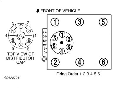

U0444875
1989 Dodge Caravan
I took off the spark plug wires and numbered them and when I put them back on the car will not start. Can you please give me the proper configuration. Thanks.
Apr 26, 2020 at 5:50 AM (Merged)
  • 75,992 POSTS
What liter engine? Maybe we can help you out.
U0444875
The engine is a 3 liter V6. We just need a diagram of the spark plug wires. Also the fan belt is torn to shreds. I found a piece of it in the grill, and the fan is not turning. Would that cause the car not to start and is it hard to put on and what tools would you need.
Thanks so much for your help.

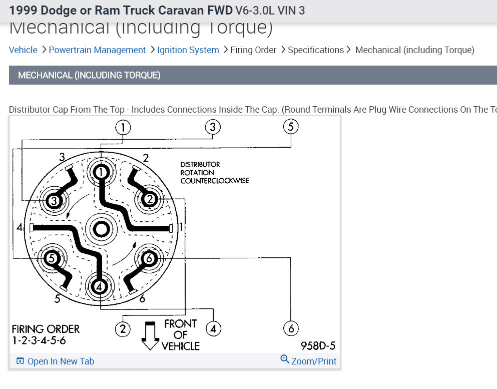

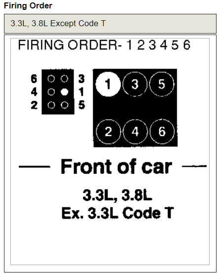

#5 fuel injector is stopped up how do i fix it. Do you have a firing order diagram for 3.3 v6 dodge caravan.
Jun 19, 2020 at 6:09 AM (Merged)
MHPAUTOS
  • 31,937 POSTS
The Injector can be bench tested and cleaned or it can be done on car as well, it car is hooked up to a special fuel system cleaner, if done off car all injectors should be cleaned and flow tested. you can also replace it if you wish, see pic for firing order.
