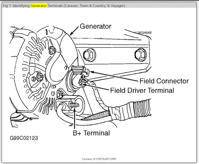

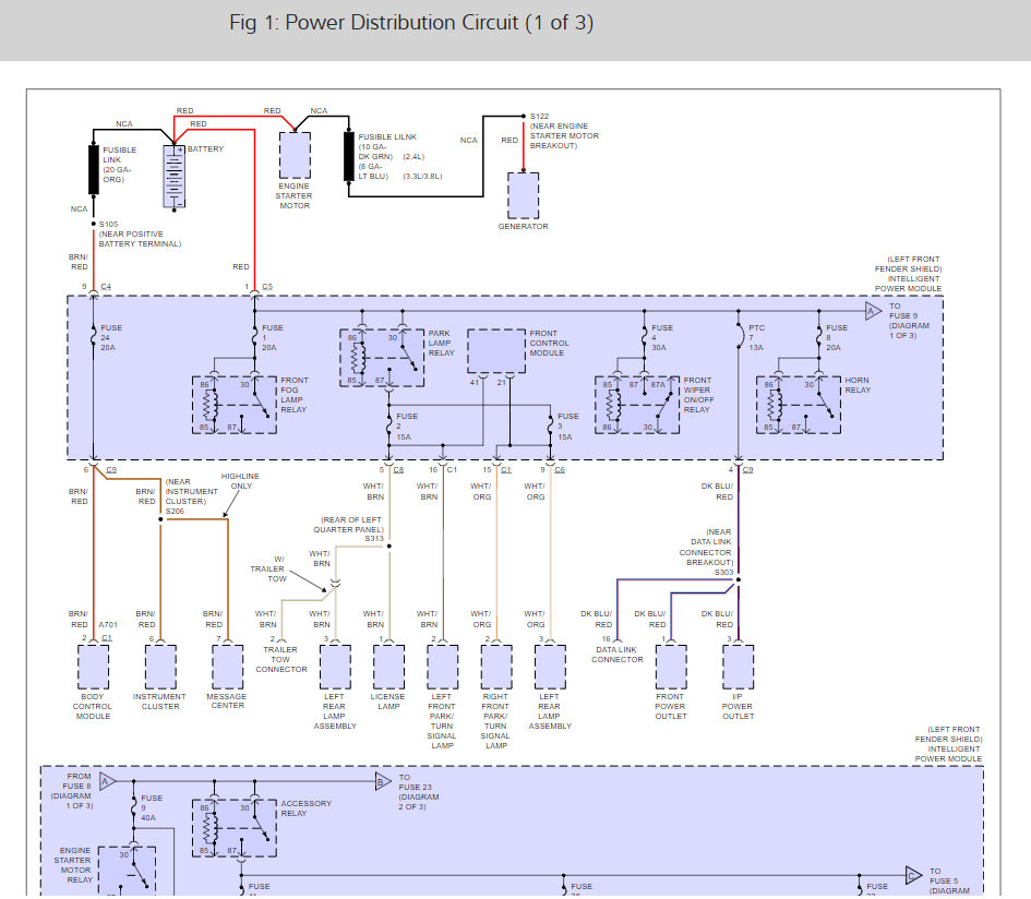

The alternator went out on my Dad's 99 Caravan. After driving it around for a 2 days he finally brought it to me to replace the alternator, after replacing the alternator and charging the battery on trickle charge for 12 hours he was good to go or so I thought. He went 4 blocks and the engine fuse blew, I replaced it and brought it back to my house, checked all the wires on the alternator and everything looks good, checked the voltage at the battery and I am only getting 13.5 with the van running, any ideas as to why it is blowing the engine fuse? It is a 20amp fuse located in the panel under the hood. I think it might also be called an ignition fuse on some consoles this one is called an engine fuse. Thank you.
Jul 9, 2010 at 12:54 AM

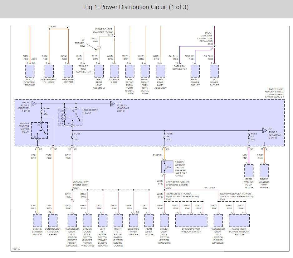

INTERNETMECHANIC
  • 700 POSTS

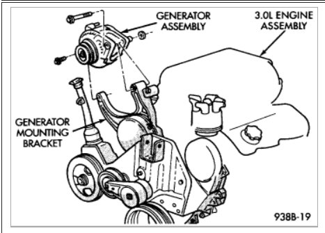

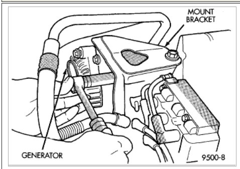

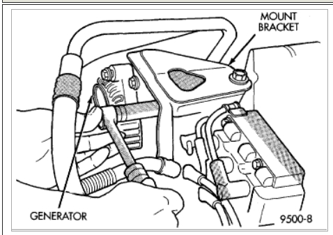

It sounds like you have a defective alternator which you can see from this wiring diagram (below) I would remove the alternator and install an different unit AC Delco work really well.

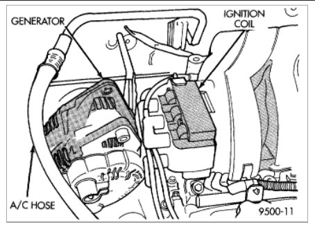

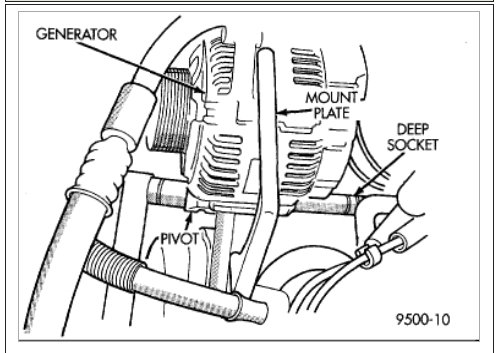

Here is a guide to show you what you are in for when doing the job.
https://www.2carpros.com/articles/how-to-replace-an-alternator

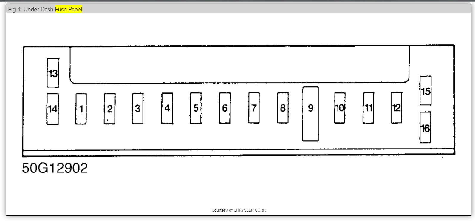

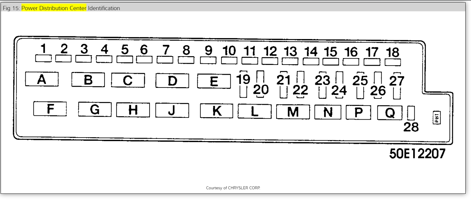

Here is how is will be like on your car (below) And we have the fuse panel diagrams as well.
Please run some tests and get back to us.
Cheers

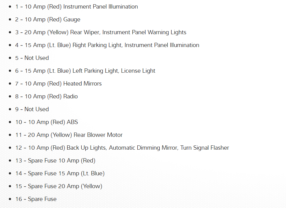

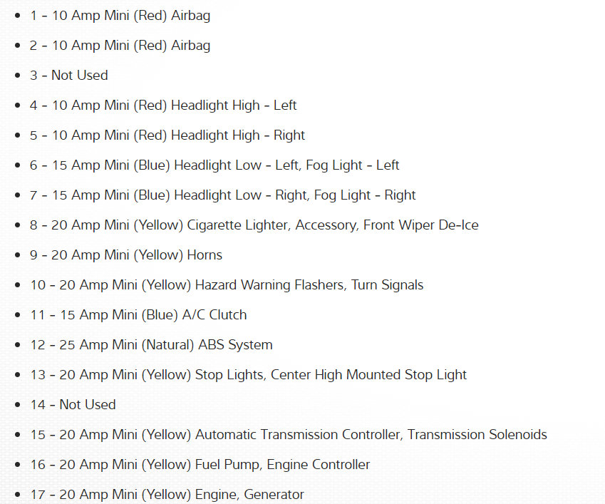

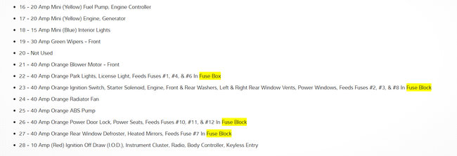

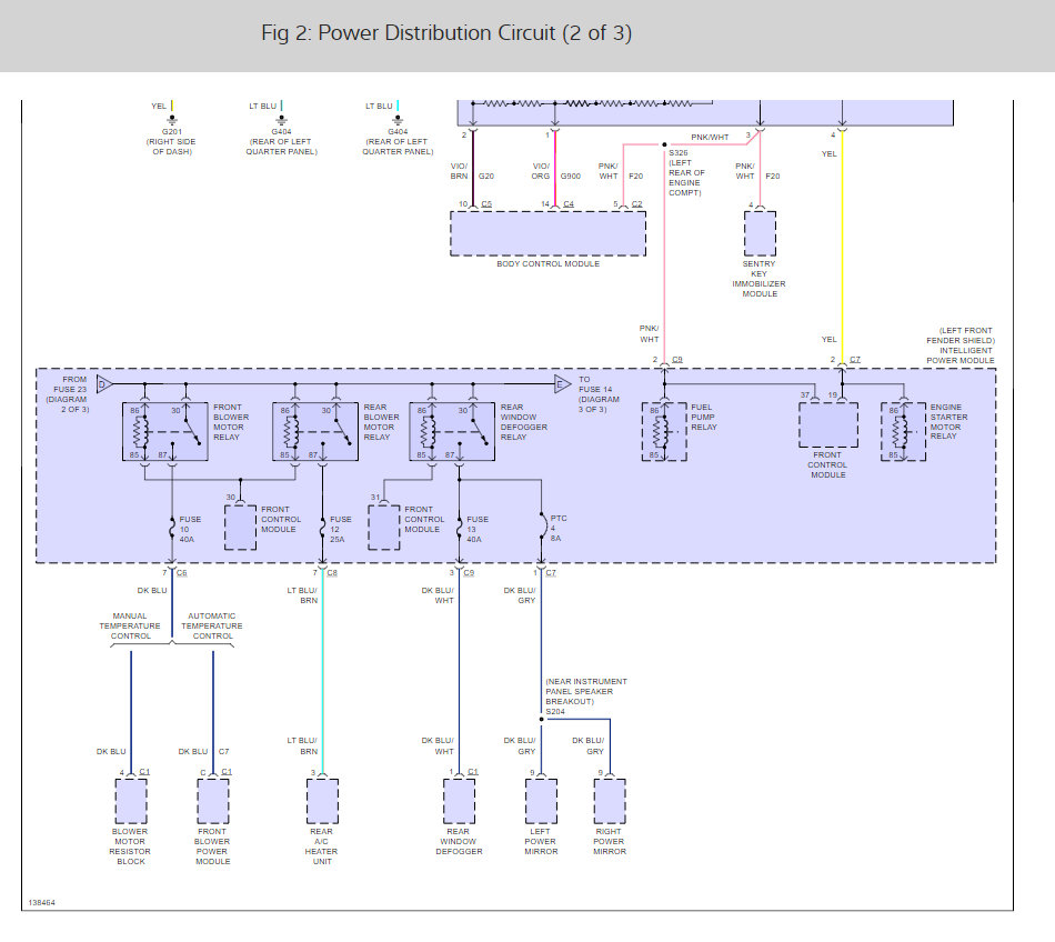

Starting at the end with the 10 amp memory fuse, the first fuse is a 15 amp fuse, then a 20 amp fuse, that 20 amp fuse next to the 15 amp is the one. Another way for me to describe it is from the bottom of the picture, it would be the second fuse from the bottom on the far right of the picture, the mini fuses. Finally I changed out the alternator and you where right the problem is gone. You people are so smart! I love this site.

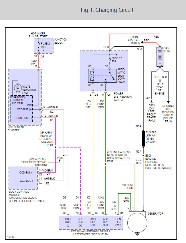

When I try to start my 1996 dodge grand caravan, the 25 amp engine fuse in the PCM blows right away while I'm still cranking the engine. What should I check?
Nov 30, 2017 at 5:04 AM (Merged)
CARADIODOC
  • 34,383 POSTS
To prevent wasting fuses, use a pair of spade terminals plugged into the fuse socket, and a pair of jumper wires to connect them to a 12 volt light bulb. When you crank the engine, the automatic shutdown relay will turn on and the short will make the bulb get full brightness. It will also turn on for one second after turning on the ignition switch before you start cranking the engine. Now you can unplug things that are on that circuit to see which one makes the light go dim or out, indicating you removed the short from the circuit.
Depending which engine you have, disconnect the ignition coil or unplug the coil pack first. The next, and most likely suspect is wiring to one of the oxygen sensors fell down onto hot exhaust parts, melted, and shorted the internal heater wire ground. The alternator field and injectors are on that circuit too. The fuel pump should be on a different relay but powered through the ASD relay too. Unplug the fuel pump relay to isolate the pump.

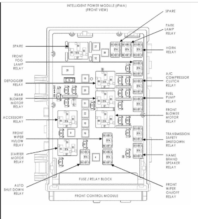

0851WALTER

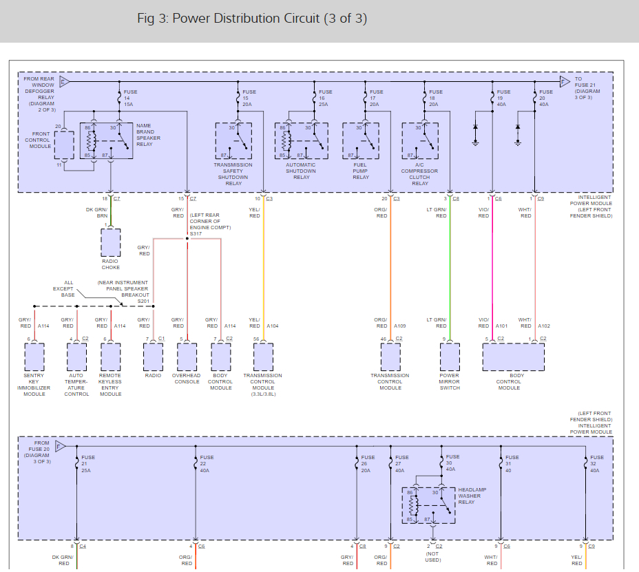

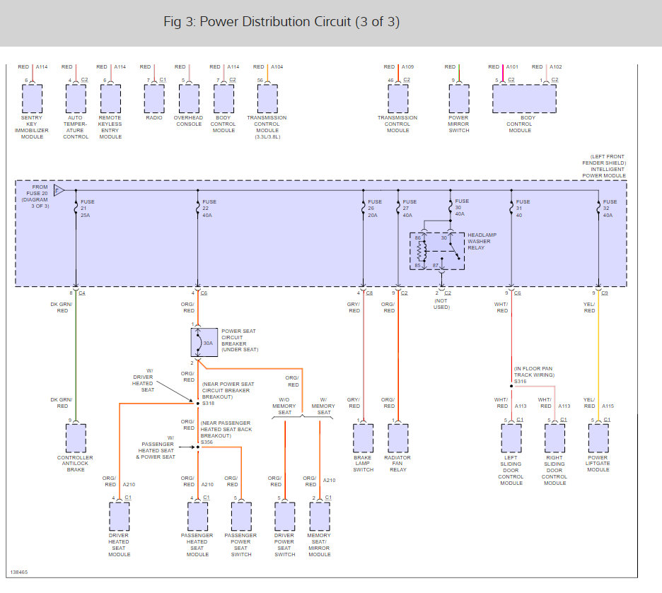

The IPM diagram shows something it terms as a spare relay. It occupies a position close to the firewall, and if you lift the IPM, you can see that it is also the location closest to the 12 volt main feed input cable.
If it were a spare in the conventional terms, it would not control anything, or be fed power. This one is. It does not show up on my factory service manual in any diagram.
Anyone know what it is there for, what it controls, and a pinout (other than the 12 volt feed).
Thanks
CARADIODOC
  • 34,383 POSTS
Pop its cover off, reinstall it that way, then squeeze the contact to see what turns on. It could be a dealer-installed option. Another way to bypass it is to jump terminals 30 and 87 together with a stretched-out paper clip or piece of wire.

  • 55,433 POSTS

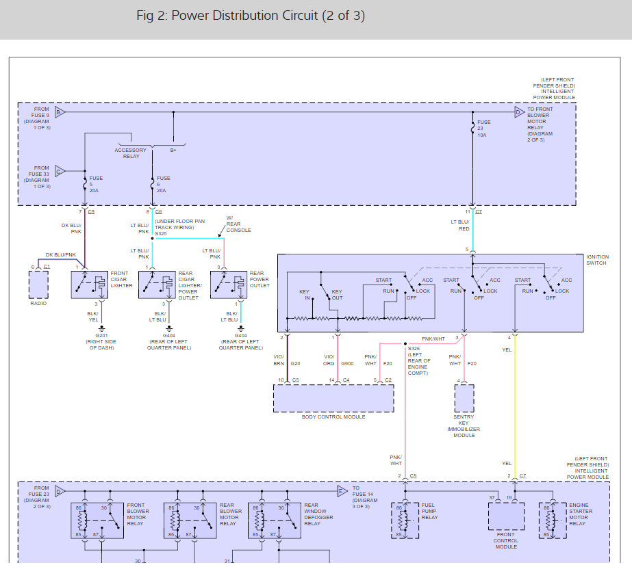

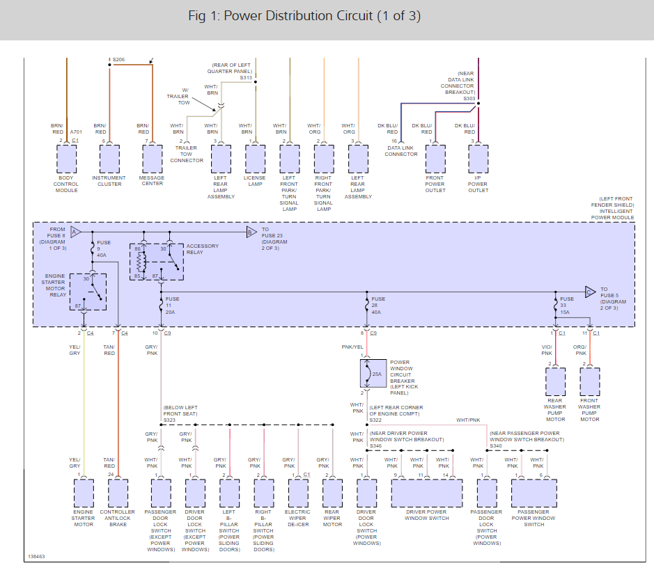

Here is the IPMA diagram and the wiring diagrams that go with it so we can find out what the extra relay does.
