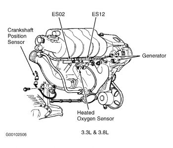

I have a '96 dodge caravan NOT grand. It's a 3.3 liter engine Automatic.
As I was on a normal drive, the van Quit on me with no' warning. I checked many things along the road to find out that there is No spark going to the spark plugs. Not' a gradual problem. It happened instantly. It does Not make a wizzing sound like it's the timing belt. I was told one of two problems might have occured? 1. The electronic block (distributor) that the spark plug wires plug into is shot, and I need a new one of those. OR, 2. It's a "CAM Sensor" that went bad. To make it an "instant" problem. Has anyone had a simular experience and final If in agreement. Can you tell me Where' this "cam sensor" might be located? Help Please. Gary

Check fuses and ASD relay
check and or replace crank sensor
at the tranny bell housing
https://www.2carpros.com/forum/automotive_pictures/99387_caravan_crank_sensor_1.jpg
