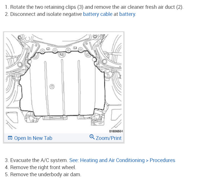

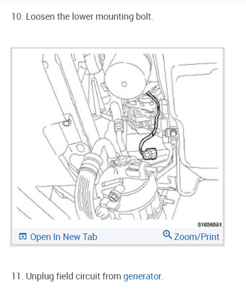

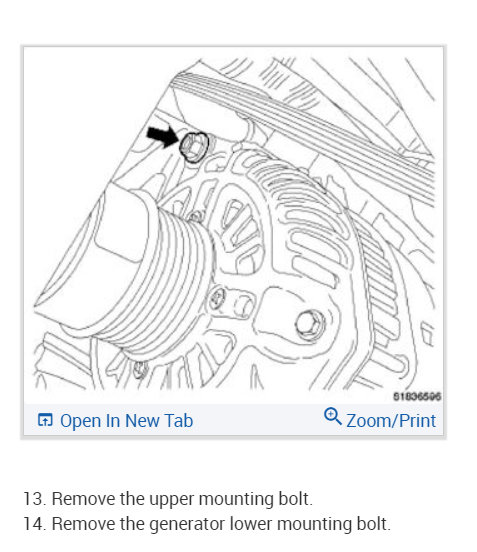

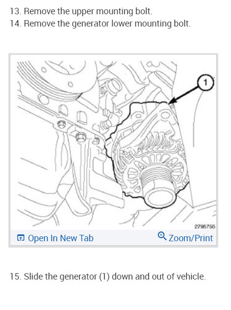

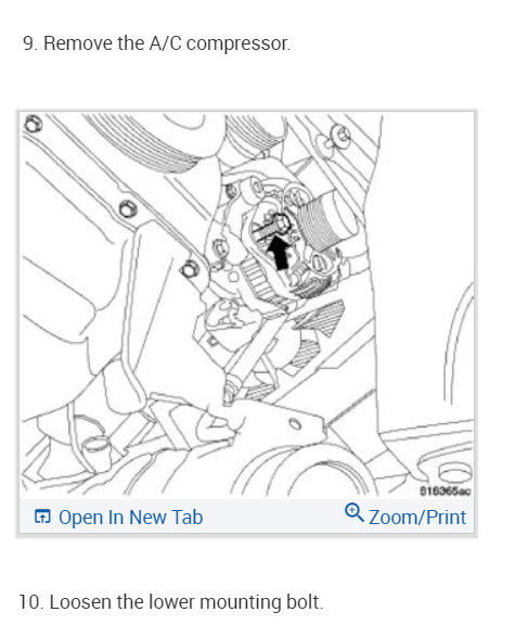

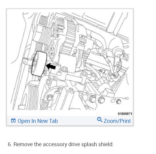

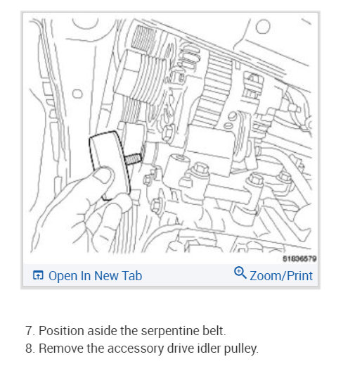

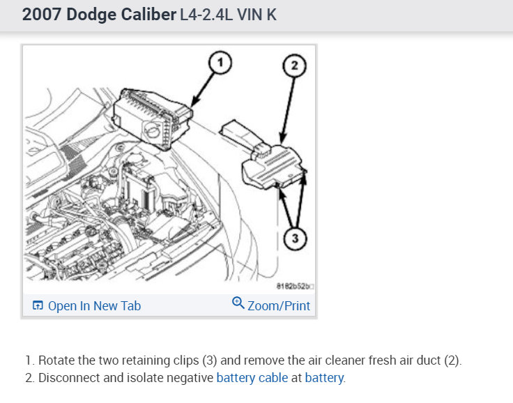

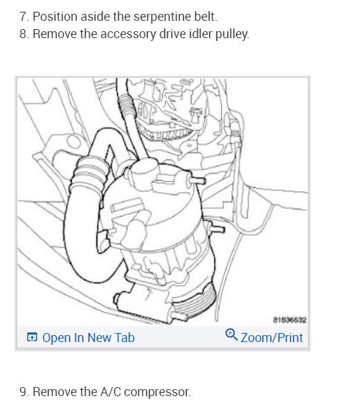

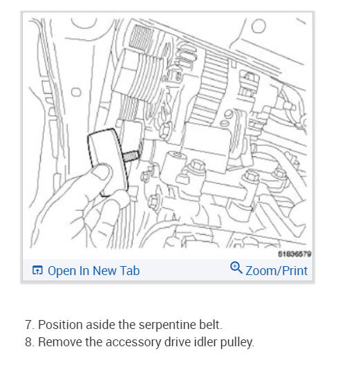

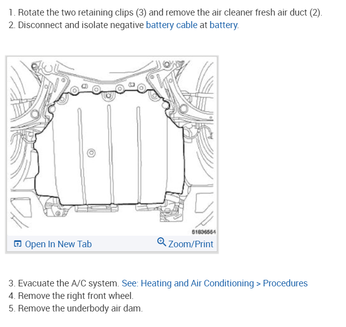

Disconnect the battery, remove the serpentine belt, unplug the wiring behind the alternator, then just unbolt the alternator from the brackets. This guide will walk you through the steps with instructions in the diagrams below to show you how on your car.
https://www.2carpros.com/articles/how-to-replace-an-alternator

They are hard to replace because of space. Before replacing it, recharge the battery and drive it to a nationally recognized parts store and have them test the alternator on the car.
Let me know what you find.
