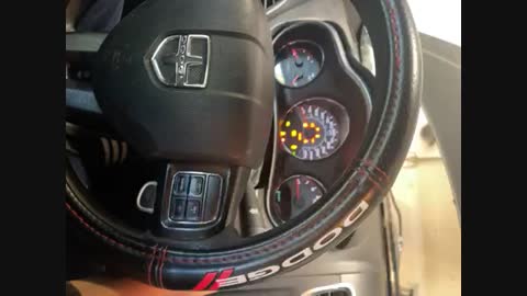

I bought an aftermarket radio then realized I needed a wiring harness, ordered it and had my cousin attempt to install it. he blew the radio fuse out radio in the car. I got a new one and tried myself I hooked everything up and got power to the screen but no audio at all I tried hooking the power antenna into the emergency light power after seeing a YouTube video and as I finished, I moved the radio and my car shut off, like my engine shut off but my lights and horn work. I’m very confused I’m going to try to jump the car in the morning but as of now it won’t even attempt to turn.

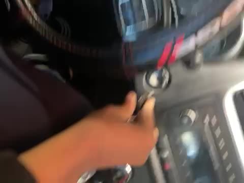

I reinstalled the factory radio and tried to jump start it this morning and it didn’t work so I went and bought a code reader, but it doesn’t look like any power is coming to it. when I turn the car on only the battery and check engine warning light is on. what’s my next step?

The theft light appears to go out but when you say there is no power going to the tool does that mean it will not turn on?
Can you get another video of what happens when you are trying to start the engine?

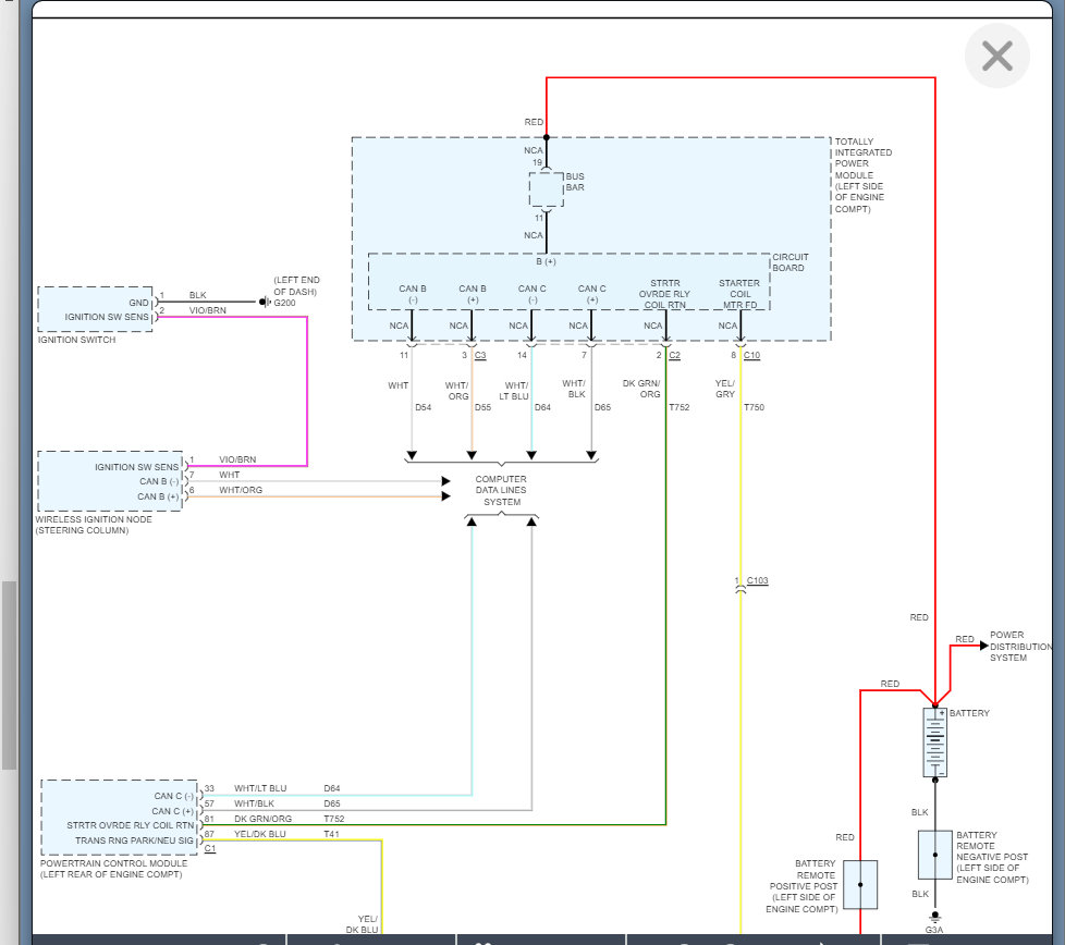

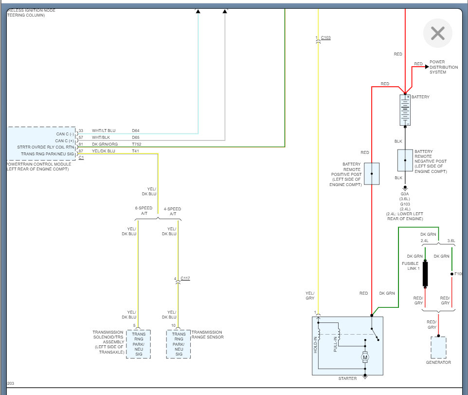

The next thing we will have to do is start checking for power leaving the TIPM going to the starter.
The most likely thing here is the TIPM has failed but we need to do a little more before we can conclude this.

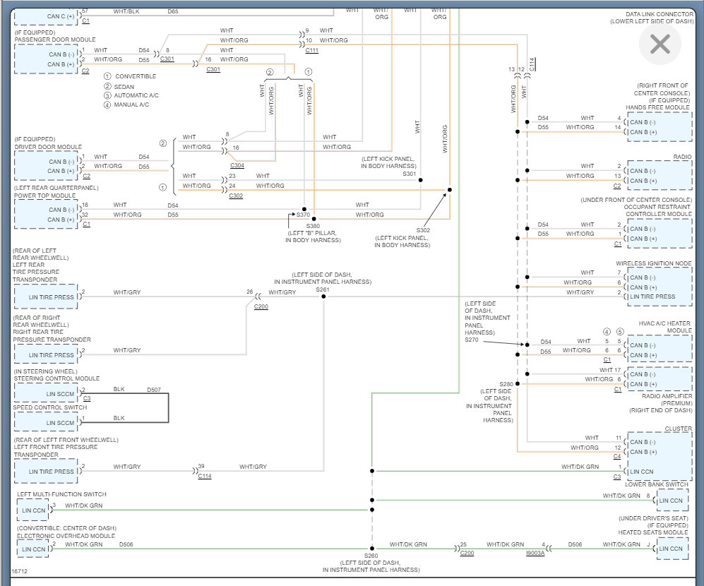

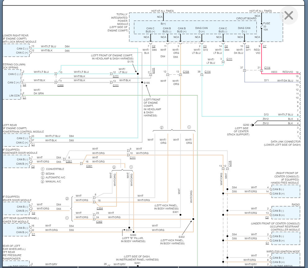

I attached the wiring diagrams below.

The only way the reader will not have power is there is no power going to the connector under the dash or there is a ground issue.
So, we need to use the diagram above and check the power on pin 16 using the grounds on pin 4 and then 5.
If the meter reads 12 volts using both grounds, then the issue is with the code reader.
