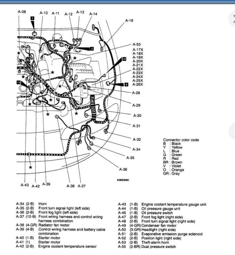

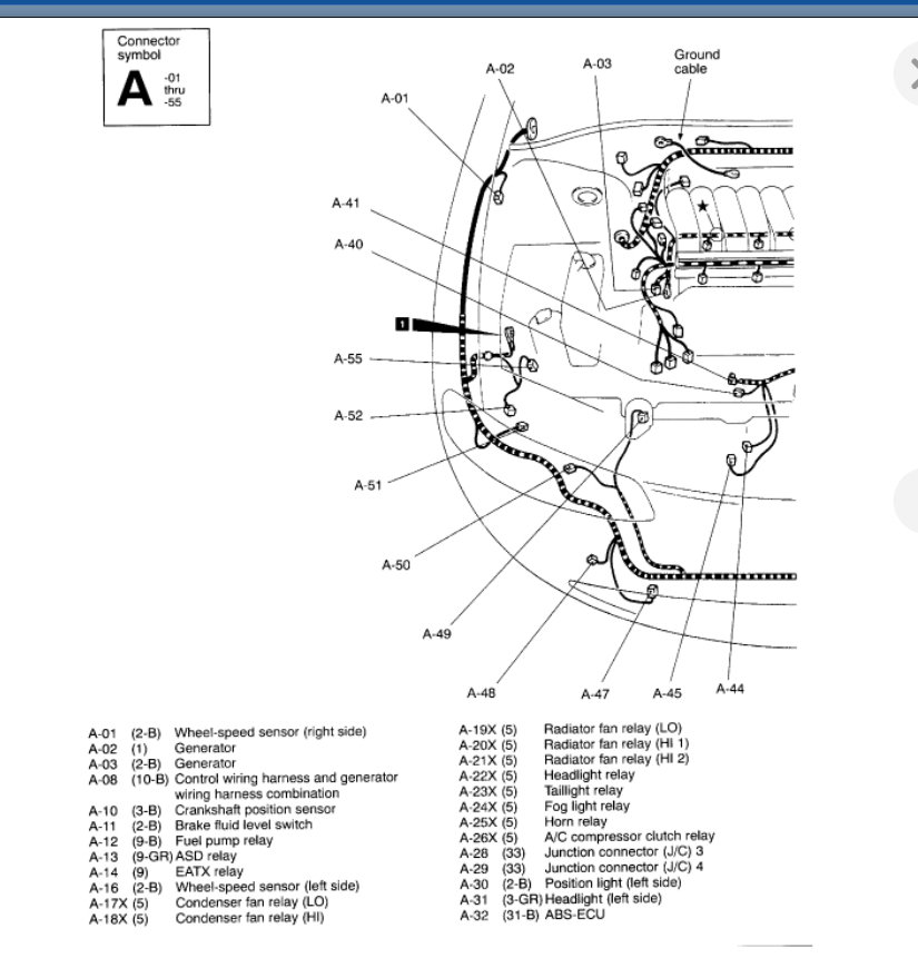

I have a sensor unplugged that is throwing the computer off and causing it to shut off and not wanna crank for awhile. It is located right behind the upper intake manifold. I do not know the name of it or where the end is located to plug into it and need help with that

Can you get a picture of this sensor that you have unplugged, and I am sure we can help locate it?
One easy way to tell what this is if it is unplugged is to check the codes because you are going to have an open circuit or other sensor code for this that is unplugged.
I am also attaching an engine compartment view which will help determine what this may be.
Please run through this and let us know what questions you have.
