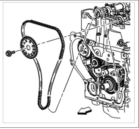

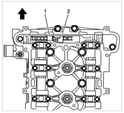

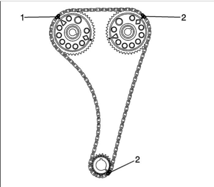

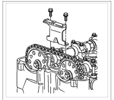

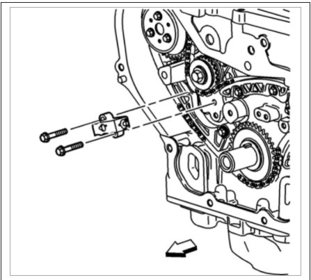

Need to determine if at 107,000 miles it is necessary to replace timing chain?
Mar 18, 2018 at 7:54 AM

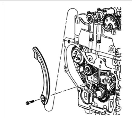

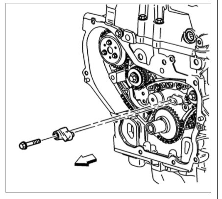

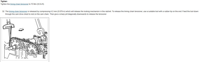

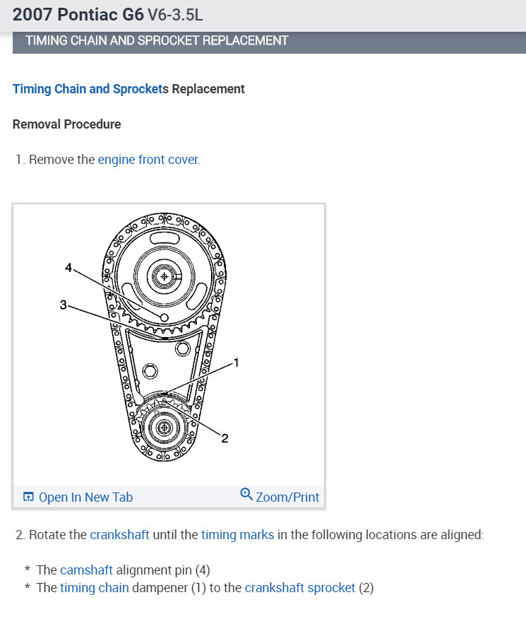

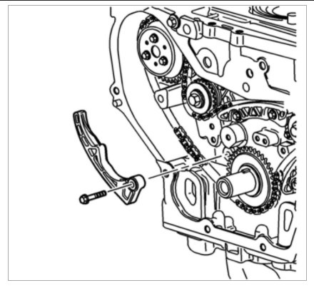

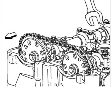

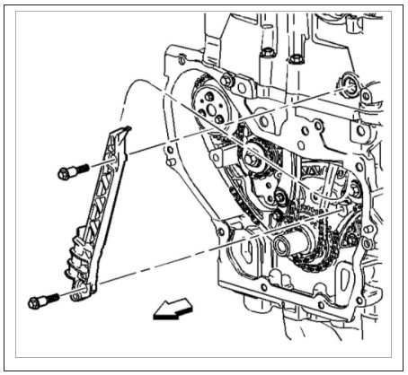

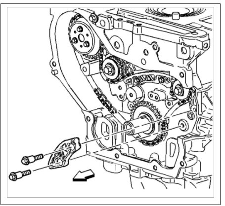

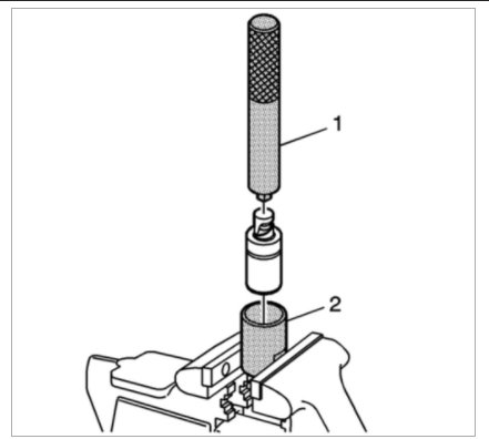

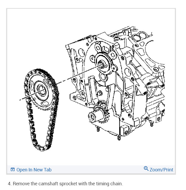

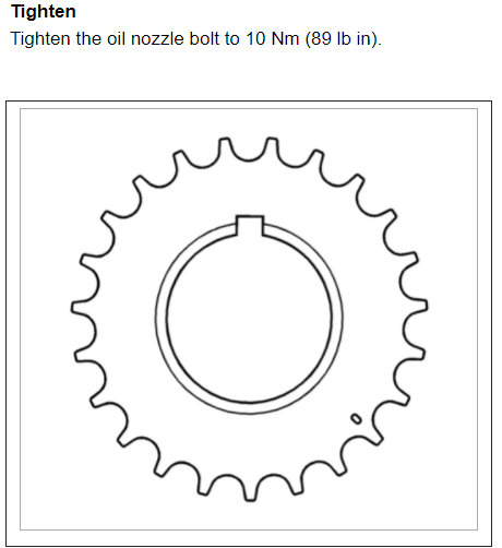

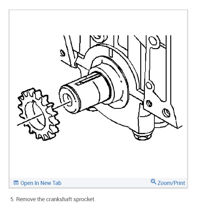

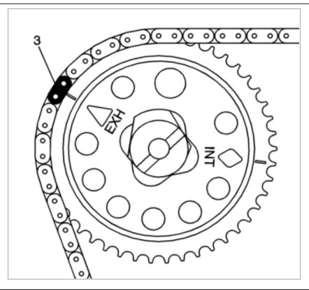

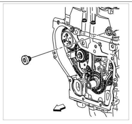

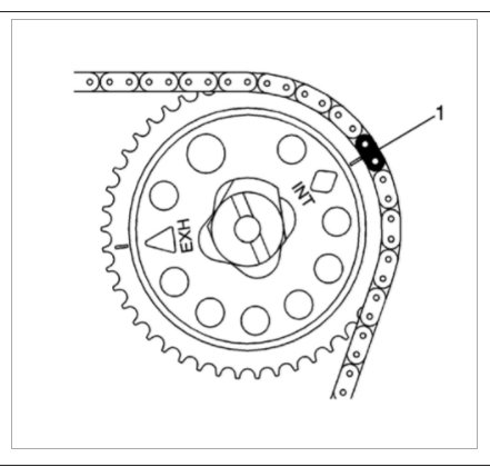

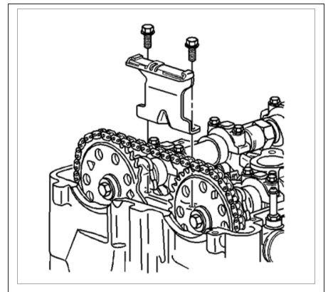

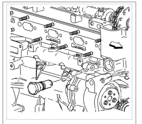

I attached the procedure for you of the timing chain. There is a good YouTube video of this procedure that is much better than the pictures in the manuals.
https://www.youtube.com/watch?v=wAjmR6PSCf8
Let me know if you have any other questions.

Good morning,
What engine size do you have? There are 4 possibilities for engines. I want to be sure you get the correct information.
Yes, it is a very involved job due to the risk of bending valves if the timing is incorrect.
https://www.2carpros.com/articles/how-a-timing-belt-works
Did your chain fail or is this basic maintenance?

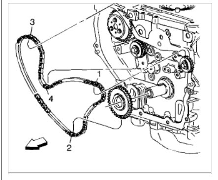

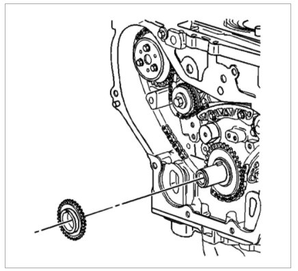

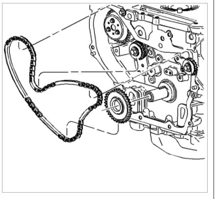

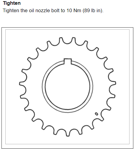

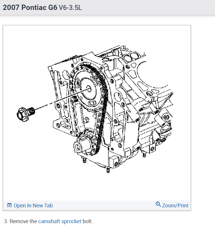

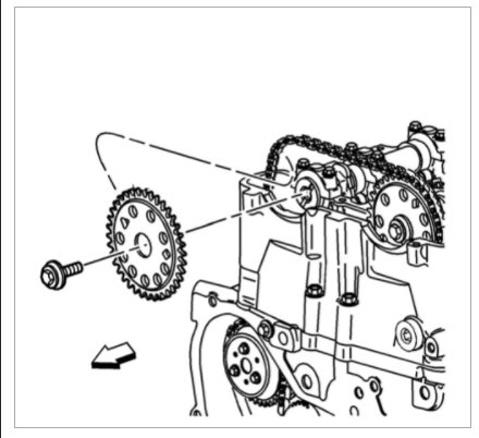

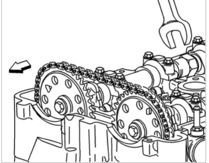

Failures are not planned or predictable but as a rule of thumb that typically last about 130,000 miles. Here is howe the chain is replaced in the diagrams below for both 4 and 6 cylinder engines. Check out the diagrams (Below). Please let us know if you need anything else to get the problem fixed.
