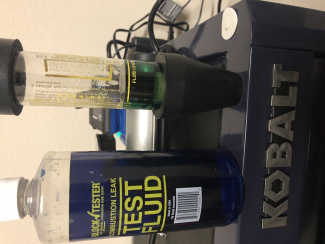

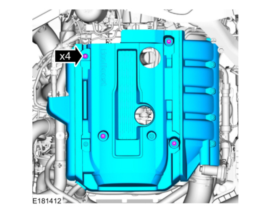

I have recently been seeing white smoke come out of my exhaust when I start my car in the morning. It is garage-kept. The car has been well maintained. I have a tune on it as well as an aftermarket cold air intake.
Due to the smoke, I purchased one of those chemical head gasket leak testers where the fluid will turn from blue to yellow if you have exhaust gasses in the coolant reservoir. My result is in the image below. It isn't yellow, but it isn't blue either.
I was going to buy a gas analyzer to test for hydrocarbons, but they are $1,000.00+. What is my best bet here? Do you think I have a head gasket leak with a car so new?
I doubt Ford would warranty it due to the tune on it.
If you think I need a replacement gasket, can you link to how to preform the DIY for the 2018 mustang ecoboost? Can't find any videos on it.

Just a question first. Have you been noticing a loss of coolant? Do you have to keep adding to the overflow or radiator? Here is a tutorial about white smoke:
That looks like a positive test, but I also noticed the fluid is above the fill line. Any coolant in the test will contaminate it
Does it run rough at all when cold started?
Any overheating?
Does it blow coolant into the overflow when warmed up?
Do you notice excessive cooling system pressure when its fully warmed up? (Upper hose swelling)

No loss of coolant is noticed. Just the white smoke and the chemical test. I did check the coolant reservoir and it had some sandy stuff in it. I read that could be due to poor flushing process from manufacturing? I think that is unrelated.

Just to jump in. I have seen this a number of times when the fluid does not change from blue to yellow but green instead. However, if you go back to 1st grade, blue and yellow make green so this means you have a small leak in the head gasket that is only allowing a small amount of hydrocarbons into the coolant.
Here is a guide that talks about this:
Also, here is a guide that talks about the white smoke:

Good evening,
I attached the procedure and pictures for you of the process for replacing the head gasket.
I would have a leak down test done to confirm to be sure it is the issue.
303-01A Engine - 2.3L EcoBoost (231kW/314PS) 2018 Mustang
Removal and Installation
Cylinder Head
Base Part Number: 6051
Special Tool(s) / General Equipment
Oil Drain Equipment
Hose Clamp Remover/Installer
Removal
NOTICE: Do not loosen or remove the crankshaft pulley bolt without first installing the special tools as instructed in this procedure. The crankshaft pulley and the crankshaft timing sprocket are not keyed to the crankshaft. The crankshaft, the crankshaft sprocket and the pulley are fitted together by friction. For that reason, the crankshaft sprocket is also unfastened if the pulley bolt is loosened. Before any repair requiring loosening or removal of the crankshaft pulley bolt, the crankshaft and camshafts must be locked in place by the special service tools, otherwise severe engine damage can occur.
NOTICE: During engine repair procedures, cleanliness is extremely important. All parts must be thoroughly cleaned and any foreign material, including any material created while cleaning gasket surfaces, that enters the oil passages, coolant passages or the oil pan, can cause engine failure.
With the vehicle in NEUTRAL, position it on a hoist.
Refer to: Jacking and Lifting - Overview (100-02 Jacking and Lifting, Description and Operation).
Remove the nuts and the engine appearance cover.

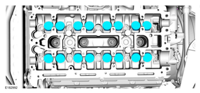

NOTE: If the valve tappets are to be reused, note the location of the valve tappets to make sure they are assembled in their original positions.
Remove the valve tappets.

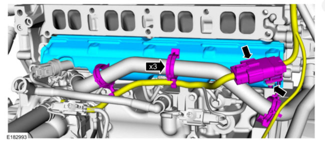

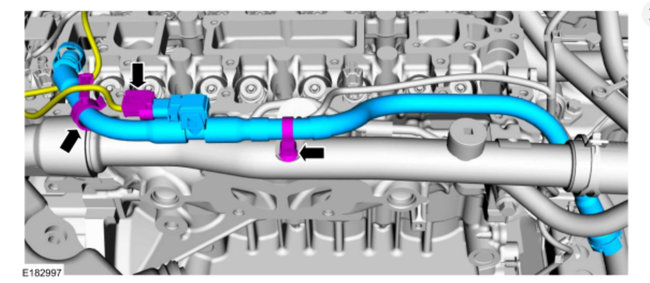

Detach and disconnect the fuel rail electrical connector.
Detach the wiring harness retainers.
Remove the fuel rail insulator shield.
Disconnect and position the coolant tube aside.

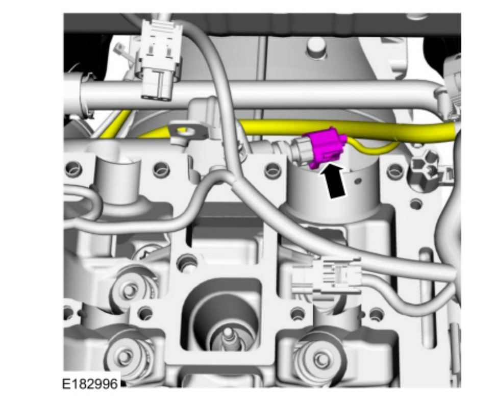

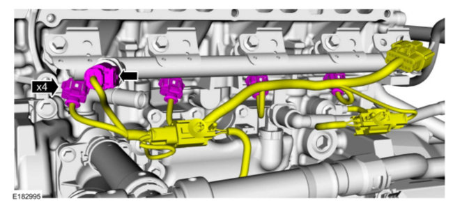

Disconnect the fuel injector and the FRP sensor electrical connectors.
Disconnect the ECT sensor electrical connector from the back of the engine.

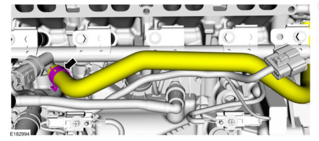

Disconnect the crankcase vent tube sensor electrical connector and wire harness retainer.
Detach the crankcase vent tube retainer and remove.

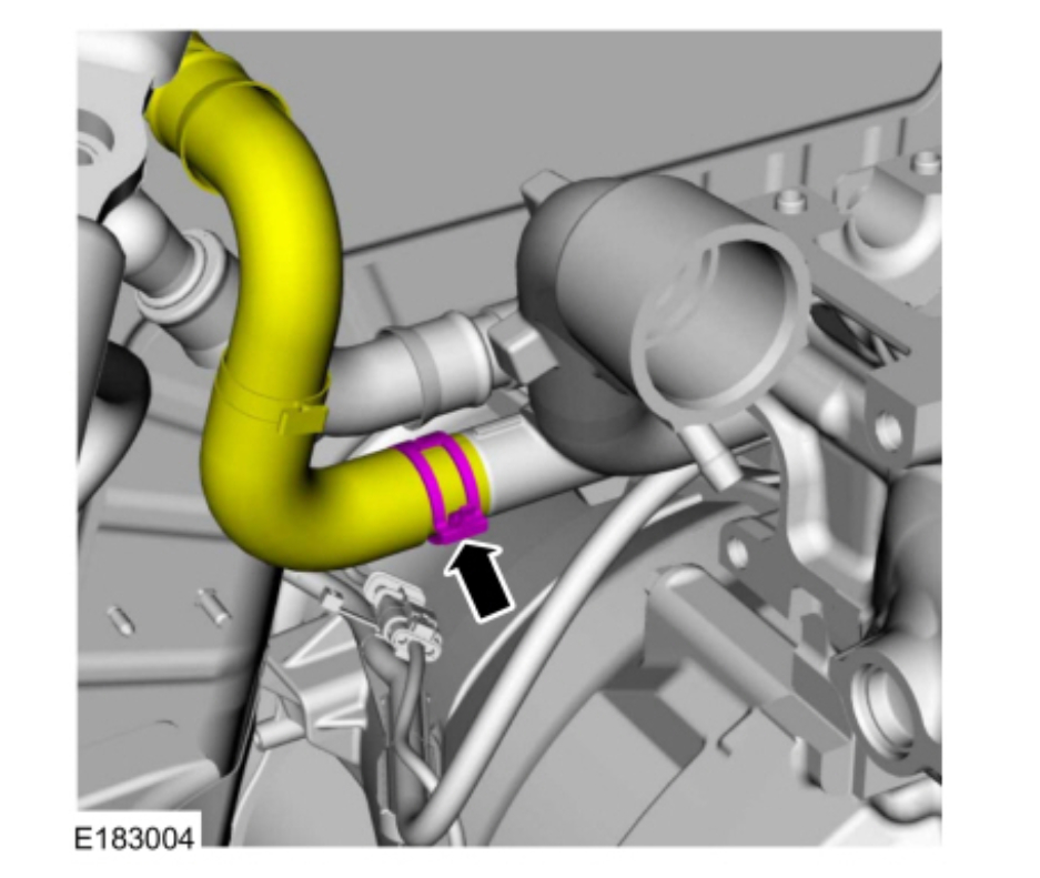

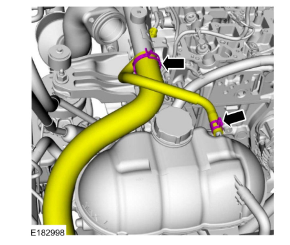

Disconnect the upper radiator hose from the coolant outlet tube.
Use the General Equipment: Hose Clamp Remover/Installer
Disconnect the coolant by-pass hose from the degas bottle.

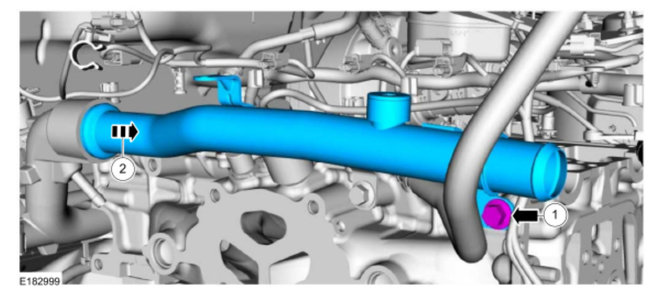

Remove the bolt from the cylinder head and remove the coolant tube from coolant outlet.
Remove and discard the coolant tube O-ring seal.

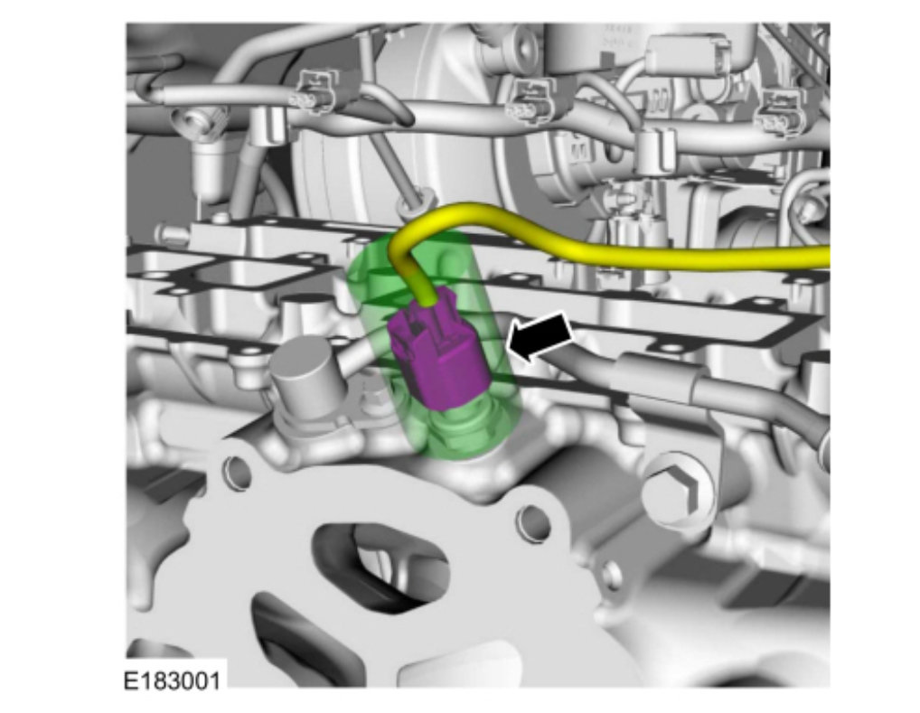

Slide the insulator up and disconnect the CHT sensor electrical connector.

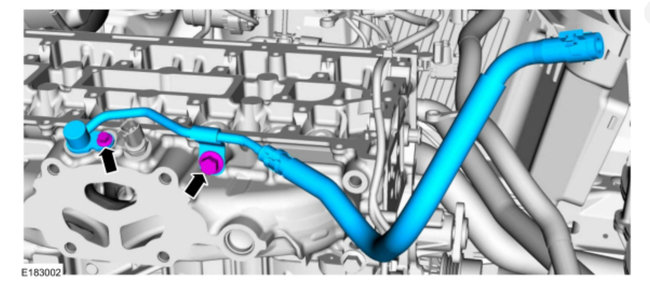

Remove the bolts and the coolant tube.

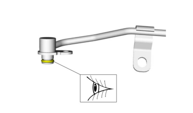

Inspect the coolant tube O-ring seal and replace if necessary.

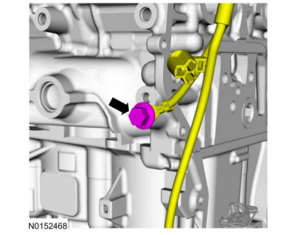

Remove the bolt and the ground wire.
ImageOpen In New TabZoom/Print

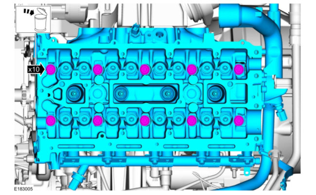

Remove the bolts and the cylinder head.
Discard the bolts.

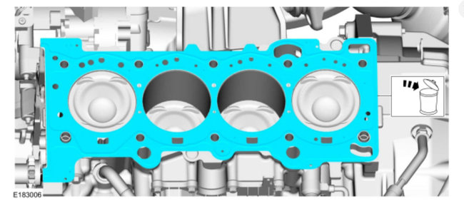

Remove and discard the cylinder head gasket.

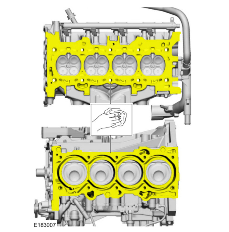

NOTICE: Do not use metal scrapers, wire brushes, power abrasive discs or other abrasive means to clean the sealing surfaces. These tools cause scratches and gouges that make leak paths. Use a plastic scraping tool to remove all traces of the head gasket.
NOTE: Clean the cylinder head bolt holes in the cylinder block. Make sure all coolant, oil or other foreign material is removed.
Make sure that the mating faces are clean and free of foreign material.
Check the cylinder head distortion.
Refer to: Cylinder Head Distortion (303-00 Engine System - General Information, General Procedures).
Check the cylinder block distortion.
Refer to: Cylinder Block Distortion (303-00 Engine System - General Information, General Procedures).

Install the cylinder head gasket.
NOTE: The cylinder head bolts are torque-to-yield and must not be reused. New cylinder head bolts must be installed.
Install the cylinder head and the new bolts.
Torque :
Stage 1: 62 lb. In (7 Nm)
Stage 2: 133 lb. In (15 Nm)
Stage 3: 41 lb. Ft (55 Nm)
Stage 4: 90°
Stage 5: 90°
