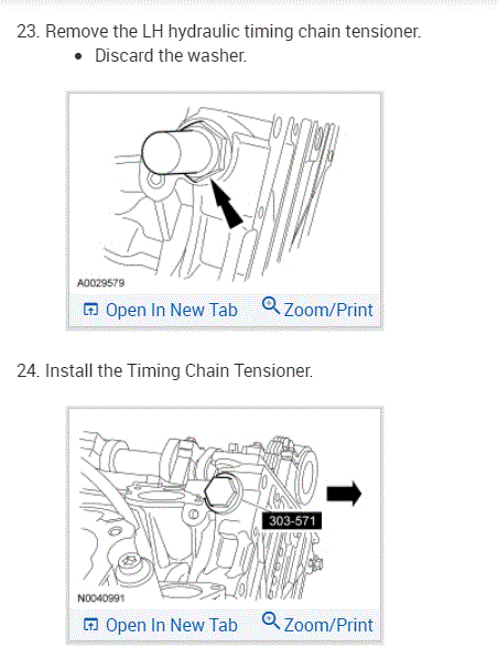

I had to replace the timing chain cassette and the camera rolled over on me. can I reset the time and just by rolling that can back into its original position?

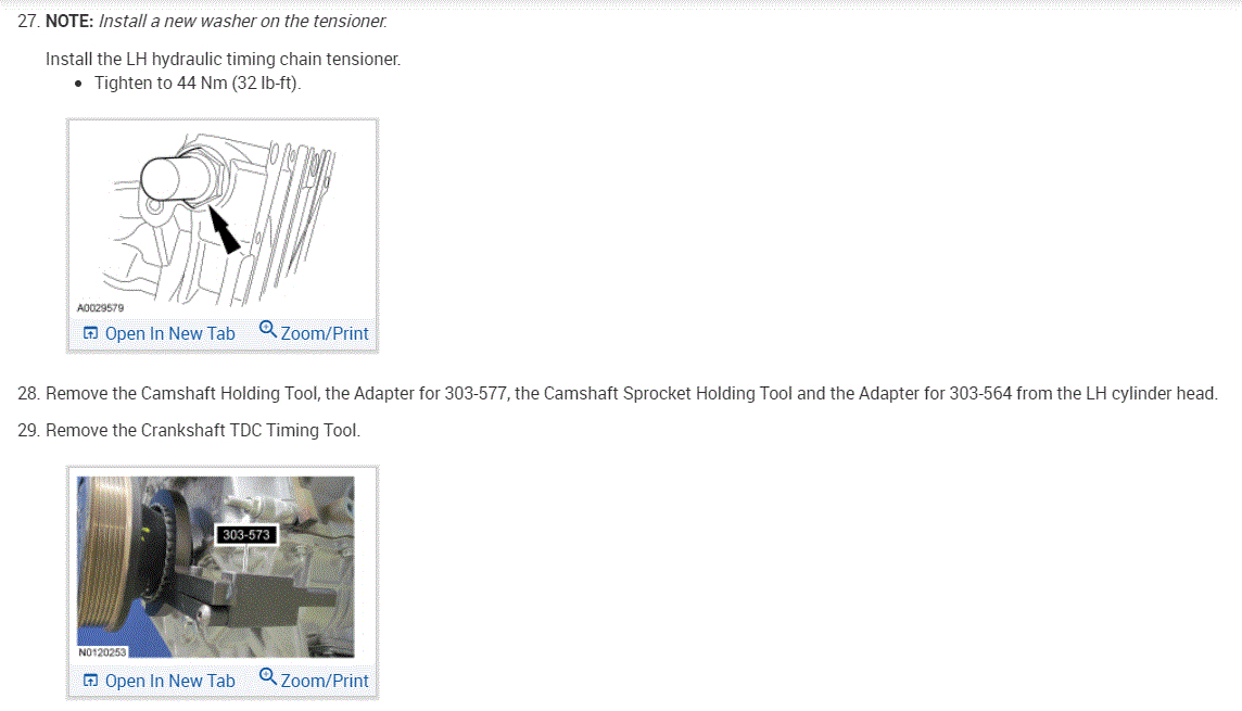

I'm sorry I was a little aggravated when I wrote the post. The plastic guide on the cassette shattered because the tensioner froze up. Anyway, my question is about how to time just the driver's side. The cam rolled over on me while I had the tensioner off. Now I should add I just placed a new plastic guide on the old cassette because it happened seconds after I started the vehicle, I immediately shut off and diagnosed what went wrong. the side of the valve cover cracked but I fished all the plastic out (I compared the remains with the new one, and like 98% of it was in my hand.). So, I was just kind of checking parts out and the cam snapped over. I didn't think it was an issue he cans I Still had the
chain on and assumed the whole system did the same. Well, now the timing is off, and I do not want to remove the
cover. I'm thinking I could just roll the crank to
TDC and loosen the cam bult and roll the left side to TDC and tighten it back up. But how do I determine if the crank is on
the compression stroke in #1 if there are no markings to go off of?
Sorry for the long post...
Apr 27, 2022 at 4:28 PM
  • 110,244 POSTS

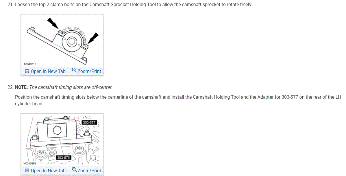

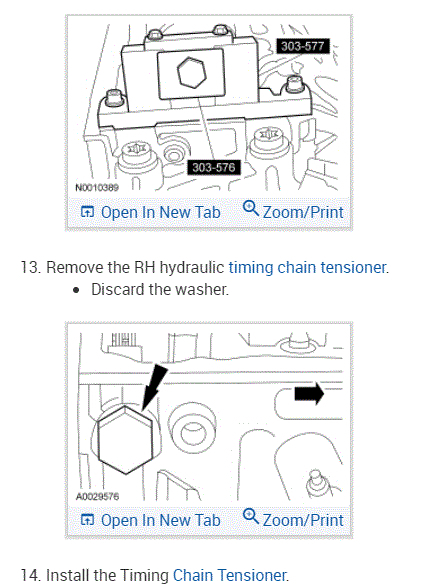

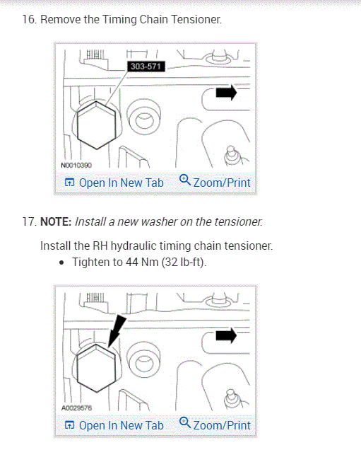

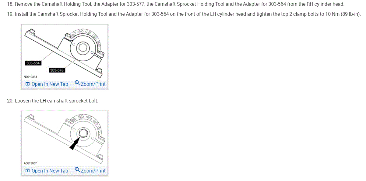

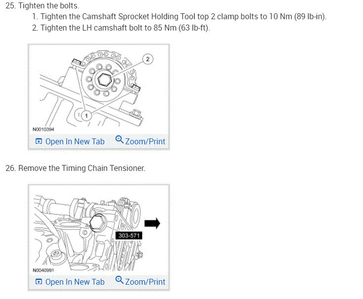

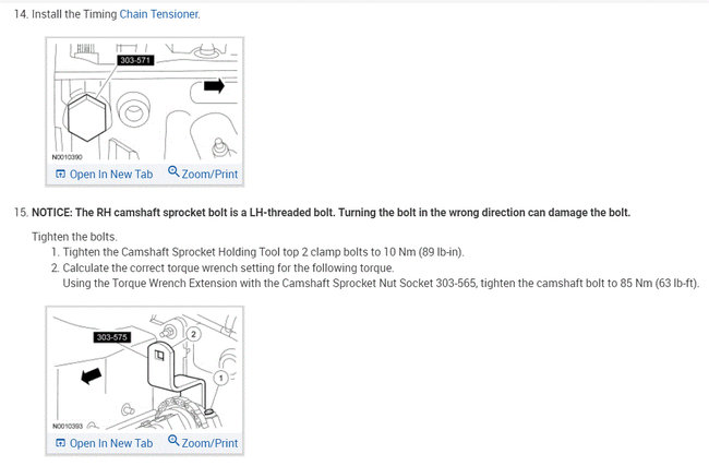

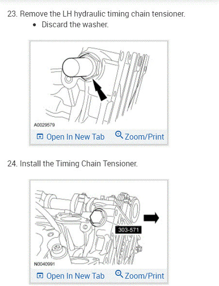

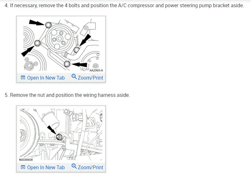

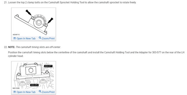

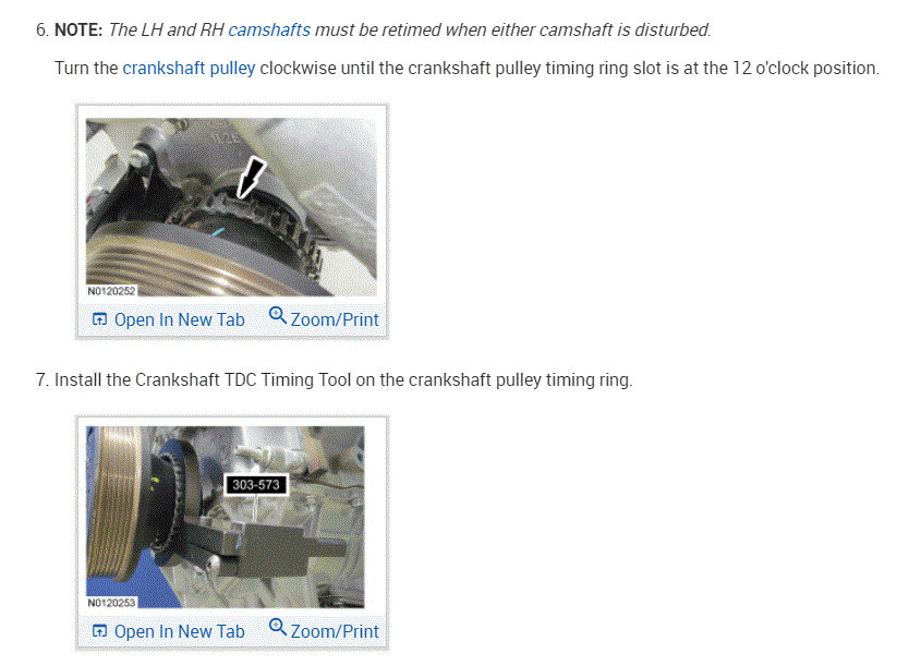

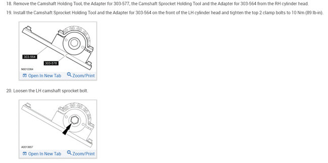

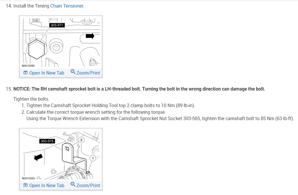

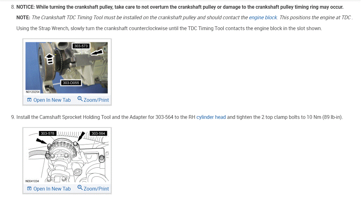

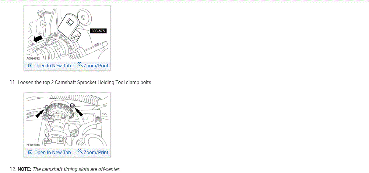

No problem whatsoever. If that happened to me, I would have been the same. Here's the thing. Anytime one or both of the camshafts is disturbed, both need to be retimed.

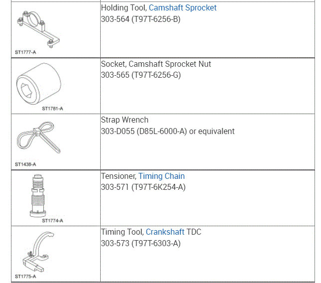

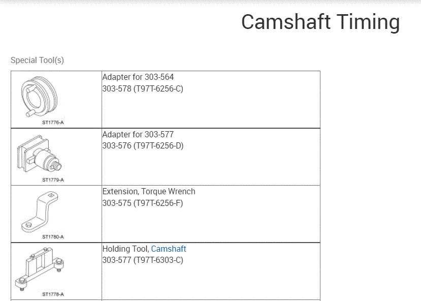

Also, as far as finding TDC, it requires a special tool (ford part number T97T-6303-A) that is attached to the crankshaft timing ring. There is only one way it can attach and then TDC is determined when the tool contacts a specific location on the engine block.

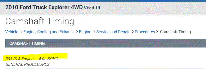

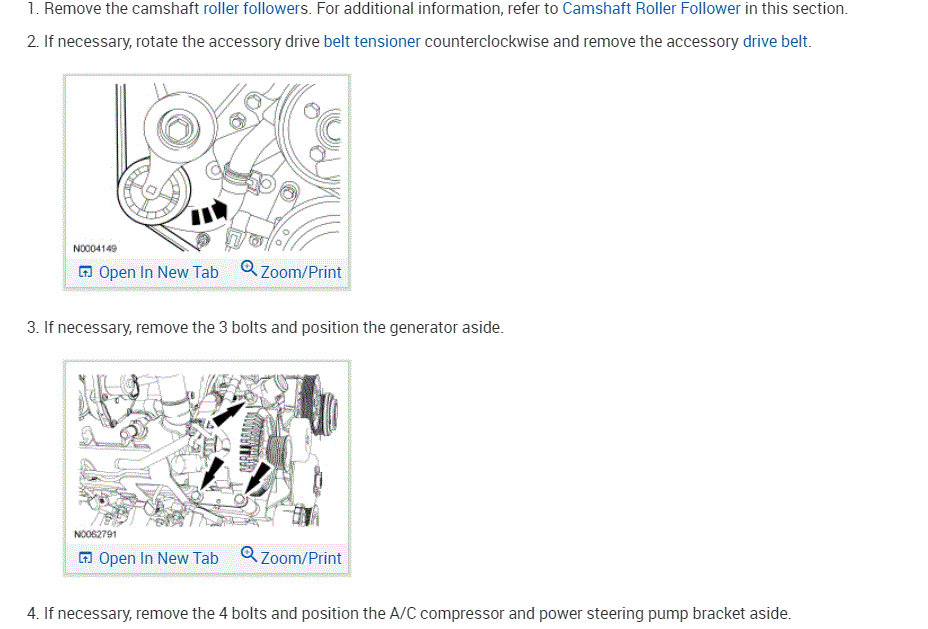

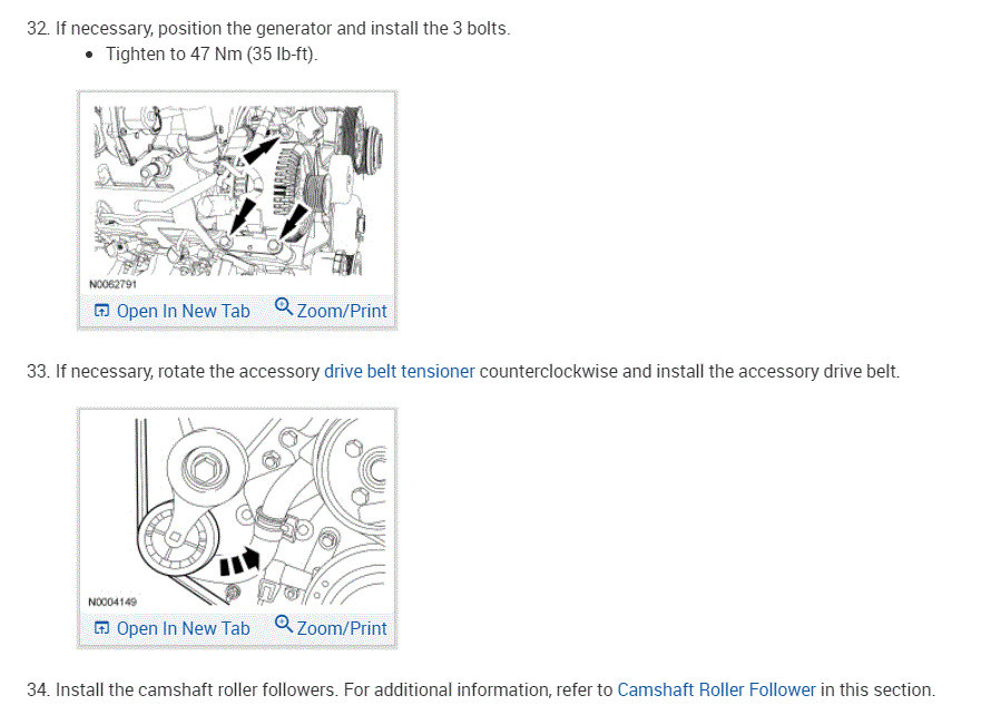

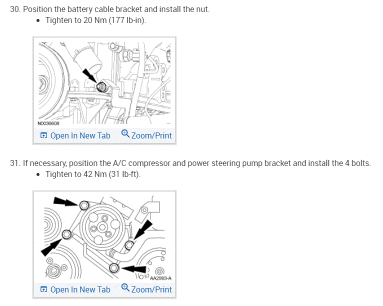

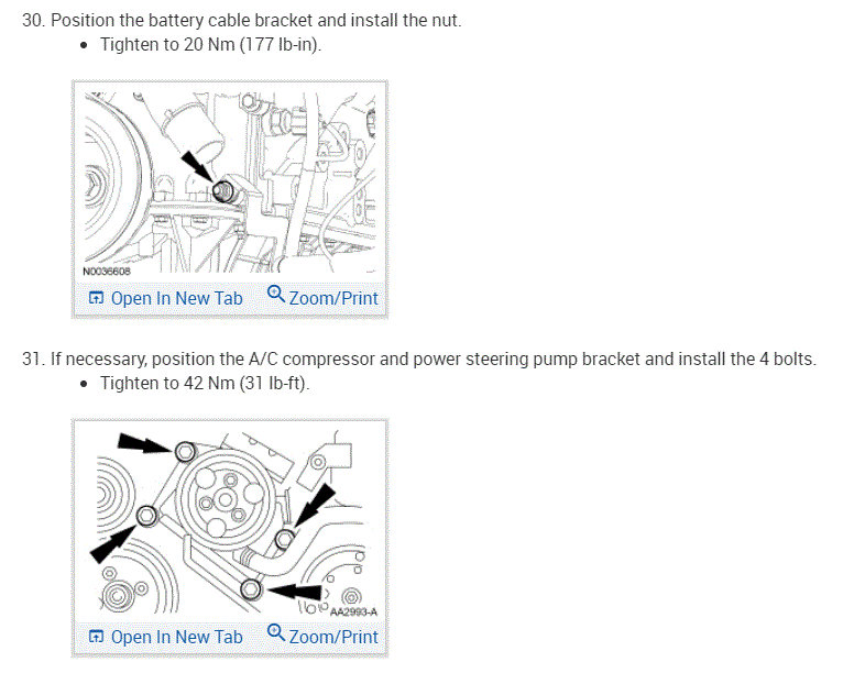

Take a look at the pics below. I added the procedures below specific to this engine. Take a look through them and let me know if you have questions.
Apr 28, 2022 at 10:54 AM
