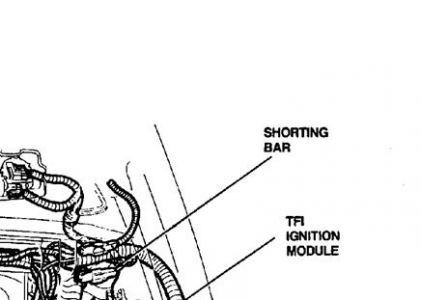

The motor is way out of timing. How do I fix this problem?

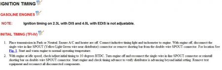

See pic & text for basic timing information.

Thank you very much. You were very helpful.

Just seen how small the text is, can you read it OK?

Yes, I was able to blow it up on my computer.
