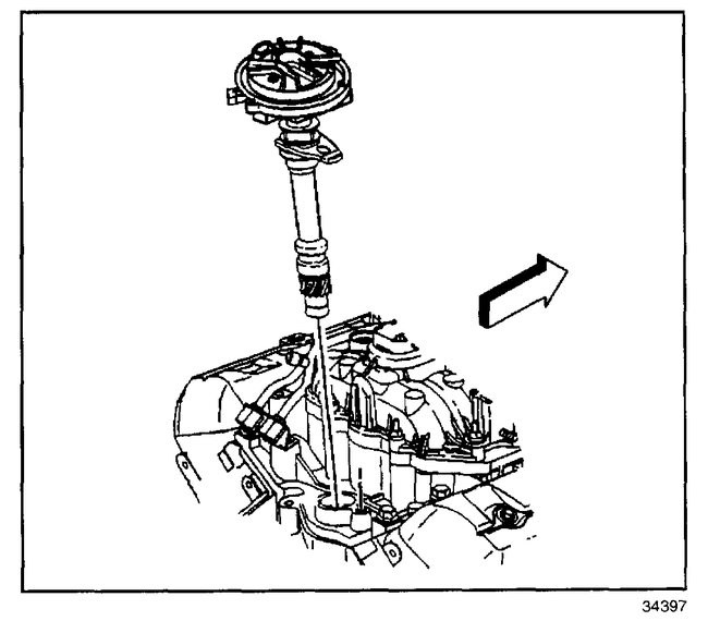

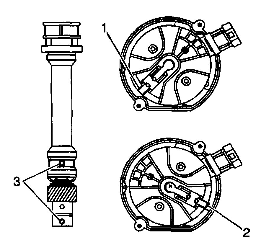

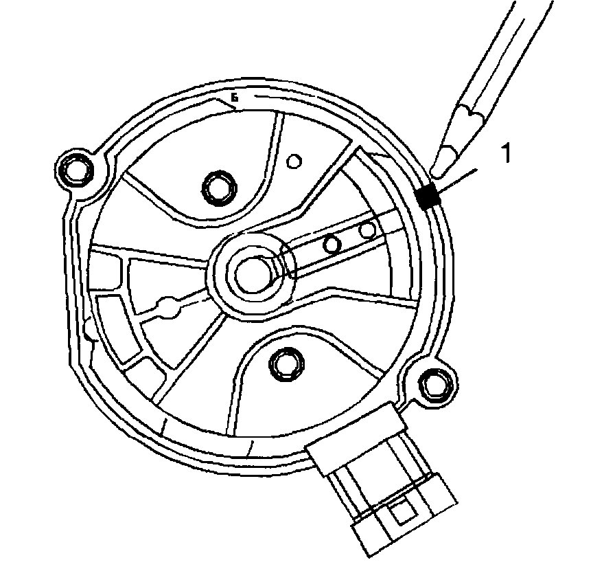

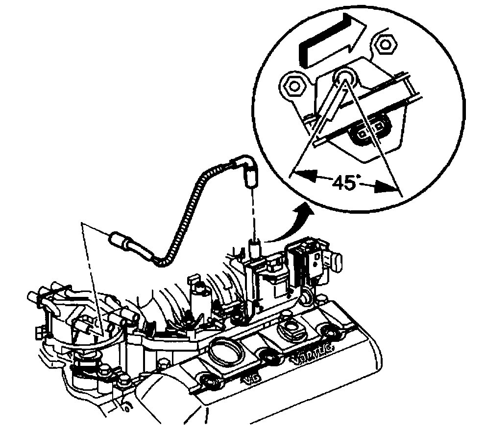

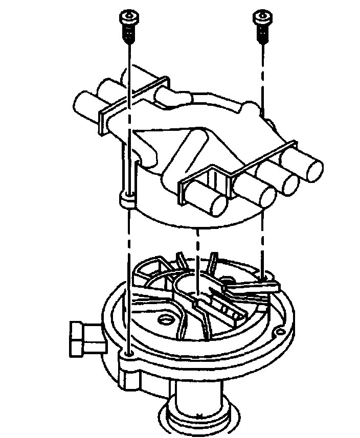

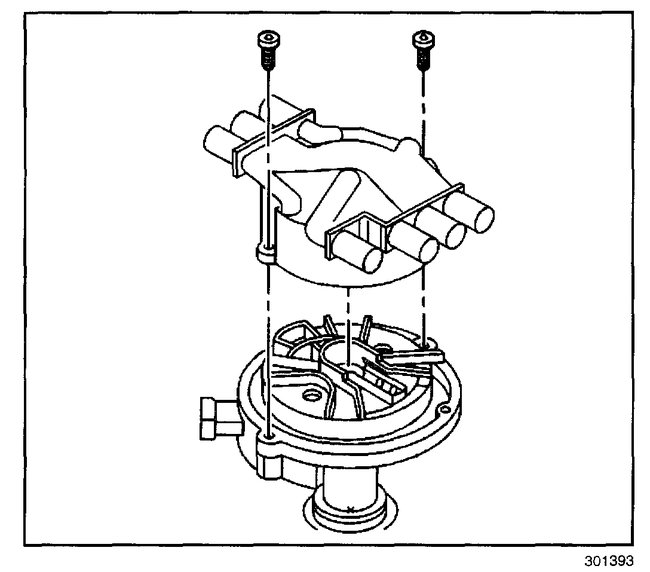

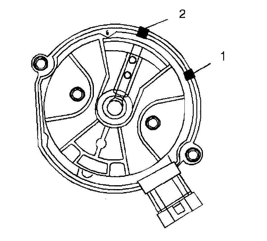

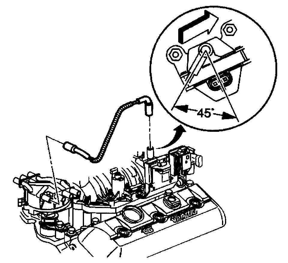

The rotor broke off the shaft and I replaced the rotor and cap, but a week later my truck shut off again and this time I replaced the whole distributor. Now do I have to set the timing or can I just pull the old one out and place the new/but used distributor down in? Or will I have to use a timing light and what not and set the timing or what? Also I hooked a code reader on it and it said ether the camshaft sensor or crankshaft sensor malfunction. I don't remember exactly what it said because a buddy of mine deleted the codes! Is there a way to get the codes back or does the engine have to be running, I have no knowledge about the electrical on vehicles, lol.

If you removed the distributor, it needs to be properly re-installed so ignition timing is correct. Otherwise, it won't run. It may backfire.

Here are the directions specific to your vehicle. The pics below correlate with the directions.
2002 Chevy Truck S10/T10 P/U 4WD V6-4.3L VIN W
Distributor Replacement
Vehicle Powertrain Management Ignition System Distributor Service and Repair Procedures Distributor Replacement

4. Remove the electrical connector from the base of the distributor.
pic 1

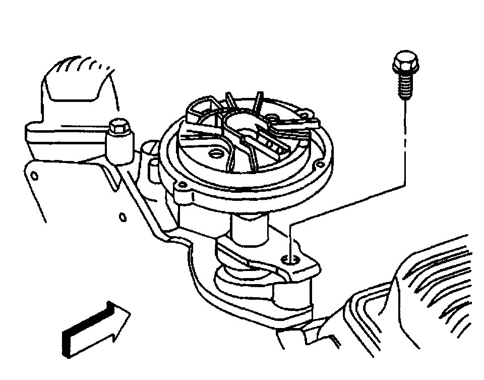

5. Remove the two screws that hold the distributor cap to the housing.
6. Discard the screws.
7. Remove the distributor cap from the housing.
pic 2

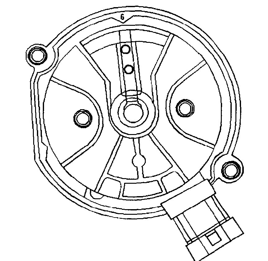

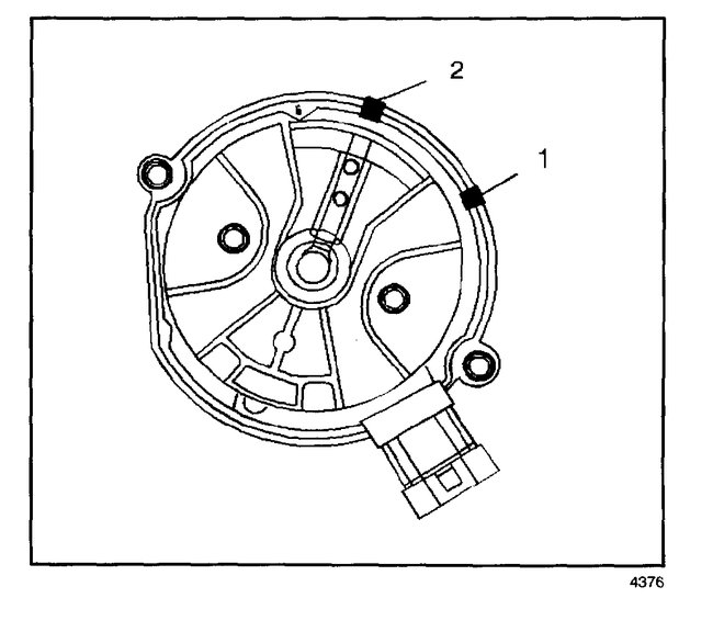

8. Use a grease pencil in order to note the position of the rotor in relation to the distributor housing (1).
9. Mark the distributor housing and the intake manifold with a grease pencil.
pic 3
10. Remove the mounting clamp hold down bolt.
11. Remove the distributor.
pic 4
12. As the distributor is being removed from the engine, watch the rotor move in a counter-clockwise direction about 42 degrees. This will appear as slightly more than 1 clock position.
13. Note the position of the rotor segment.
14. Place a second mark on the base of the distributor (2). This will aid in achieving proper rotor alignment during the distributor installation.

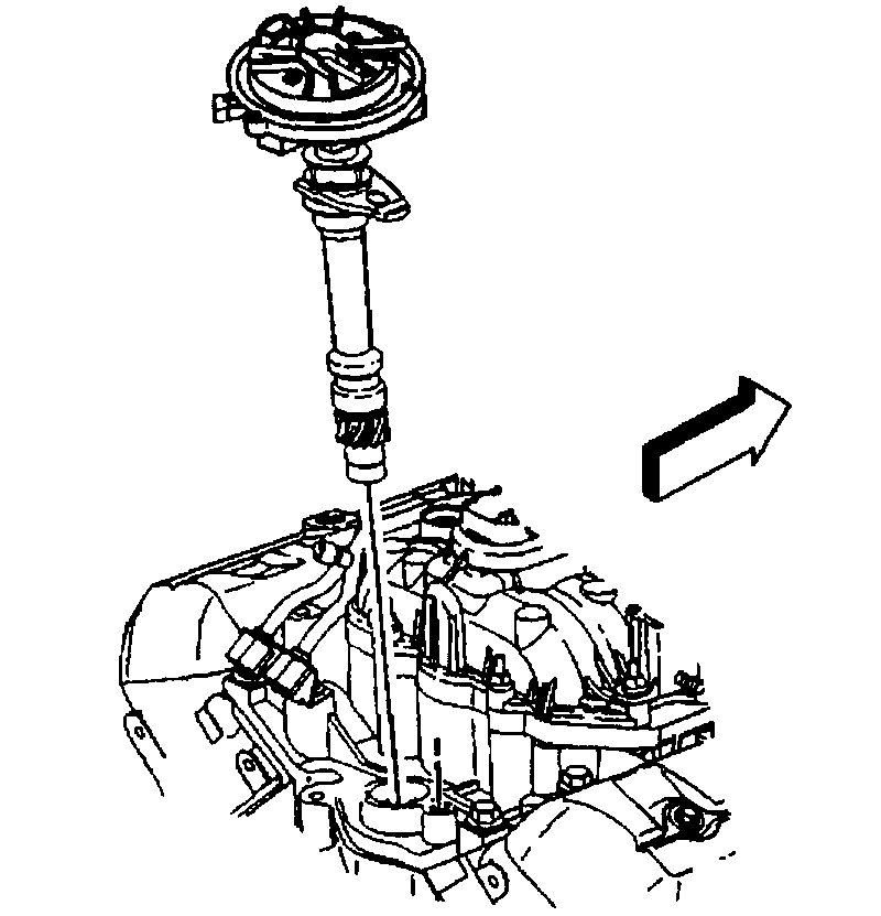

INSTALLATION PROCEDURE 1
pic 5
1. If installing a new distributor assembly, place 2 marks on the new distributor housing in the same location as the 2 marks on the original housing.
2. Remove the new distributor cap, if necessary.
3. Align the rotor with the second mark (2).

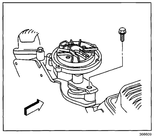

pic 6
4. Guide the distributor into the engine.
5. Align the hole in the distributor hold-down base over the mounting hole in the intake manifold.
pic 7
6. As the distributor is being installed, observe the rotor moving in a clockwise direction about 42 degrees.
7. Once the distributor is completely seated, the rotor segment should be aligned with the mark on the distributor base (1).
^ If the rotor segment is not aligned with the number 1 mark, the driven gear teeth and the camshaft have meshed one or more teeth out of alignment.
^ In order to correct this condition, remove the distributor and reinstall the distributor.

pic 10
13. Install the ignition coil wire.
Note the correct orientation of the wire boot.

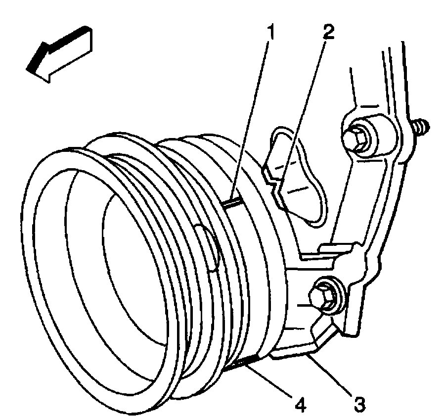

IMPORTANT: Rotate the number 1 cylinder to top dead center (TDC) of the compression stroke. The engine front cover has 2 alignment tabs and the crankshaft balancer has 2 alignment marks (spaced 90 degrees apart) which are used for positioning number 1 piston at top dead center (TDC). With the piston on the compression stroke and at top dead center, the crankshaft balancer alignment mark (1) must align with the engine front cover tab (2) and the crankshaft balancer alignment mark (4) must align with the engine front cover tab (3).
pic 11
1. Rotate the crankshaft balancer clockwise until the alignment marks on the crankshaft balancer are aligned with the tabs on the engine front cover and the number 1 piston is at top dead center of the compression stroke.

2. Align white paint mark on the bottom stem of the distributor, and the pre-drilled indent hole in the bottom of the gear (3).
NOTE: Refer to Distributor Driven Gear Can Be Installed in Multiple Positions Notice in Service Precautions.
3. With the gear in this position, the rotor segment should be positioned as shown for a V6 engine (1) or V8 engine (2).
^ The alignment will not be exact.
^ If the driven gear is installed incorrectly, the dimple will be approximately 180 degrees opposite of the rotor segment when the gear is installed in the distributor.
