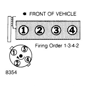

Thanks for the input. It will help, but I need to know if the distributor cap is supposed to be marked for the number one position.
Jan 30, 2010 at 12:34 AM
BLUELIGHTNIN6
  • 16,542 POSTS
Firing order is below:
https://images.2carpros.com/forum/automotive_pictures/261618_Graphic_302.jpg
Check out the diagram Please let us know if you need anything else to get the problem fixed. Cheers
