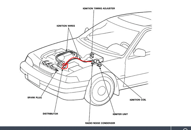

I have the car listed above that has the ignition taken out of it and I lost the keys to the door so I cannot locket. I need to know how I can take something that’s easily accessible out of that car to prevent it from being stolen?

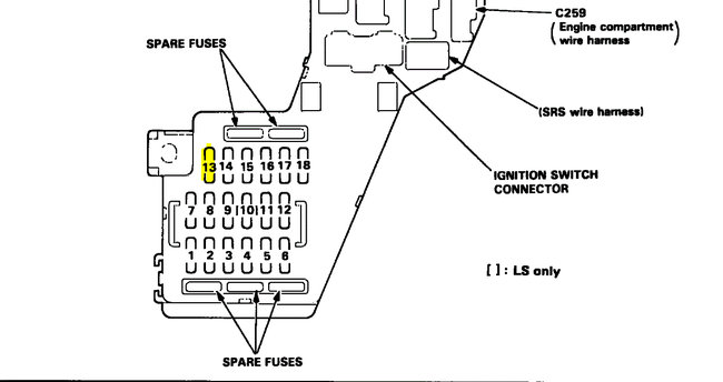

There really isn't anything easily accessible in the vehicle. You could pull the coil wire from the distributor under the hood (pic 1) and then plug it back in when you start it. But that's under the hood. You could pull fuse 13 in the fuse block that is for the starter. See pic 2.

Thank you so much for your time. since I can’t lock my doors and taking a fuse why couldn’t a person just take the fuse next to that one? So I’m wondering if the car has room fuses the big ones under the hood?would something like that disable it and the coil wire is pretty easy thing to fix or should I say figure out and does it matter as long as it the main coil?i am sorry for taking your time I appreciate that. lavae:):)

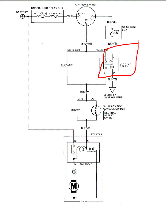

First, you are not taking my time. I'm glad to help. Okay, I see your concern as far as switching fuses. The only other thing I can suggest is if you wanted to pull the starter relay under the hood. See pic 1. If that is removed, the starter will not engage to start the vehicle.
If you remove the coil wire, unless someone has one with them, they really aren't going to get it to start.
