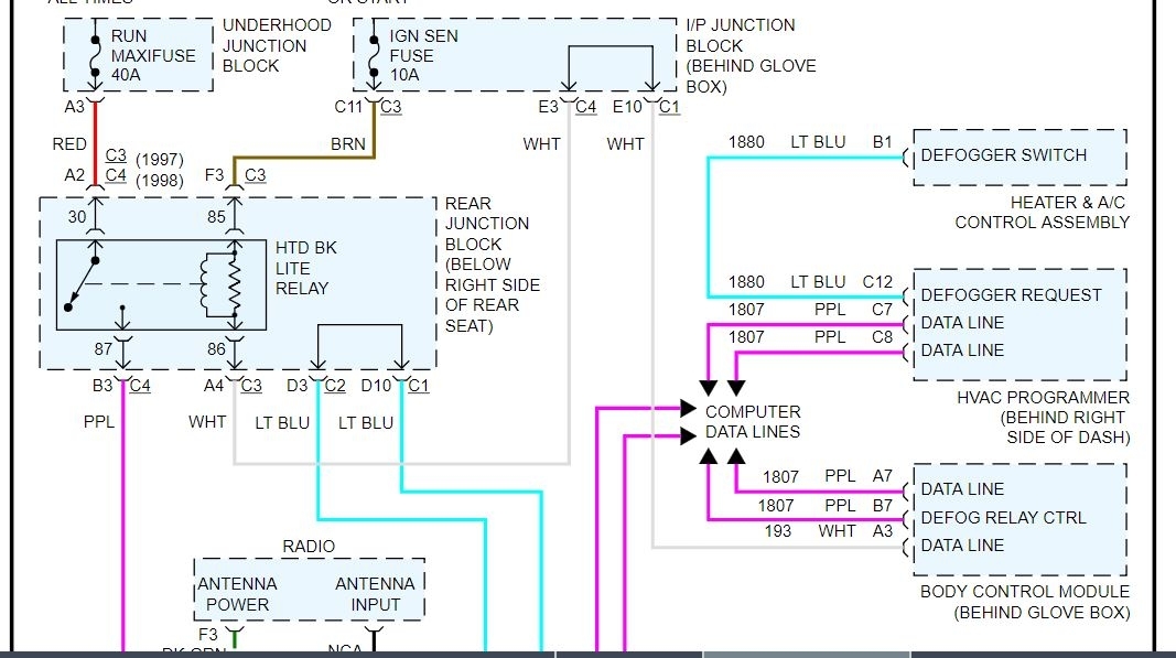

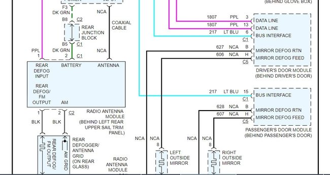

i'm wondering if i can bypass the antenna module and directly wire rear defrost? i don't have a lot of cash right now and frankly i listen to the radio rarely. Thanks, Don
Jan 10, 2019 at 9:37 PM
Good morning,
No, that would be a bad idea. The rear defogger is on a timed circuit. the antennae is a constant circuit. This means you can overheat the rear window and run the risk of fracturing the glass from too much heat.
Did you check the fuse for the rear defogger?
Make sure the fuses to the HVAC system in the fuse panel have power on both sides with the key on. The control head for the AC module controls the activation of the rear defroster and also controls the time based on ambient temperature.
The heater and A/C programmer receives the rear defogger request from the heater and A/C control assembly. The heater and A/C programmer will then send a Class 2 message to the body control module (SBM). The SBM will control the rear defogger on/off status and the amount of time that the rear defogger is on. The SBM will communicate the rear defogger status to the heater and A/C programmer over the Class 2 serial data and the heater and A/C programmer will light the rear defogger indicator accordingly.

in my book/manual it says the fuse under the dash that controls the defog relay is the one marked IGN SEN. pulled and it looks fine. is there another fuse under the dash i need to look at?
Jan 17, 2019 at 11:30 AM
I attached the diagram for you to view. Check the 40 amp fuse.
Jan 17, 2019 at 11:40 AM

I also looked at every other fuse that was marked for HVAC, all look okay. next under the rear seat and that relay?
Jan 17, 2019 at 12:02 PM
DCKELLEY
  • 125 POSTS
And the 40 amp under the hood.
Jan 17, 2019 at 12:03 PM
Yep, test for power on both sides with either a test light or voltmeter.
