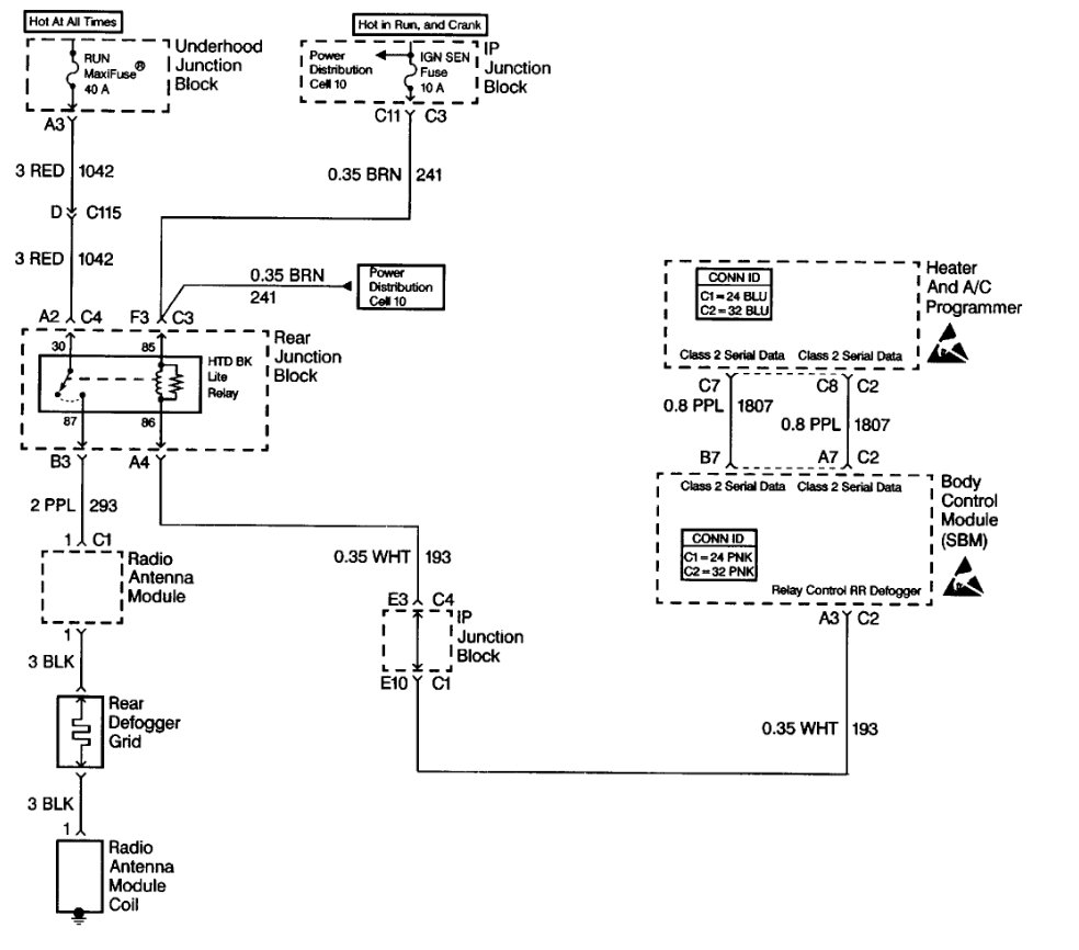

Rear defogger does not work, fuse is not blown
1998 BUICK PARK AVENUE
SGRTSMILEY
What else could it be?

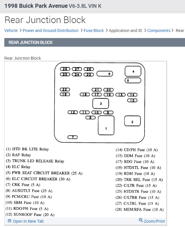

There is a relay for the rear defogger located under the rear seat. Check that relay and make sure it is in working order. Look for any corrosion or burnt pin.
Here is a guide on how to test relays:
If the relay is good, you will need to check to see if there is power to the harness for the defogger. Verify that the power is going to the relay and out of the relay. If there is no power to the harness then the issue is likely a shorted wire.
I have attached the wiring schematics for the rear defogger below.
