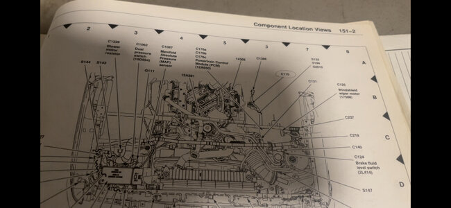

Super Duty Senior Bus. Has many running (marker lamps). Recently they all went dim. The pull switch has been tested using the book for continuity and the connector for the headlight switch was jumpered to test the running lamp circuit.
At a rear bulb socket, a meter shows 5 volts.
A 20' test wire lead was run from the battery, terminal to a marker lamp area to use as a ground to test for voltage at the connector which is 5 volts
That same test lead was connected to the + terminal of the battery to inject 12 volts into the + pin of the marker light harness. all the marker lights lit up brightly. except for the 2 in front (stock). those seem to come on with the switch and others all together. (5v, crap)
the b2 terminal of the wire harness for the headlight pull switch is what connects to R pin and a brown wire. an always hot pin. maybe this side of the circuit collapses under load?
maybe the problem is in the wire loom of this brown wire as it leaves the headlight switch harness and goes up under the steering column?
Maybe the problem is out under the hood with a connection somewhere?
I can perhaps take part of the dash apart and hand over hand this wire?

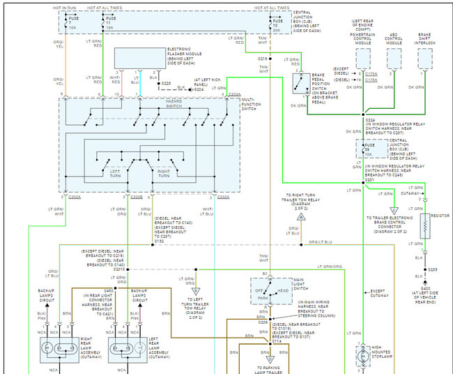

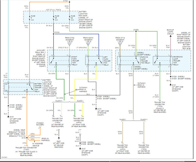

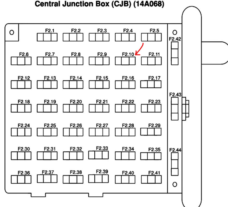

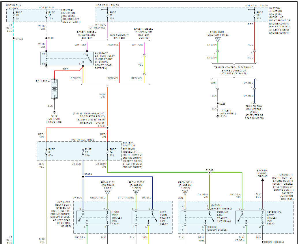

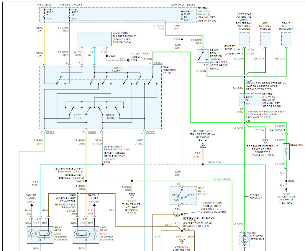

Let's check for 12 volts at the fuse panel, fuse # f2.10 in the central fuse panel behind the left side of the dash which should be hot at all times. Here is a guide to help and the fuse locations as well. Also, here is the running light wiring diagrams so you can see how the system works.
This guide may help as well:
https://www.2carpros.com/articles/no-tail-lights-exterior-running-lights-tail-lights-out
If you have 12 volts at the fuse let's, check the tan/wht wire at the rear of the headlight switch. Check out the images (below). Please let us know what happens.

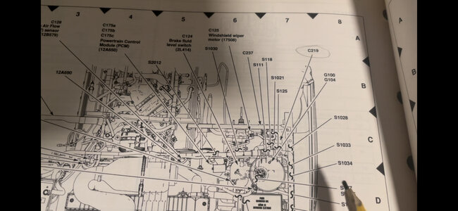

connector 219 is accurate and has 12v + with knob pulled. 0 when the switch is off.
connector 110 does not have a brown wire.
The 2 front marker lights have 12v when knob is pulled but all the roof ones have 5v.

Yep, you are losing voltage somewhere to the top lights. I would just run a new wire from the light switch to the running lights that are dim. Since the headlight switch is getting 12 volts the problem must be after that.

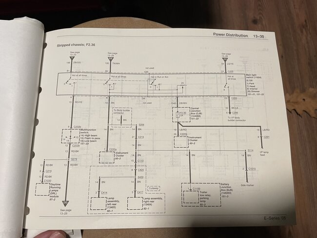

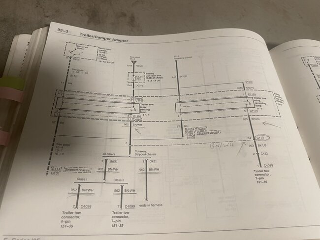

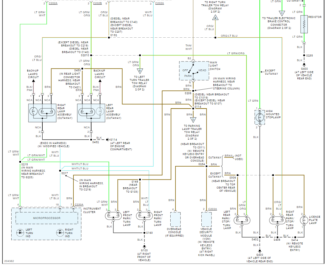

anyhow this brown wire at the connector in the corner under the vehicle becomes a brown wire with a white stripe, its cable assembly goes all the way along the frame rail to the front of the vehicle where it goes into connector 110. pin 7. bn/wh, ckt 962
this is on the list of pins for that connector and i can now see that the other end of that connector which comes from the engine compartment is an unknown color or origin at this point till i can dig more tomorrow, but i will say it looks like according to the diagram this is not a direct brown wire junction, it is coming from one of the tow parking lamp relays in the fusebox.
this would explain why when energizing the roof and taillights with 12v directly they all came on but the front stock parking lights near the grille did not. this is because they are not fed off the main brown wire ckt 14. that wire powers the front parking lights and it also powers the instrument cluster for something and it ALSO powers a relay. this relay when energized powers the bn/wh wire for connector 110 and goes all the way back to the corner for all that stuff.

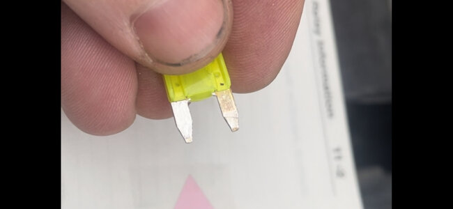

I'll need to get one of those fuse holders that has the contact extensions for troubleshooting. But being that this issue is not currently acting up and could be called intermittent i cannot look for 5v at one point and 12v at another like i thought it may boil down to between this fuse, relay, and connector 110 underneath the vehicle.

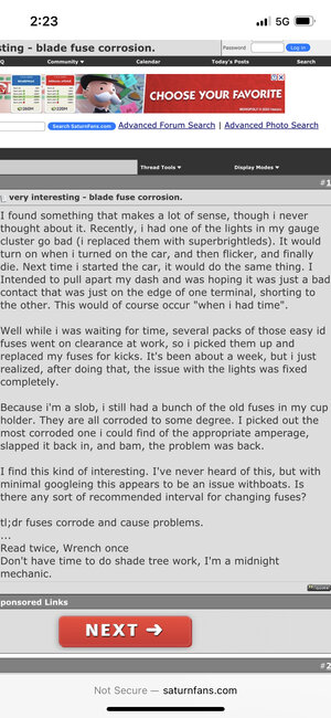

i did identify what pins are what and something i noticed is that the blades on the fuse are corroded more than what would be satisfactory or normal with electrical connections. if this was acting like a resistor then it would make sense that it'll drop voltage to that entire set of branches when loaded up.
taking a very close look at this fuse on both sides and then comparing a before and after giving it some tlc with a hand file gently i applied some ChapStick to the blades and stuck it back in. The relay itself clicks when the knob is pulled. there could always still be worn contacts inside the relay or a weak mechanical connection somehow or still corrosion in the connector or one of the pins for the wires underneath the fuse box but i am going to say for now this has been knocked out, will keep an eye on it and right now call it good.
i have read some other people have had problems with fuses as well. and there is also a difference between cheap fuses and buss brand name ones. weberauto gets into it pretty Indepth on YouTube.
this could have been glossed over if i was just casually checking that the fuse is there and didnt actually look at it closeup. and one thing for sure is that in these schematics for the book the answer i may be looking for is only on one particular page. it'll get referenced from another page or by the sounds of it a "trailer tow relay" is not something that sounds relevant, just an add on,turns out, that's the circuit.

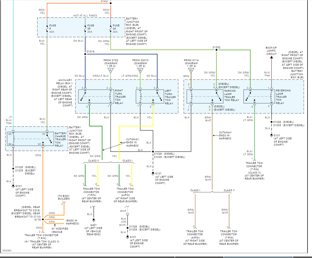

Sorry for the delay, please follow the wiring diagrams above and see where you lose voltage and fix it, it is a simple 12-volt circuit. Do you have 12 volts on the outlet lug of the switch (brown wire)?
Jan 7, 2024 at 10:08 AM
ZAWARTKAY
  • 24 POSTS
What? I already said my instrument cluster and 2 front running lights are powered by the brown wire from the pull switch and that same brown wire energizes a relay which energizes a brown and white wire which is the hot leg for all my rooftop and taillights etc. i will be focusing my efforts on that as well as the relay, and it turns out i have enough connectors, wires, terminals, and switches to make a test harness for the relay and perhaps bypass the relay with a jumper and see if anything changes.
