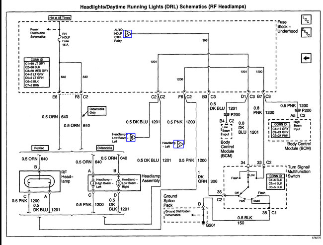

Dim headlamp on drivers side only.

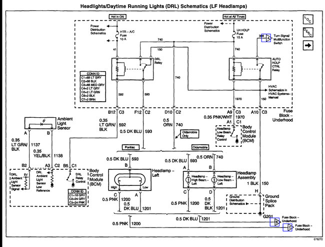

Check the ground for the light and test the bulb as well. A bad ground will make the light try to ground out through the opposite filament.

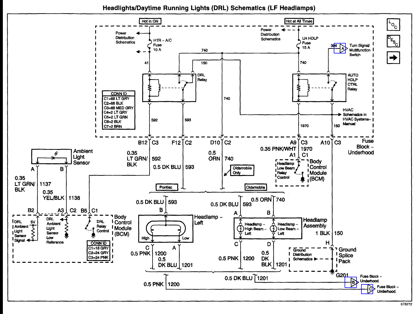

Where is the location of the ground for the left side headlight ?
Nov 24, 2017 at 1:07 PM
STEVE W.
  • 15,348 POSTS
It is grounded through the DRL system. Here are the diagrams. I would check right at the light first.
