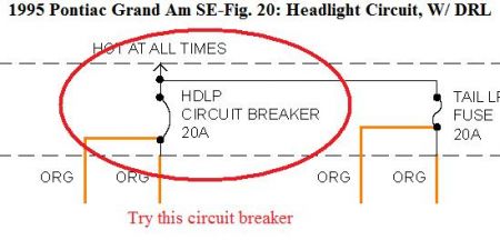

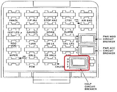

The headlights have gone out completely on the car. Could you tell me what fuse I need to use for it and in what slot in the fuse area do I need to put it.
Thank you,
Rachel
May 6, 2009 at 12:51 PM
ZACKMAN
  • 4,202 POSTS
It is a circuit breaker, not fuse.

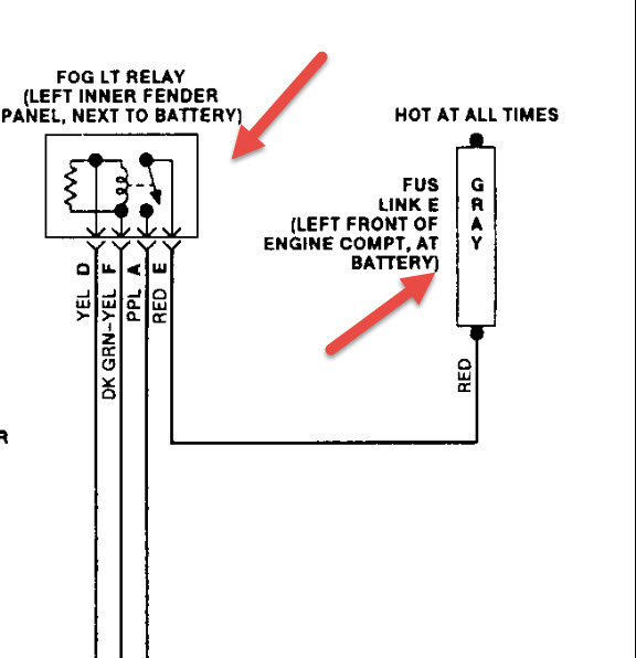

ROCKLAIR
no headlights or tail lights no power to head lamp circuit breaker, no power to switch.
Nov 12, 2019 at 10:17 AM (Merged)
HMAC300
  • 48,601 POSTS
Check the two items in the picture.
JDL
  • 16,098 POSTS
As far as the headlamp circuit breaker, it gets voltage from the fusible link. The fusible links appears to get voltage from starter solenoid battery terminal. Follow the circuit from solenoid battery terminal and check voltage. Of course the battery cable at solenoid has to have voltage. One way to check fusible link, check for voltage on both sides of link, if voltage on one side of fusible link and not the other, the fusible link is faulty.
